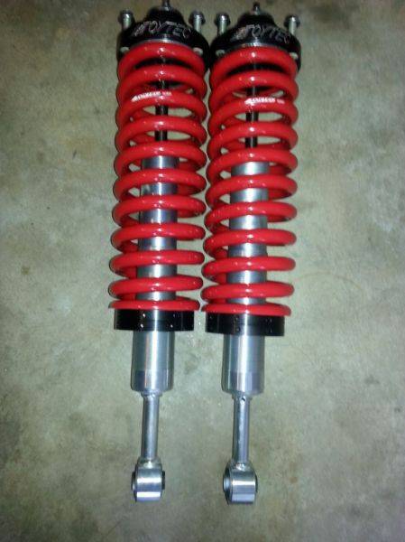

    OK so as to be expected when I reached out to Toytec today their customer service is top notch. I brought them both of my coilovers because I wanted them to inspect the passenger side as well. They had not seen anything like how I broke the drivers side... to date. As we talked it through some it turns out I am the only one on record running 700lb Eibach springs with the BOSS shocks on a 2nd gen Tacoma. So to remove that variable from the equation we all agreed to reset up my Coilovers with the standard 600lb. springs.
    At the end of the day I now have these installed;
    New springs and new shocks both sides. Also learned some cool things about their Coilovers today. They design all of their Coilovers around the Eibach 16" spring which is different then most Coilover manufacturer's when applying them to OEM uppers and lowers. Their rubber bushing in the bottom IS the Bilstein bushing. So as far as rubber bushing go it solid quality. The BOSS shock has been impressive so far to me so I definitely didn't want to give up on them due to this "fluke".
    Toytec plans to send my shocks back to their manufacturer for review(Eibach makes the shock. Design is all Toytec). Hopefully this will be the answer. The 600lb springs do ride much better but we will see how long they hold up.

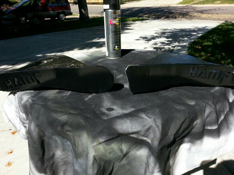

    BAMF LCA Skids clearanced for Pelyfreybilt for coverage front skid. y3yhamu3_2788cc7bfea5d21cf28f8f8777de01919c3d097a.jpg

    NICE!!! What color you gonna do the letters? Orange?

    These are laser cut all the way through. There isn't a plate welded on theis version.

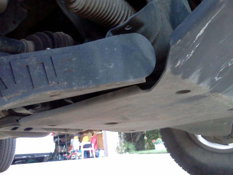

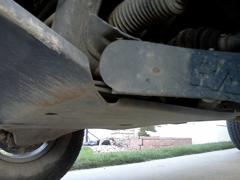

    I'm curious now as to whats changed....
    Are your lca skids different? Is the ifs skid different? Or both?
    Here are some pics of mine
