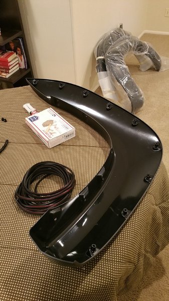

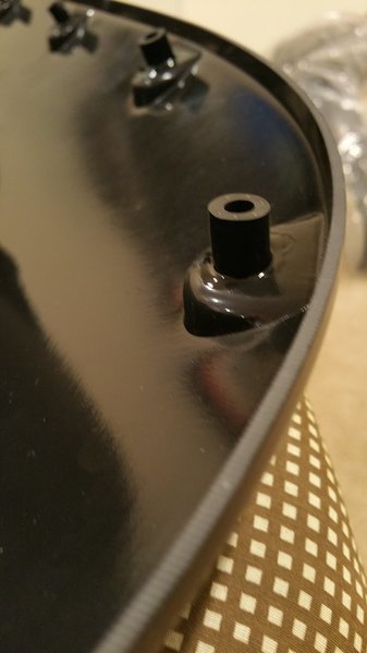

    So begins the slow process of custom installing modified Bushwacker fender flares. I have source longer stainless bolts and I am using rubber fuel hose as a spacer behind the flares. The pocket bolts will be the install point on each fender since I have to trim off the bottom to accommodate the 315's.
    So I am using JB WELD epoxy on each spacer and gonna let dry for a few days.
    Next will be to cut off the bottoms and trim out with some special fender trim I have. Test fit, drill holes, prime holes, and install.

    why do they need the spacers? are they not made correctly?

    When installed on a stock truck they use the mounting bolts on the bottom inside the wheel well. The pocket bolts are completely for show normally and do NOT mount to anything. Since I have trimmed my sheet metal up to accommodate 315's those bottom bolts no longer exist. So I am turning the "show holes" into the actual mounting bolts. If I don't put the spacer in, the plastic fender could kink or bubble as I tighten the bolt down to secure to the fender.

    Subbed, I picked up a set not long ago and still need to get mine all cut up. Good thinking on the fuel hose as a spacer, how did you measure to check how big each spacer had to be? Or did you plan on them compressing a little

    I actually started with solid nylon spacers. The depth needed changes a bit as you go down the flare. I quickly realized I needed a rubber spacer of some sort to be able to compress the depth for the variations in contour. Plus they will be easy to trim if one is too long still.
