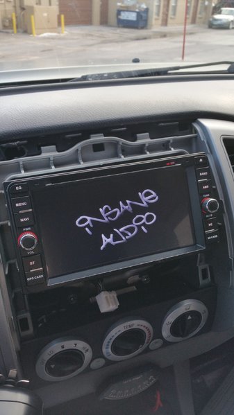

    So doing some R&D with @ToyTec Lifts and @Insane Audio. A few more things to sort out but Toytec should have the bad ass Insane Audio head unit available for 2nd Gen Tacomas soon!

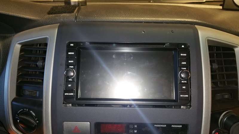

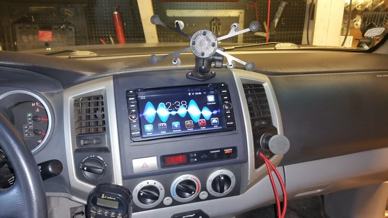

    Ok. So got it all wrapped up today. Had to find a power source for the camera in back and then work on trimming the bezel to fit. So it's a bit more work the I thought to get it right. I had to trim 1/8" off both sides then using the aftermarket mounts from my previous double din I had to angle the radio up about 3°. This resulted in good side fit but a gap at the bottom. Like so:
    So I found some leftover trim from my Bushwacker fender flares and made it acceptable.

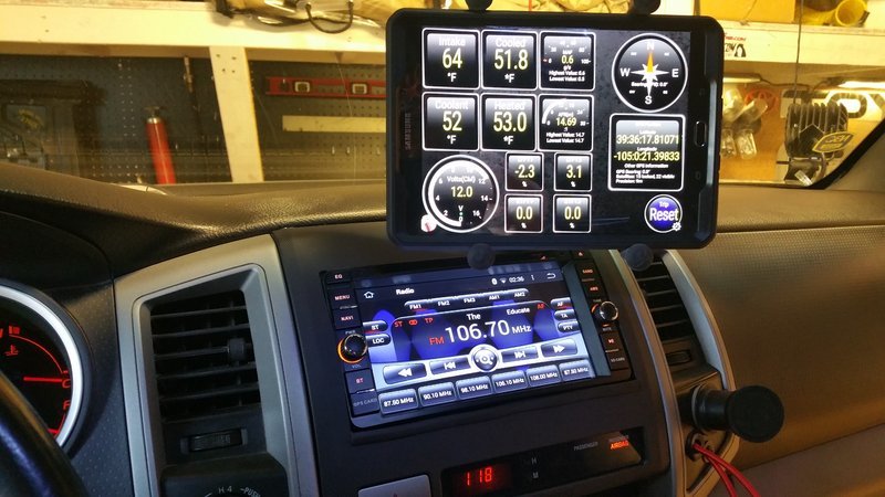

    I still plan to run my tablet for HEMA Maps and the Torque App.
    The radio is pretty bad ass. Runs on Android KitKat. I can download most of my Google play store apps to it. It comes with Torque on it ( I will not be using it) and includes three OBD dangle to Bluetooth to it. Hands free calling, DVD player, and one of the most detailed GPS systems I have ever seen. Blue tooth music, iPod cable, UBS connection and a micro SD slot for music along with one for the GPS that can be expanded based on the maps you download. Sound quality is great with the factory JBL.
    And last but not least I did confirm with the help of @PS78 I confirmed that the harness supplied for the JBL model does plug n play with the 2nd Gen harness. So now all that is left is to work with Insane Audio to see if there is a better bezel that can be included in the kit.
