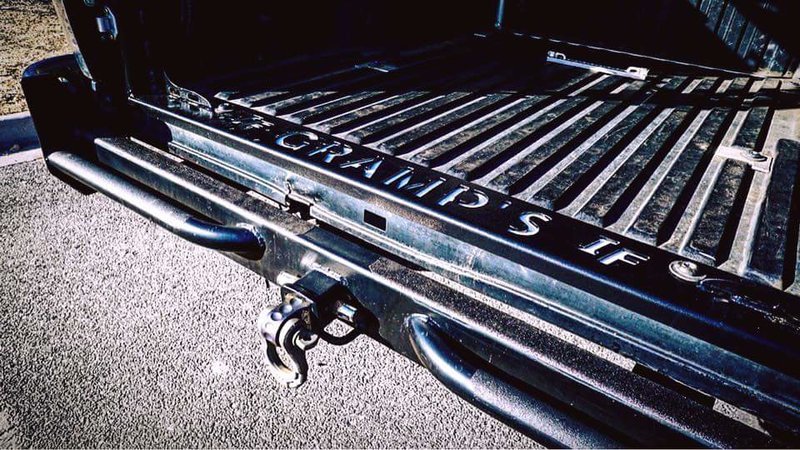

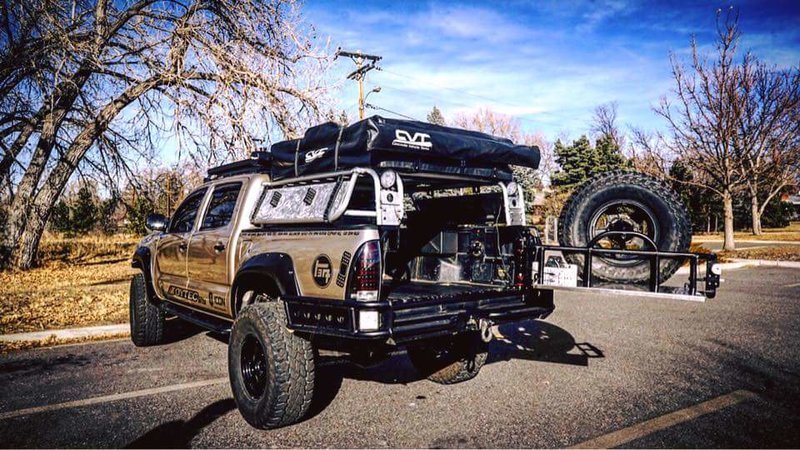

    Does the gate lock into place when opened? I'm stopping by InSain tomorrow to see if I can get a similar setup.

    Yeah it has a lock out built into the system to hold it open.

    The quality really shows its self in person. InSain fab did an excellent job. Very well though out design.

    Yeah a lot of effort went into making it strong. It also squared up the bed. Pretty cool set up.

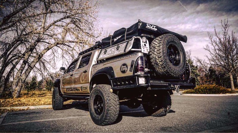

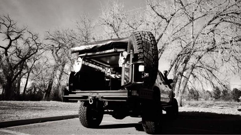

    I knew I had the infamous bedside spreading going on. My speculation is that it was from a previous rack I ran that sat only on the bedsides. With what the InSain Fab crew built for me in this tire gate it completely squared my bed back up. What was interesting to learn was that not only were the bed sides flared out out the middle of the bed itself was bowed up. When they first laid the bottom section of steel across the bed you could see it. Once they welded everything together and bolted the sides/bottom in the bow in the bed went away.
    It makes sense since the sides were bowing out but I never really noticed it visually. It's an awesome design and the back of the truck feels that much more stout now.
