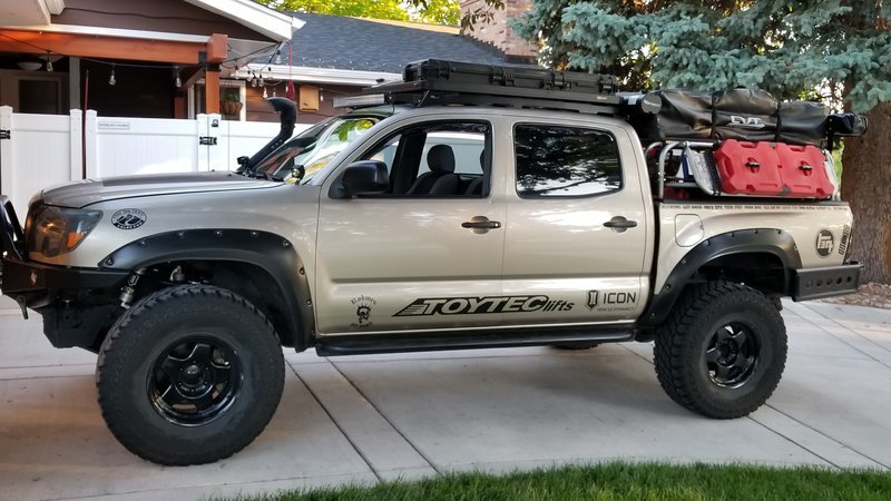

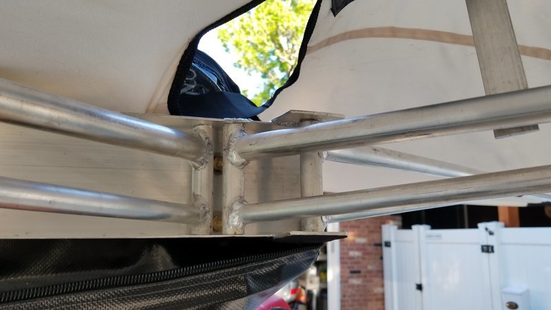

    So here you go. Got it installed. I will say this is some very basic fabrication. Not polished, not refined, and won't earn you any purty #EAF points. But they got function right and I think this awning is gonna be pretty sweet. Time will tell with some real world testing.
    And now for the reveal:

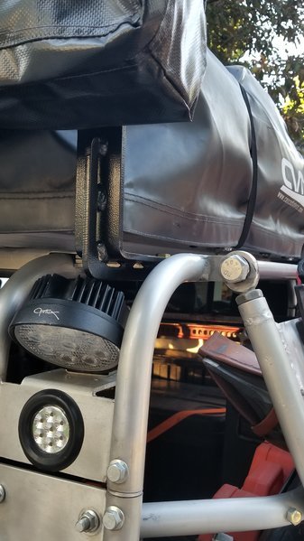

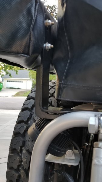

    Few close ups of the basics.
    Also really glad to have the bad ass InSain Fab universal mounts to help with this install. They made it that much easier.
    Notice in this picture ^^ that the awning cover is directly bolted to the supports. I had to drill holes through awning frame and then poke holes through the bag for the bolts. I then smeared RTV all over them as I bolted them to the supports to make them water proof. This I think is something they could really improve on by attaching a slide track on the back of the cover and frame from the factory.
    So far just the mounting and attention to some fab details are all I can see could be improved on. But again, for the price I paid I don't mind doing a little extra work to insure good long term use. :)

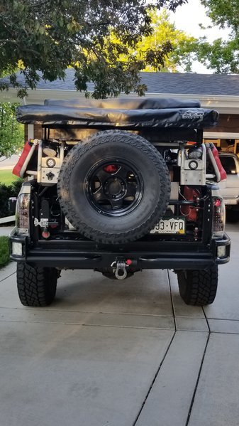

    And all closed up now.

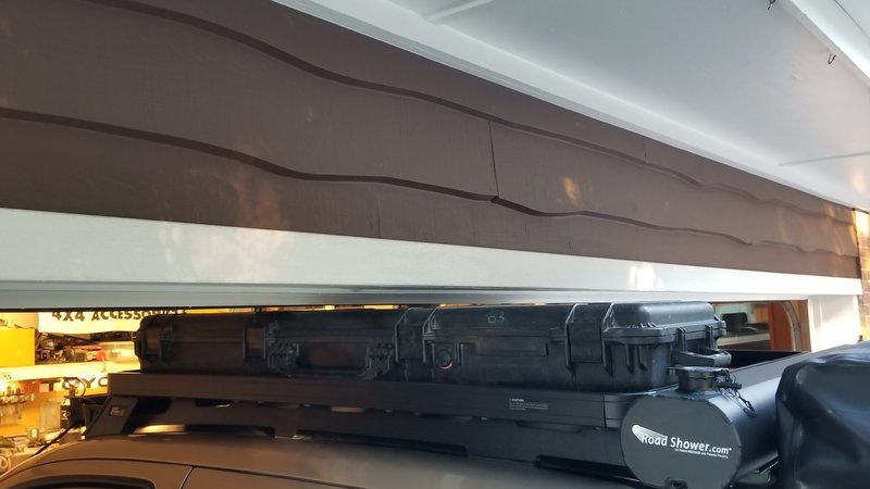

    Also got my full length Pelican case today. Thank you @coloradolife. Need to still get new foam for it and mount it to the roof rack. But at least I fit in the garage still. Well.....barely.

  13. Jun 4, 2017 at 8:14 PM
    #1633
    Guerrilla
    Guerrilla L(.)(.)K@G(.)(.)Dz
    Apr 24, 2013
    #102807
    6,810
    D. Cooley
    Coast to Coast
    El' Black 13 DCSB 4x4
    Stuff
    Dang, doesn't get much closer than that.. Might have to air down, if you do anything else.
