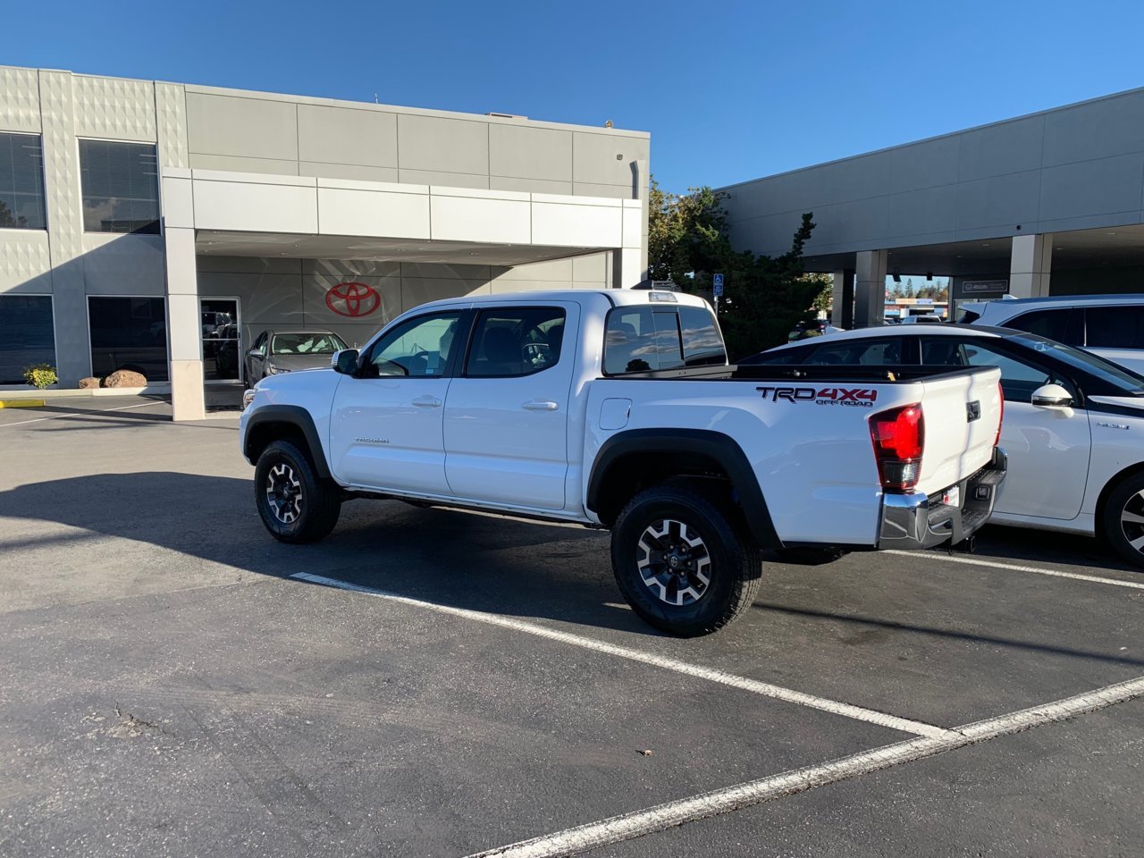

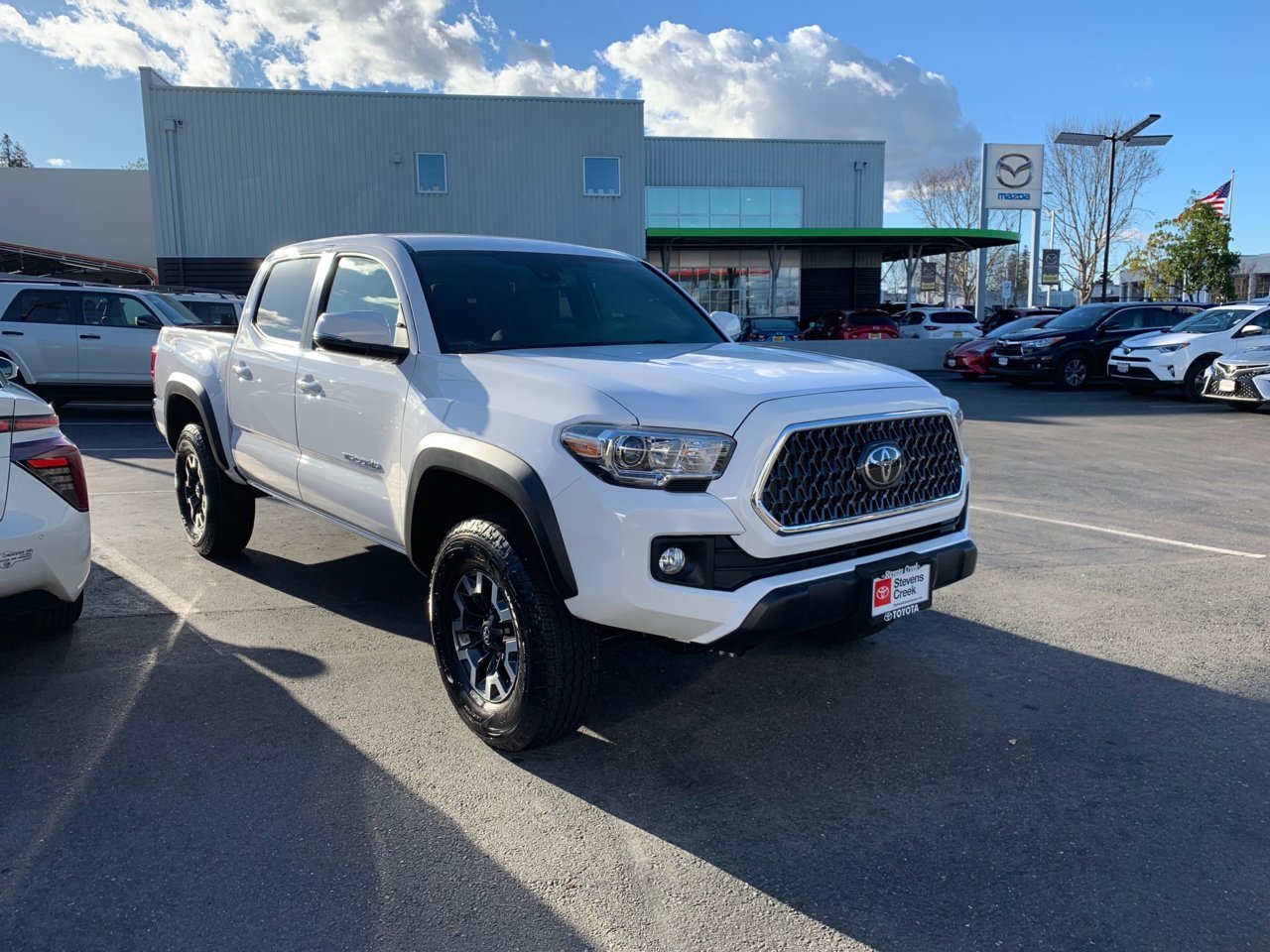

    Hello to everyone from the Tacoma community. During the next year and 1/2 my wife and I are going to be building and testing our 2019 Toyota Tacoma for an epic overland adventure around the entire world starting in Europe in early 2021 and ending in San Diego, CA in late 2022. We wanted to document that entire build process here from start to finish to serve as a guide for anyone attempting anything similar or people that are just curious.
    Attached are pictures of her being picked up brand new on Feb 5, 2019 from Toyota Stevens Creek in San Jose, CA. She is a '19 V6 TRD 4x4 6spd MT with ZERO options.
