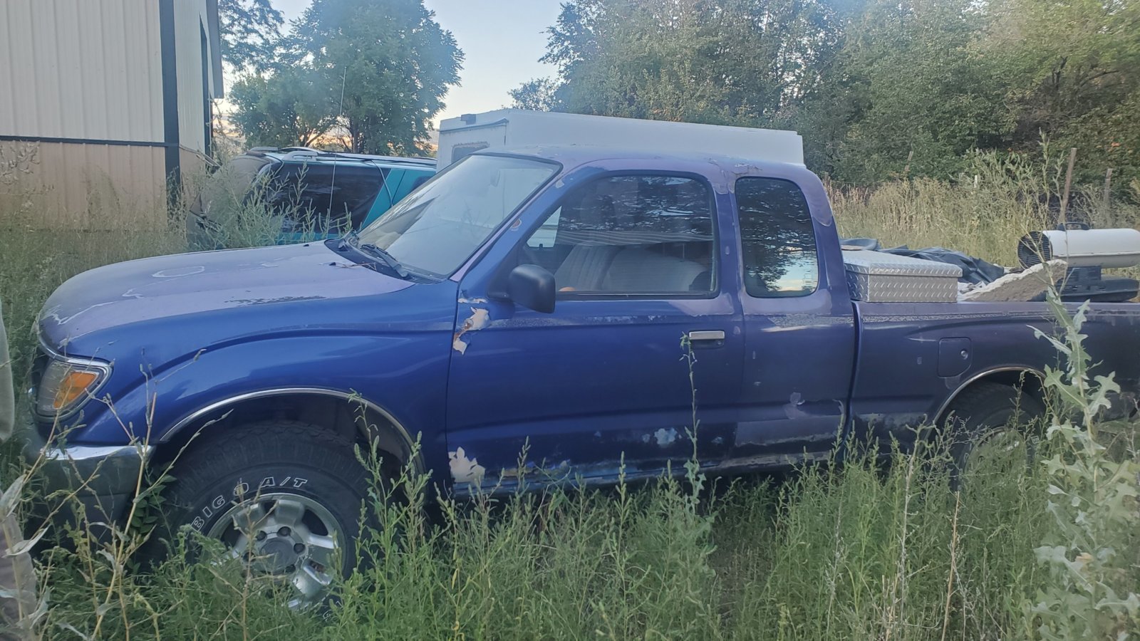

    Fast Forward to July of this year. My Dad knew that I had been looking on and off, and called me to let me know that he had just remembered that my Grandfather (who had passed away approx. 2 years ago) had an old purple Toyota truck, but didn't remember much else about it. He pointed me in the direction, and let me know if I wanted it that I probably could have it. It was sitting in the desert of Utah at a distant relatives house, where it had sat behind a shop since 2005. I contacted some other family members who went out to take a look and send me pictures.

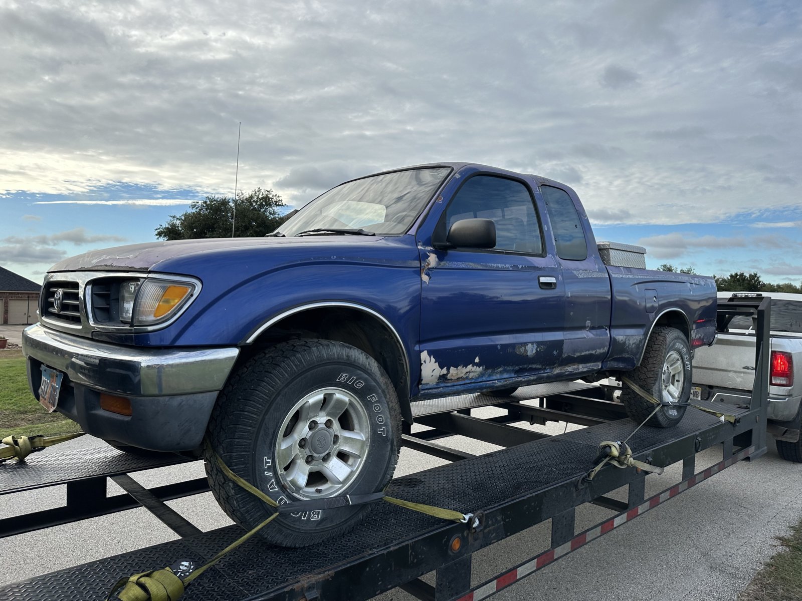

    They were very quick to temper my expectations, letting me know that it looked very rough! It had a lot of stuff in it, flat tires, and very rough paint. All I saw was my dream truck. They graciously cleaned it out, aired up the tires, and pulled it to the side of the road where I had it picked up and brought across the country to me.
    I could not wait while it was in shipment, and was the most giddy I had ever been when it got here. Getting around and underneath it, I realized just how clean it was! From what I can tell looking at reports, the frame was never replaced, but I am hard-pressed to find much rust on it. There are very small light points where there is some, but I cleaned them off, and have put fluid film over them for the time being. Most of the frame still has it's original coating on it. There is rust on parts like exhaust line, but it's not terrible. There's a bit on the body, but I'll get to that in a bit.

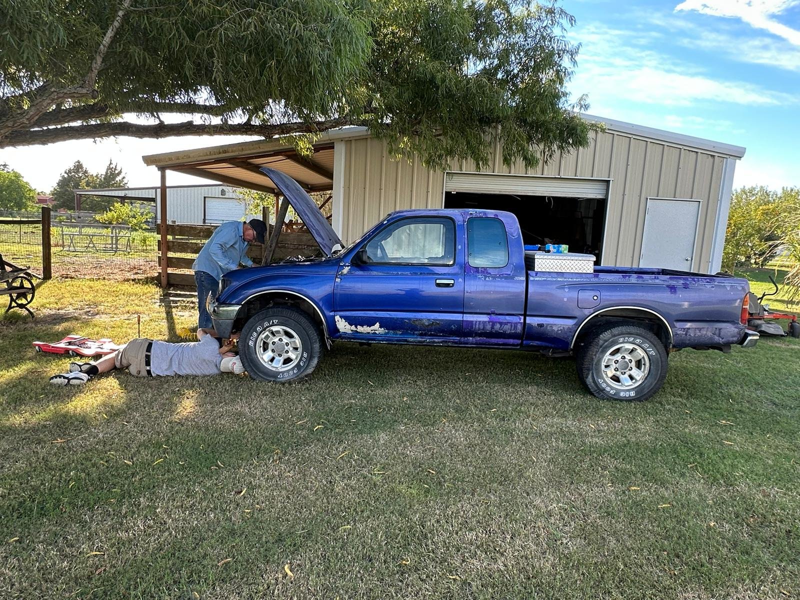

    When I could pry myself from behind the wheel, my wife and I went around the outside with Ospho and painted it on all of the rusty spots on the body. My buddy noticed something was leaking underneath that looked like it was coming from the steering column or brake master cylinder. All fluids looked as clean as you could expect for it sitting for so long. I eventually decided to move it from my buddies Dad's place who has a lift, to my Dad's place, as I was in line for the lift. I drove it for the 2 miles to my Dad's place with my dad following me. The suspension was a bit bumpy, but the engine revved very smoothly.

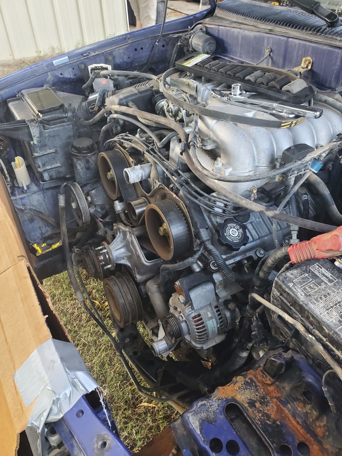

    Once it got to my Dad's place, we pressure washed it and moved it to start inspecting further and doing the timing belt and water pump. I drained and removed the radiator and sent it with my Dad to a local radiator shop to inspect it. As I got under the second timing belt cover, I noticed that the timing belt looked pristine, like it had been done just before the truck had been left! Looking closely at it, I could find no signs of cracking in it. I also didn't see any signs of oil leaking from the seals. I made the choice then and there to leave it on for now, and then do the change after 30k miles if I don't have any issues. My Dad was excited to see what was in the toolbox as we didn't have a key. He drilled the rivets and was able to pop it. My Grandfather had left many good tools back there. He also loved to hunt fossils in the desert, and had tools for that as well. We riveted the handle back on and disconnected the lock for now.
    My Dad got the radiator back from the shop where he said it looked brand new. I reinstalled the radiator and topped it off one bottle of premix and hose water. I put the truck back together and still had to deal with the stinking security system that now was immobilizing the starter. I found a key fob for it on eBay, and also found the security defeat switch. I tried, and had my Dad try several times to use the defeat switch to overcome it, but to no avail. I replaced a cracked signal light as well.

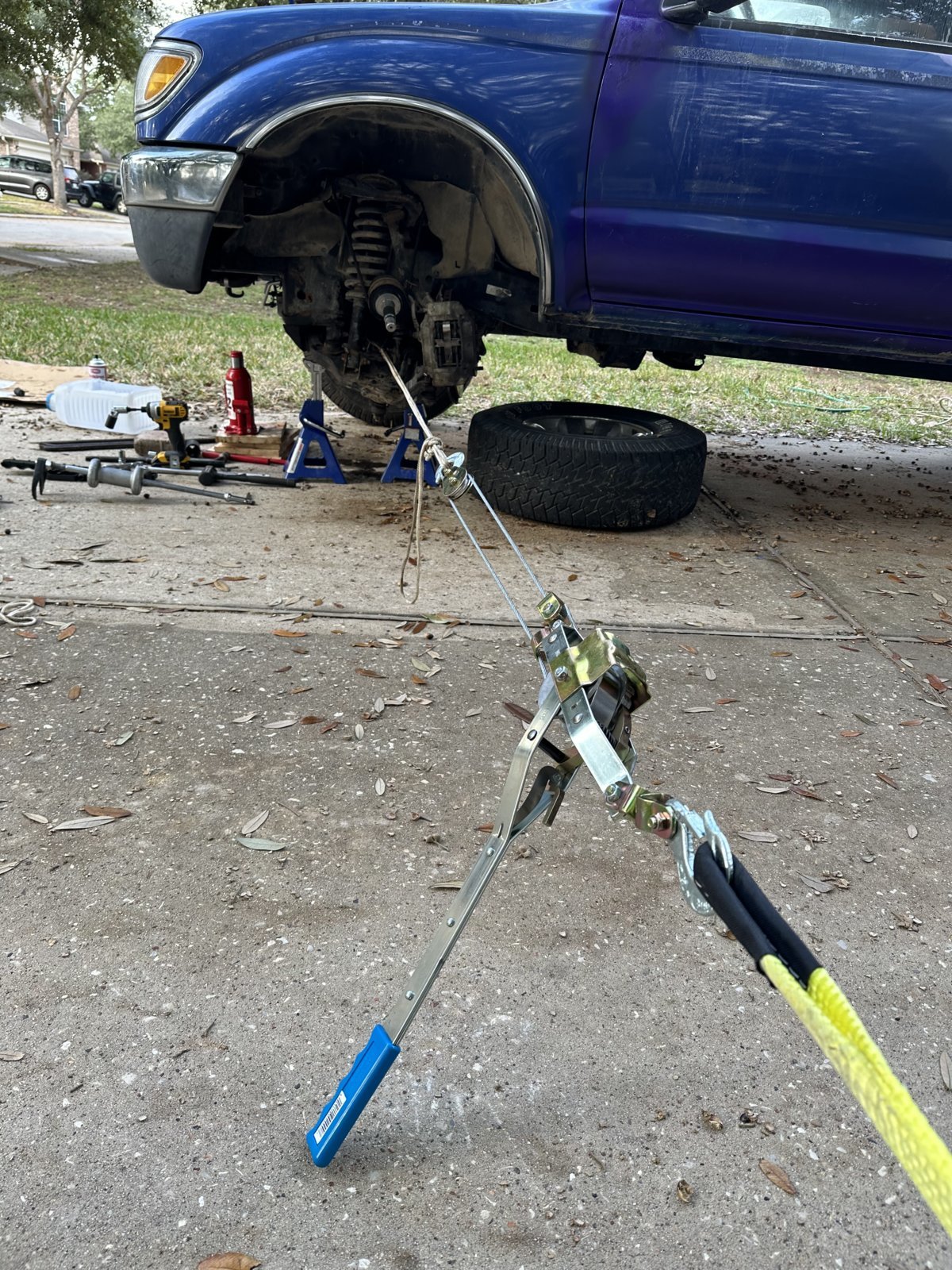

    I gave up, and ordered the new diff seals. When I got them, I moved to installing them. I started with the passenger side as I found a good video to do them fast that started there. I was able to pulled the wheel, disconnected the lower control arm, then pulled the CV axel. I pulled the seal with a slide hammer, and installed the new one (I used a 10mm Alan head on the end of my socket extension and slowly hammered it in going all the way around many times. After seating it to the correct depth, I fought reinstalling the CV axel till I found a good tip to grease the retaining ring. As I was moving quickly, I didn't think and with a greasy hand grabbed my brake rotor... I left that the wheel off as I was out of brake cleaner. I moved to the drivers side. I took that wheel off, disconnected the LCA, and then began to pull the CV. It came about 1/3" but then stopped. I tried prying it and it wouldn't budge. I tried rotating and prying. No dice. The next day I pulled the hub off, and tried to slide hammer it, nothing! It wouldn't budge! I did bad things to it... I put the CV hub pulling adapter into the gap and tried to jack it into there to try to wedge it out. Nope. The sketchiest I got to after days of trying was to tie a very old thin rope that was in the toolbox around the back of the Axel Housing in the gap between the diff and the CV axel, then connected it to a come-along that I ran to a big tree in my front yard:
    I made sure to clean the brake rotor on the passenger side, reinstalled the wheel and dropped it to give the truck more friction against side to side forces. Running the line around once, it snapped after getting good tension on it. I then doubled it around and pulled till I got to full pucker, then called it quits on that method. I HATED THAT CV AXEL. My Dad came over and recommended I cut the upper boot as it was already cracked. I did, and pulled the lower portion of the CV axel leaving the Axel housing and shaft in the diff. Then, off the recommendation of another video, I connected the slide hammer to some vice-grips, connected them to the housing and hammered. I would get 4-5 good whacks in before the assembly would come off. I rotated, reconnected and hammered for hours. Nothing. I would pry and hammer, nothing. Then came Christmas Eve. My Dad came over and asked me to come show him the CV Axel that I was having issues with. IT WAS OFF. I had left the slide hammer on it the day before in frustration. My Dad came along and with one big pull with his whole body the sucker came loose! That was the best Christmas present I could have asked for.
    After Christmas, I picked up a new CV axel, reinstalled it by disconnecting the sway bar and put it all back together. I took it for a nice test drive through the neighborhood and grinned ear to ear as she ran well.
