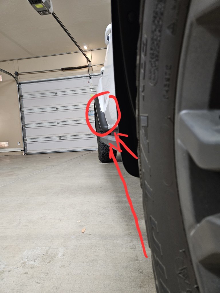

    Pic from front tire toward rear. Without mud flap or running board, there's a clear line of sight from low-angle rocks kicked from front tire at flared rear tire fenders. Per explanations in the 5pg thread, this happens because of modern aggressively flared designs + more aggressive A/T threads that pick up rocks worse than a pair of On Clouds + tires offset to poke. Doesn't happen so much with flat sided vehicles and passenger tires.
    The other visual to consider is the mudspray pattern you get all along the side of your truck from the fronts.
