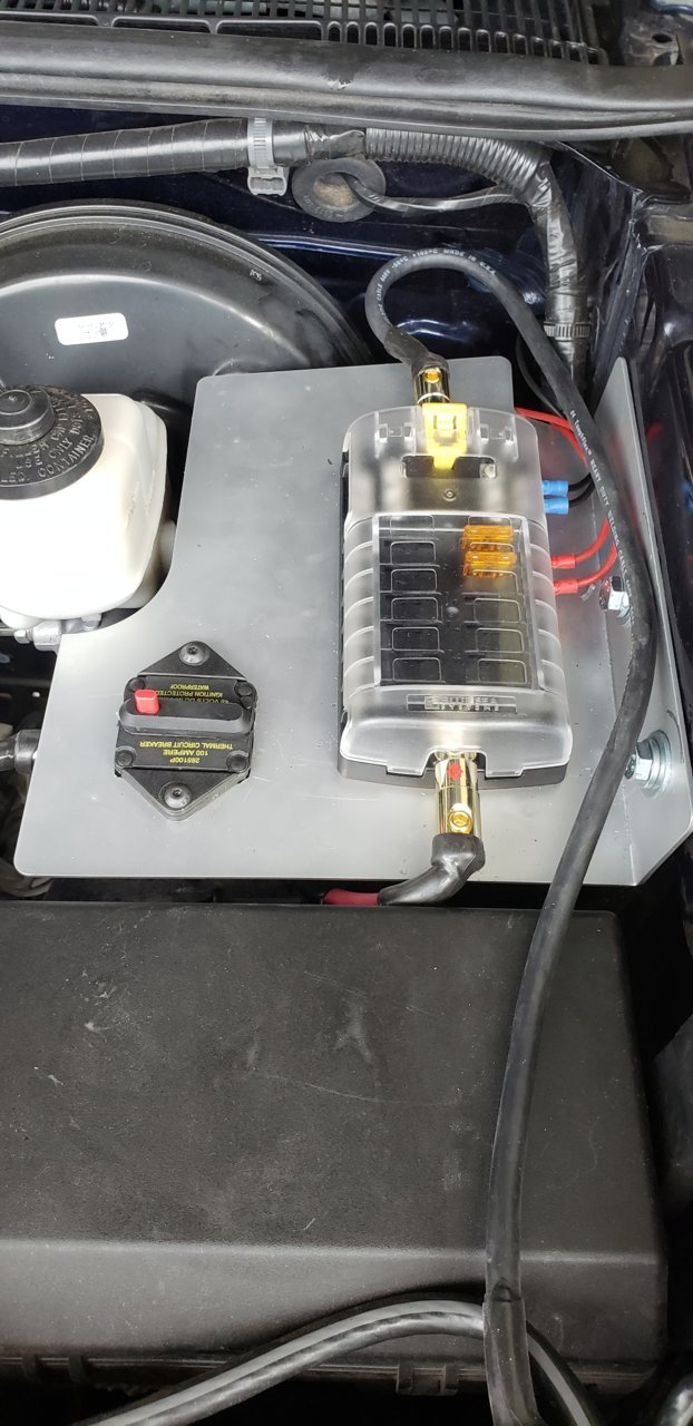

    What is a relay? Why would it matter if the switch has LED's? What is a positive switch wire? What is daisy chaining?
    My plan was to use 18ga wire running from the firewall to the Blue Sea fuse box from inside the firewall(after the male/female molex connects) run 18ga wire to whatever switches I use. I only have two things I'd hook up right now. My usb/voltmeter.

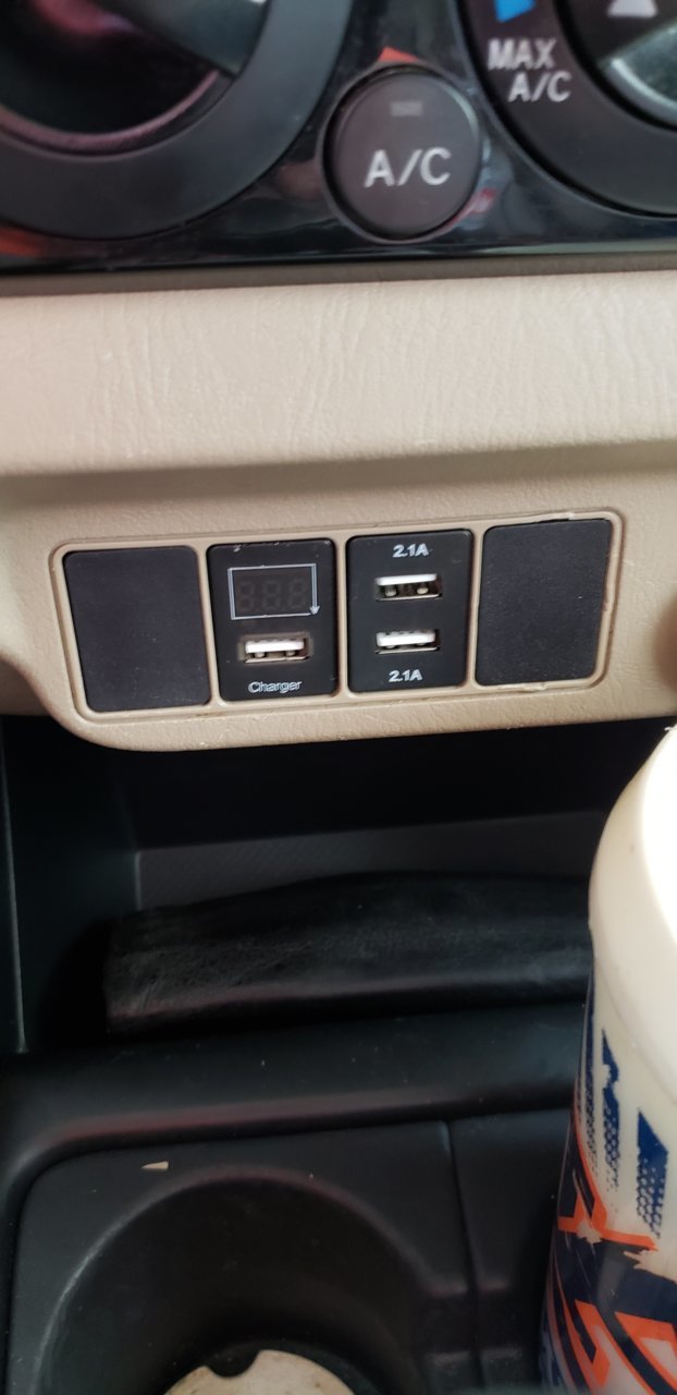

    I don't have any switches right now.
    The usb/voltmeter is wired straight to the fuse box with a 5amp fuse. It's always hot.
    I had planned to run the wires on the engine bay side of the firewall to the molex right inside the firewall and leave the switch side of the molex connectors empty until I add things with switches. Like my LED bed strips

    Man that still looks good. Well done Phil.

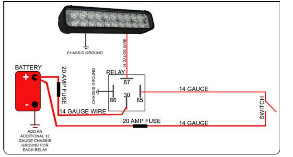

    Ok . So here's a diagram with a relay in it. Have you seen this before? Figuring out where we can start with this
