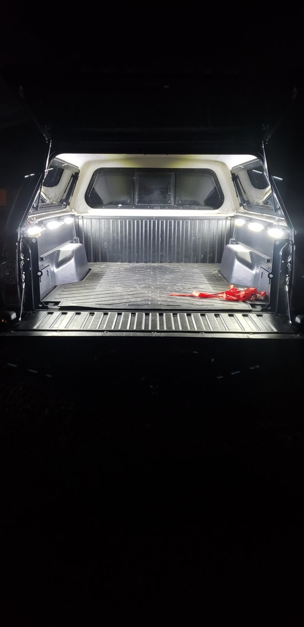

    I'm looking at my 'saved for later' on Amazon and those bed lights and the Redline struts are looking enticing.
    Do you have how you wired yours anywhere?

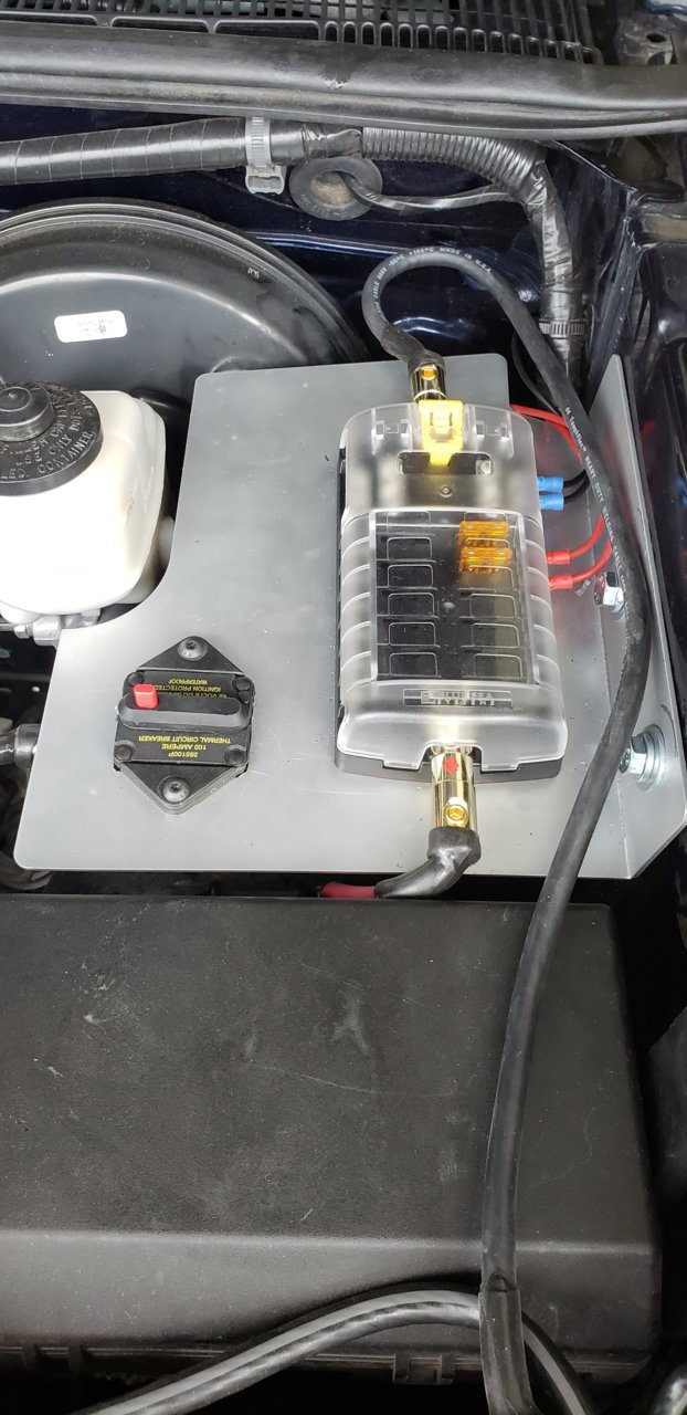

    Yeah.
    Drilled a hole on each side towards the cab(ran wires up the frame and connected them on driver side, then traced the factory wiring)
    I wish I had stuck them to the metal rail thing facing down. They have started falling on the bedside. I've got to redo it
    By the tailgate on drivers side
    Wired to the blue sea fuse panel

    Hmm...
    I'd have to do mine to the battery or tap a fuse. I don't like the looks of that push button switch though, my foglights had one like that and I hated it but it'd be nice to keep the switch in the bed.

    I'm sure you could use any kind of switch you like. Go back and read my edit.

    Ah, yeah I'd definitely do mine facing down. I'd probably run them up and put the button where yours is. I'd probably just keep the switch it comes with to save the headache of having to wire up a new one. I'd have to find grommets like that too or use silicone..

    I bought the grommets on either Amazon or picked them up at Harbor Freight. I bet they even have switches :D

    You gotta do her facing down. Too ugly facing out.
