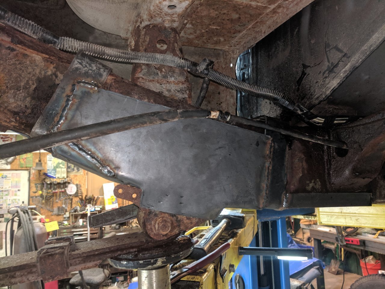

    Guess who is tired of frame repair?
    Holy fuck! I had to splint the frame to keep it from folding in half on the hoist!
    Anyways, it's good for another 5 years.
    I am not showing pics yet. Welds look like ass trying to find quality iron on this 21 year old rig.

    how much frame repair did it need, all over or just one spot?

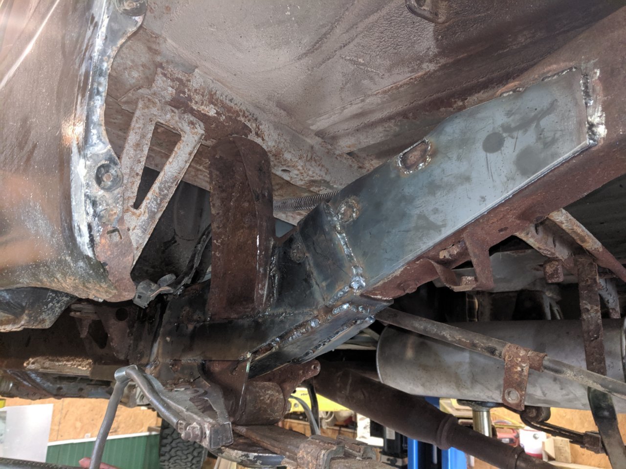

    It needed about 15" of frame gusseting.

    :eek: That ole truck is in sad shape

    If it gets me 4 more years, I figure Im money ahead.
    I needle scaled the entire rest of the truck. There are no other soft spots. I'll Fluid Film it after I get the new brake lines installed.
    The 1 thing I will not be doing...installing the fucking gas tank skid plate!
    That thing traps the dirt between the tank and the frame. There goes your brake lines and of course your frame.

    By Michigan standards, it's not that bad.
    Road salt sucks, no doubt. It is what it is.
    I bought the truck as a wreck from a salvage auction. It owes me nothing.
