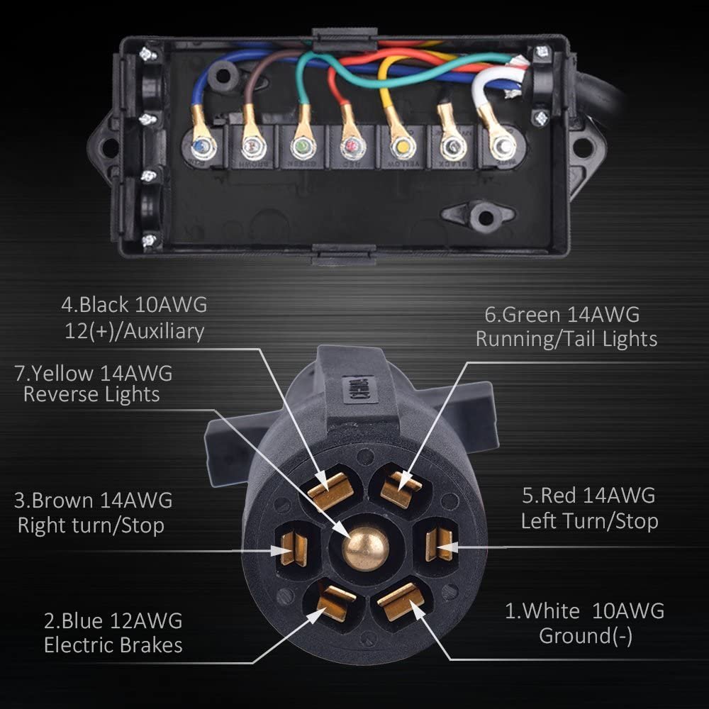

    I'll look when I get home to see how many pins I'll need in each plug. From the looks of it on the eBay add, it's 3 or 4. I can't really tell from the pic. I've also got a spare set of tail light plugs, so worst case, I ruin them :rofl:

    This is the diagram from my truck side harness. I just need to figure out how to connect it all.
    And this to run back to the tail lights

    Only 3 of those wires are going to be used for the tail lights, maybe 4.
    I don't think those plugs are going to work with the existing Toyota tail light assembly. You would be better off gutting the lights and gluing in some dedicated trailer LED lights.
    Are you planning on having the back up lights and the trailer having electric brakes?

    I have to use the stock Tacoma tail lights. I don't really want to rig it up. I want to be able to use the harness that came with it. The plug would be great, but if needed.....I'll cut the plug off and solder the wires.
    Backup lights aren't a "must", just would be nice and the brakes will come later if needed. The axle already has the backing plate on it.

    There has to be a way to make it work. I may start a thread once I can get home and take a pic of everything. There's 5 wires from the 7 wire kit(blue is brakes and white is ground) that go towards the back. Then I will have R turn/stop(Brown), Reverse(Yellow), 12+/Aux(Black), Running/ Tail Lights(Green), and L turn/stop(Red).
    The white will be grounded towards the front of the trailer(probably on a frame bolt) and the blue will not be hooked up(I will seal off the end to make sure it doesn't touch anything).

    After you grouind the white wire on the frame You are going to have to split the white and run one to each light. The Toyota lights do not ground on the body of the truck (obviously, they are plastic).

    They don't ground on the truck. They go into that 1 pin and then into the "truck" harness. Why wouldn't grounding the harness work? Worst case I should only have to make 2 grounds....one for each tail light plug.
