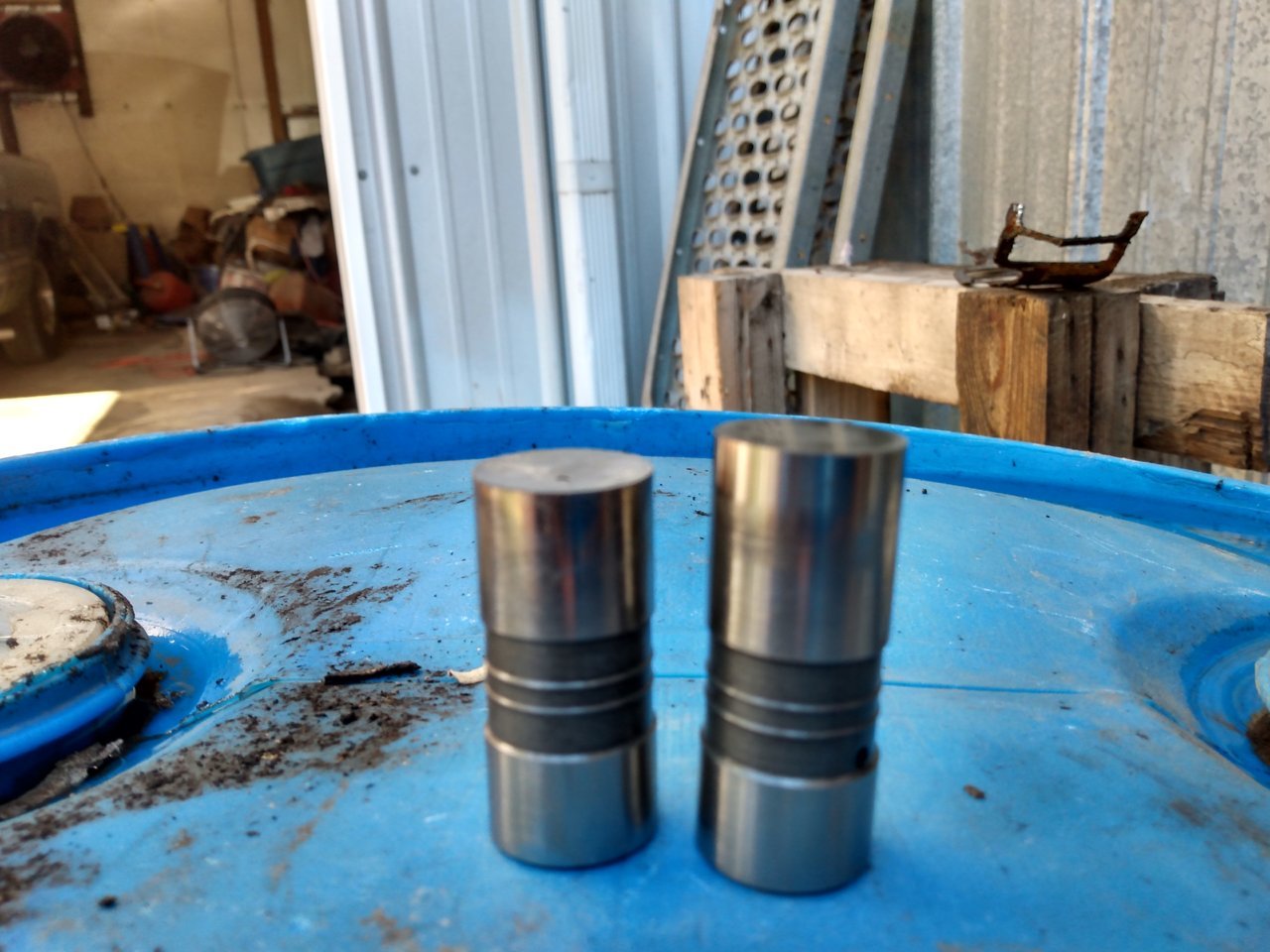

    Kicking back, busy day at the shop, found out the problem with the truck motor.

    Those are lifters? And if so, aren't they suppose to be the same size?

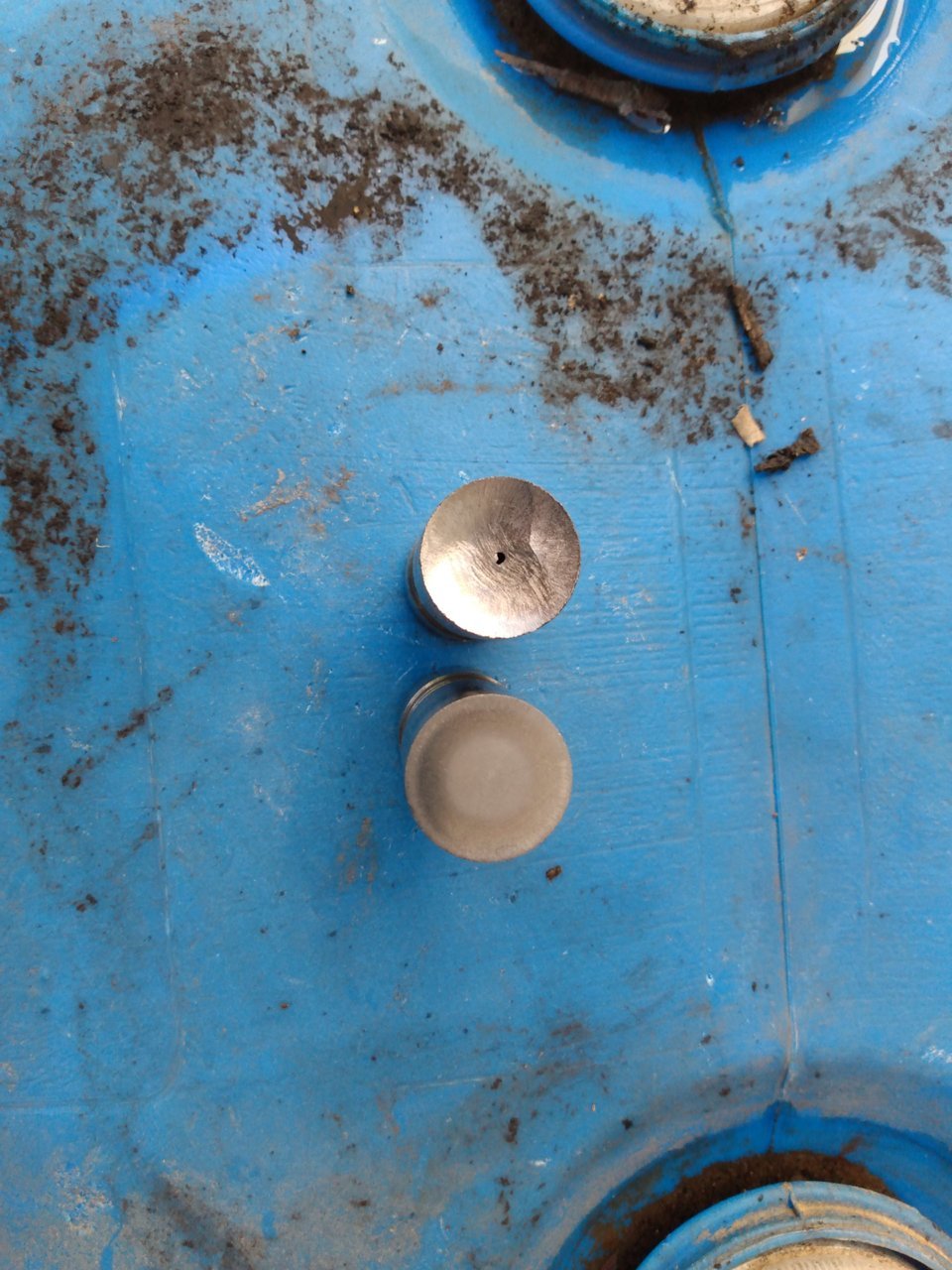

    Yes they are lifters and should be the same size. The short one is worn almost threw. Motor only has about 200 miles on it.

    I am out my time, but they are going good for the cam and lifters.
    I'm just pissed about the fine ground up lifter and cam lobe in my oil pan.
    Going to give it a couple oil flushes.

    Keeping my fingers crossed, the cam bearing surfaces looked good.

    It basically means that the bearing surfaces still look good, not scored or scratched.
