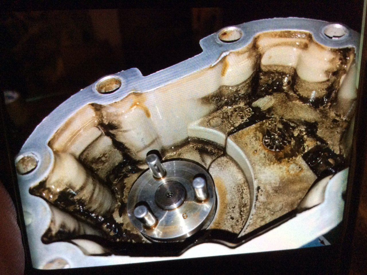

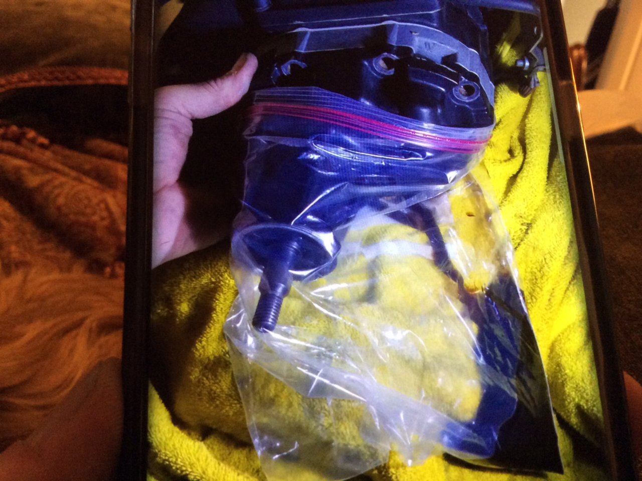

    You can actually leave the supercharger on the engine and put an extra large zip lock bag
    under the nose and unbolt the bolts.
    It will leak into the bag and have a towel ready.
    Clean the seams after you pop the nose off and fill the specific amount back in.
