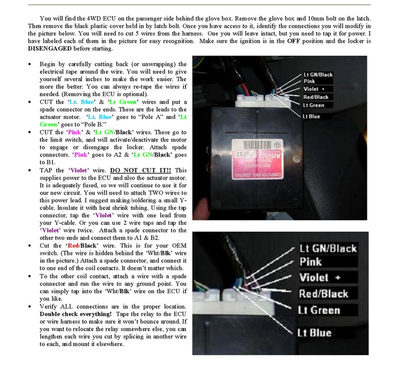

    Has anyone else tried this mod? Also, it was unclear wether or not the locker light stayed on like many of the gray wire mods listed for Gen one Tacomas. Are there any other write ups like this one that confirm it works ON GEN 2 TACOMA? Are multiple Tacomas known as Tacoma?

    I don't think it ever actually limits your speed NovaGTS, TOYOTA recommends not going faster than 5mph, and it's supposed to only opporate in 4L so that alone limits your speed to a degree.

    Wow! Absolutely fantastic Norton! Thanks for the link! Planning on doing this soon on my 14, hopefully they didn't change to much in the wiring. I am very mechanically inclined, but I definitely learn things a little differently than most, and the previous links were leaving me a bit worried, that link was just the ticket Norton! And thanks to JSI for the whole write up.

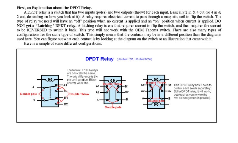

    BTW, that link in JSI's post for the Amazon relay wasn't good, does anyone have a link to the correct relay that he used?

    I had no problem when I installed the mod on my 2013. Take your time, confirm wire colors before splicing/cutting, and I'm pretty sure your experience will be similar.
    It's been a while since I bought mine (via eBay), but I'll see if I can find any details on the purchase. IIRC, however, just about any DPDT 12V/10A relay should work. (Frankly, I don't think the 10A rating is as important as DPDT and 12V.)
