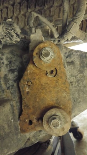

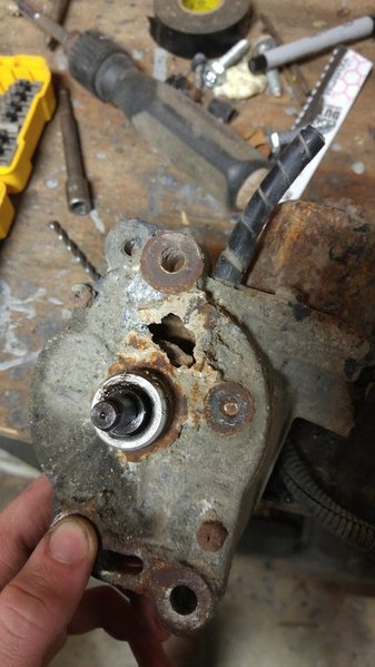

    I took off my elocker in hope to rebuild it and make it functional. But when I took it off, I found this.
    Yeah there is a huge hole and a pile of dirt in it. It was falling apart the more I handled it. And on top of that the gear is missing. Where it is, I have no idea. I highly doubt its in the diff. The only reasonable explanation would be it got stuck in the lock position so the previous owner took the actuator out, pulled the gear off, and bolted it back up.
    So obviously I couldn't drive around with a huge hole in my diff so I fabbed up a block plate for a temporary fix until I find a new actuator.

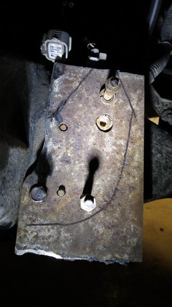

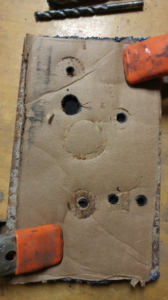

    First thing I did was cut out a piece of cardboard big enough to cover all the bolt holes for the actuator. I placed it over where the actuator would go and hammered all around the bolt holes and guide pins to make a template. This is what it looks like after hammering. This is the side facing the diff.

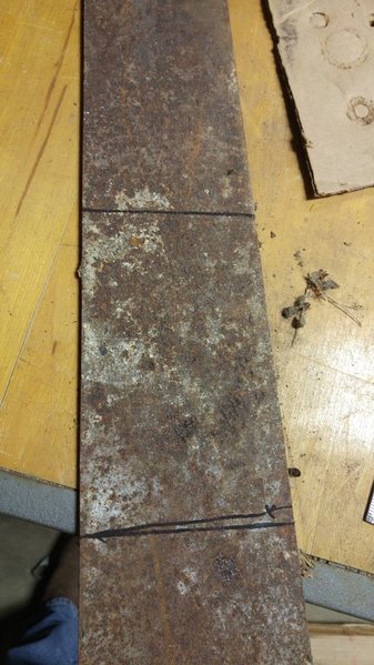

    Got a scrape piece of 1/8" steel plate and cut it to the size of the cardboard, excess will be trimmed later.

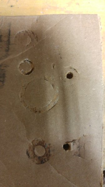

    Placed carboard template over steel and marked all the holes with a marker. They wont be perfect. A die grinder will be used to enlarge holes so everything will line up.

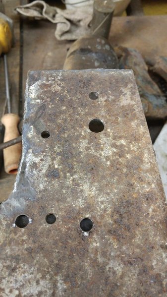

    After drilling

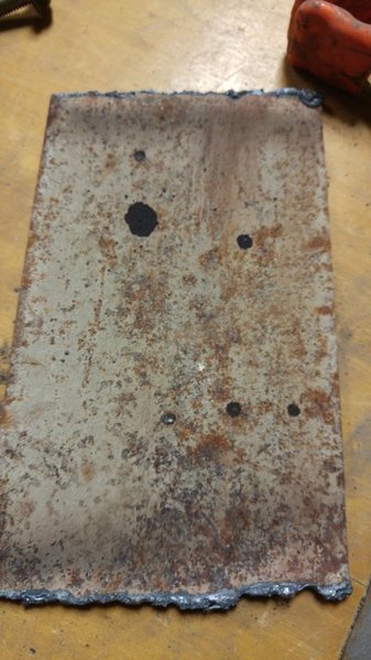

    Then after some grinding in the holes so it would fit and set flush. Also marked the excess that will be cut.
    The original bolts were too long. We found bolts with the same thread and stacked washers. It doesn't look pretty but it works. Also put some rtv around the hole in the diff for a good seal.
    So far no leaks!

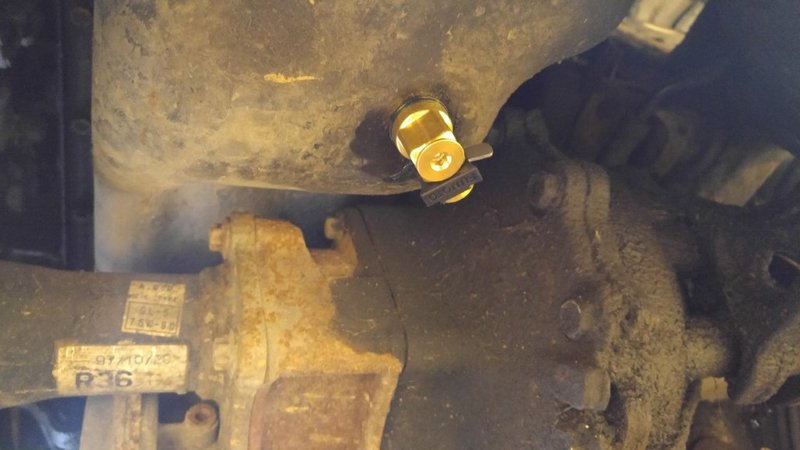

    Changed oil and installed a fumoto drain valve.
