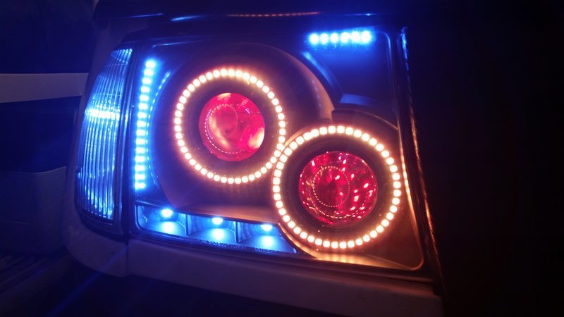

    I think I'm going to try to switch the drivers even though I'm getting power through it. See if the driver is the problem. People say it's very rare for the halo to just go out, usually it's always the driver.
    I really don't want to take the headlights apart.
  4. May 31, 2016 at 6:31 PM
    #224
    gray223
    gray223 [OP] Well-Known Member
    Nov 6, 2013
    #116062
    3,439
    SE Missouri
    2014 Tundra Limited
    Found a way to use my other driver to check if the it's bad. Using the other driver the halo did turn on. Just need to get a new driver then!

    Got 2 more drivers from TRS.....neither worked. The halo does work, I unplugged the driver on the other headlight and ran wires from it to the halo and it turned on..... but none of the drivers I got from TRS turn it on. Idk what the deal is.

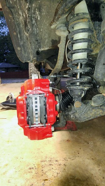

    In good news I got Tundra brakes in today! Going on vacation this weekend and still need parts from LCE to install them. Using hard lines and stainless brake hoses.

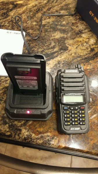

    Also got a ham radio! It's a gt-3wp baofeng. Supposed to be waterproof. Pretty impressed with how it's built just looking at it. Thought it would be something good to get started on.

    Tundra brake mod done.

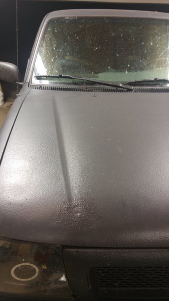

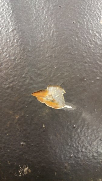

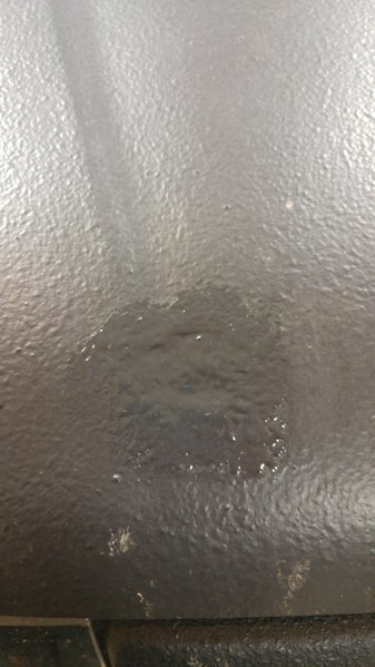

    So I decided to finally fix the crack on the hood of the monstaliner. I think it happened cause there was a lot of bondo there and the monstaliner just wasnt very thick. Got a repair kit from monstaliner.
    This is after I peeled the monstaliner that was no longer sticking to the hood.
    This is after some sanding
    After the first coat
    After 3 coats
    It didn't come out like I was hoping. Its not great but it will work. I wasn't sure exactly how to approach painting it but now I'm wishing I would have tried a little different technique. I also fixed some spots on both bumpers.

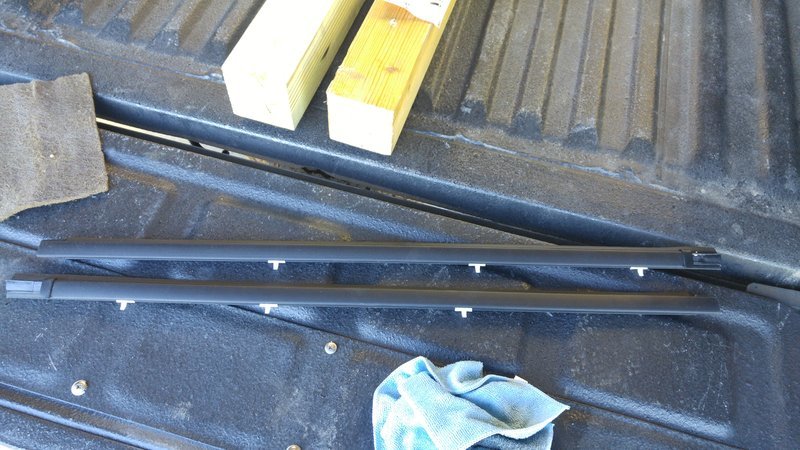

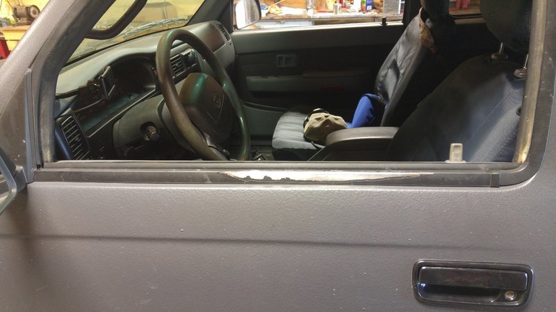

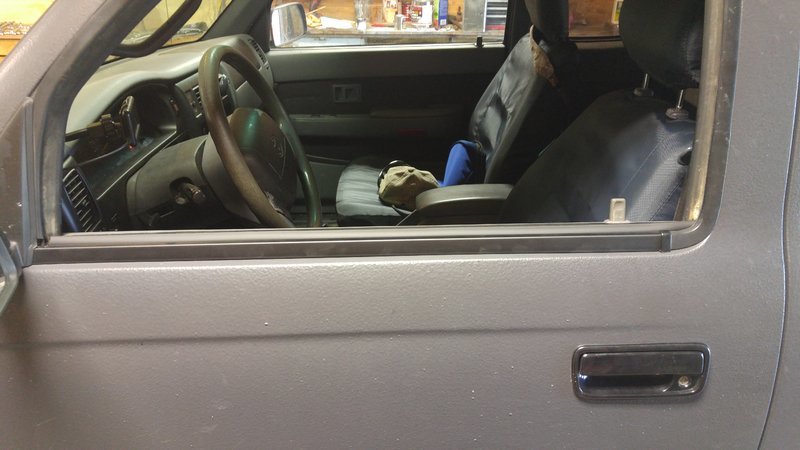

    Got some new window trim too
    Before
    After
    Looks so much better.

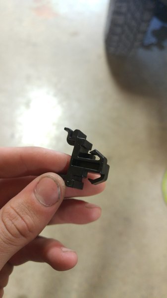

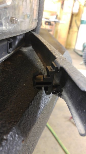

    Also got these clips for the filler plates so they will finally stay put!

    How'd you get the damn trim to come off? I've never been able to get it because I feel like I'm going to break it
  11. Aug 20, 2016 at 2:36 PM
    #231
    gray223
    Nov 6, 2013
    #116062
    3,439
    SE Missouri
    2014 Tundra Limited
    Just pulled. It should just pop out. Pull up on the side closes to the door handle and work your way toward the front a little and it should pop free
