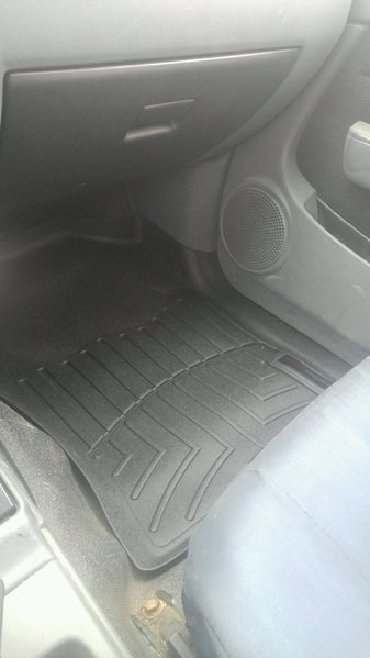

    Got in on the weathertech groupbuy on here. Weather tech says there not recommended for vinyl floors but they seem to work fine. They dont move around because the the side pieces. If i run into to problems i was going to velcro them to the vinyl floor.

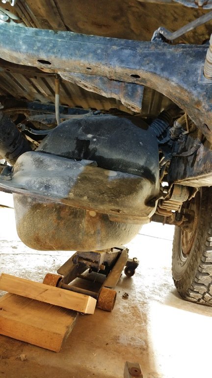

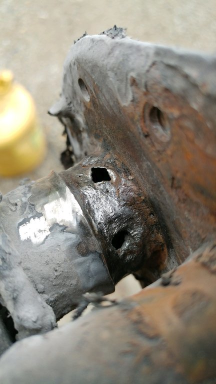

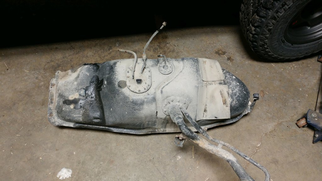

    Had my filler tube on my gas tank leaking for a while now and finally decided to take it out and try to fix it.
    It was right at the base of the filler neck, it had a pretty good sized hole, the other was from me when I poked a screw driver through it (took nothing).
    Had my dad weld it and it was tough cause there wasnt much material there so it kept melting through. We would check if it was leaking with a water hose, and no matter how much weld was on it it always leaked, and there was a lot....
    So I just decided to put 5 coats of rustoelum rubber coating hope it worked. Dont have pic of it all finished. But as of today its held up, no leaks.

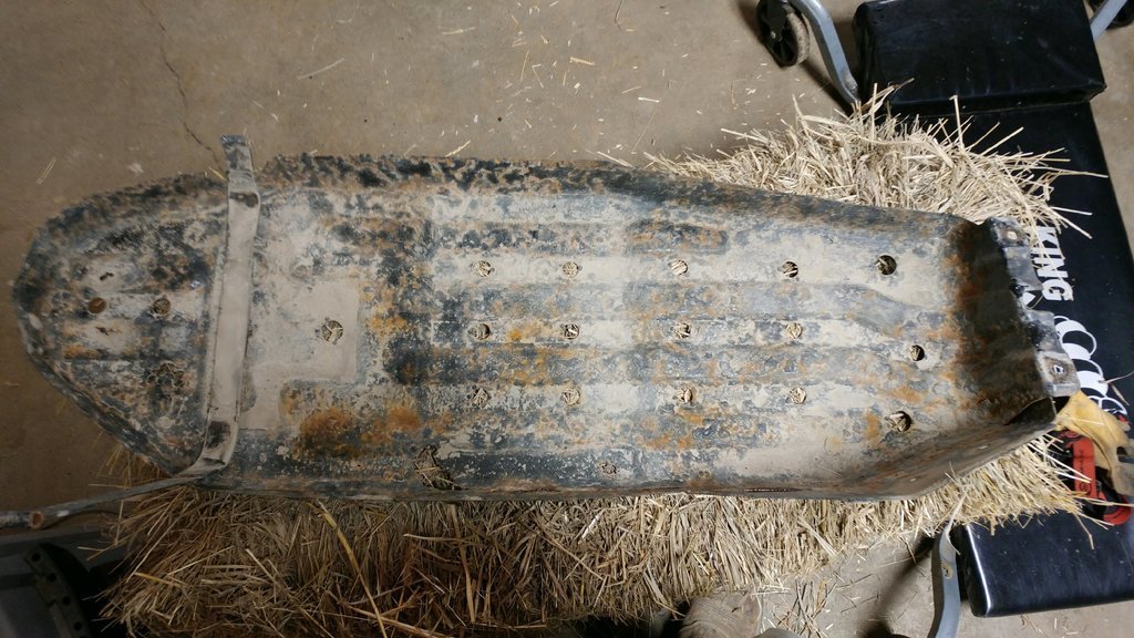

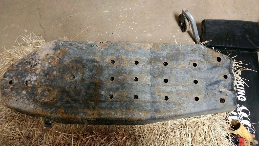

    Also here is the gas tank skid, gives you an idea of how well the chassis saver is holding up after almost 2 years. Considering It was probably the most rusty thing on the truck, so rusty a huge chunk fell off when I was reinstalling the tank, I think its holding up fairly well. The frame is still really clean , besides where the crappy welds are with small pin holes.

    Well the filler tube just started leaking again. I guess the gas eventually just eats away at that flex seal. A new one one is expensive. Going to have to find a used one on a part out I guess.

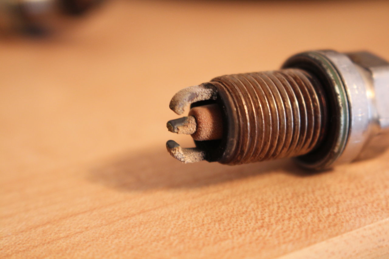

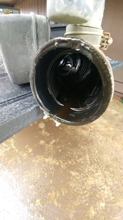

    Truck wasn't firing on all cylinders when first warming up so I knew it was time to change the plugs. They all looked pretty identical, definitely needed change.
    When I took the intake tube off it was full of oil. The intake for the pcv is always oily. I went ahead and bought a new pcv valve thinking maybe the one that in it isn't working and causing the oil to back up and flow into the intake. When I took the old pcv valve off I could hear the ball still rolling around, supposedly indicating it is still operational. So I am not sure why the intake is always getting oil in it from the pcv.
    And since I got a dslr I though I would take a picture of the truck, nothing special. And of my dog, whiskey.

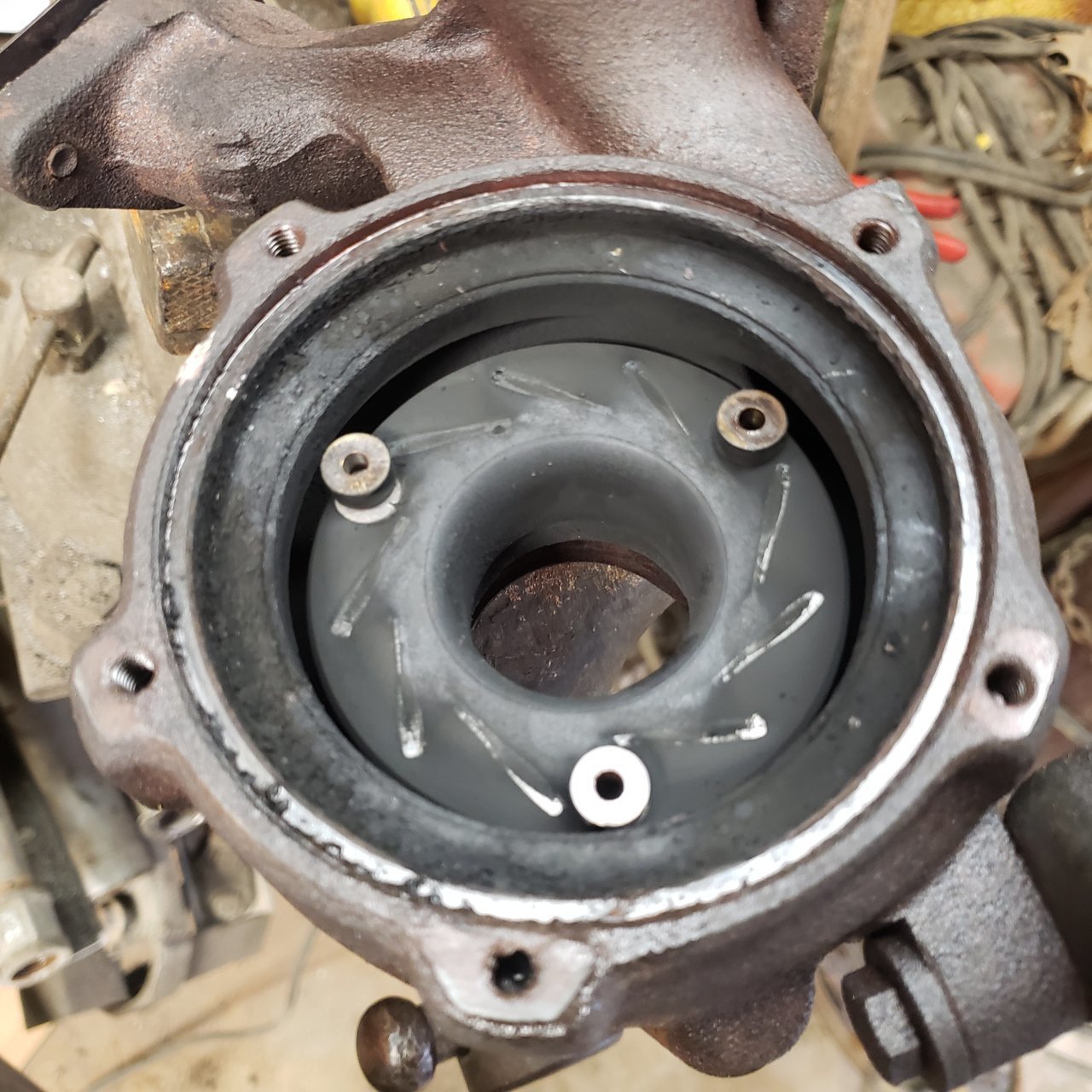

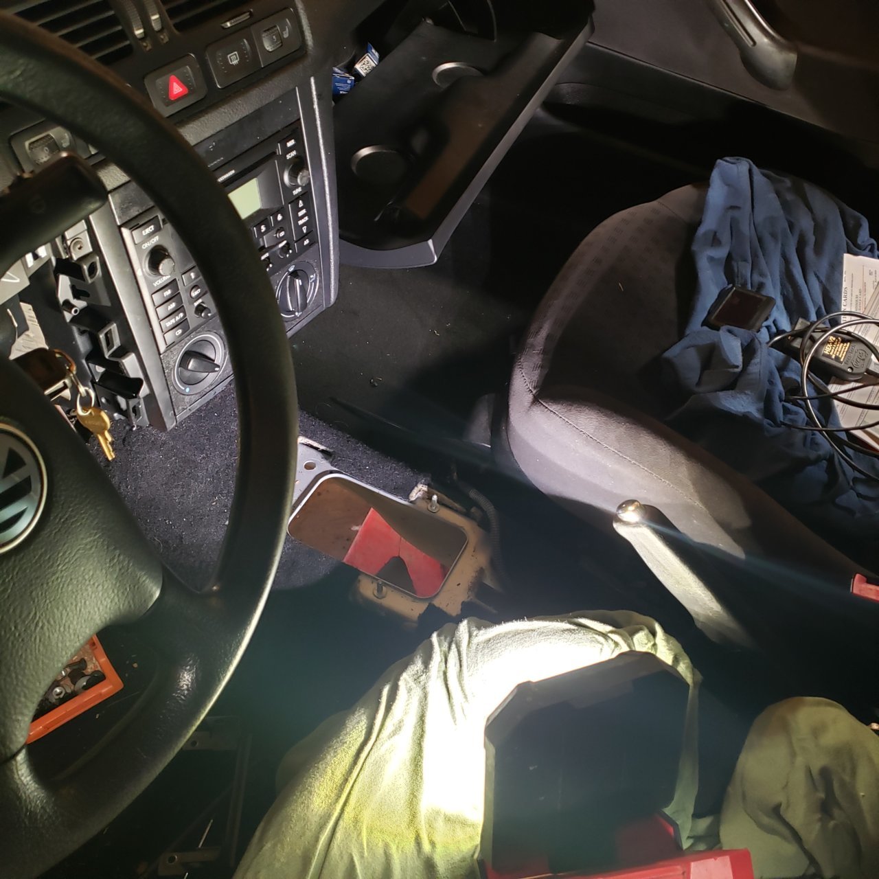

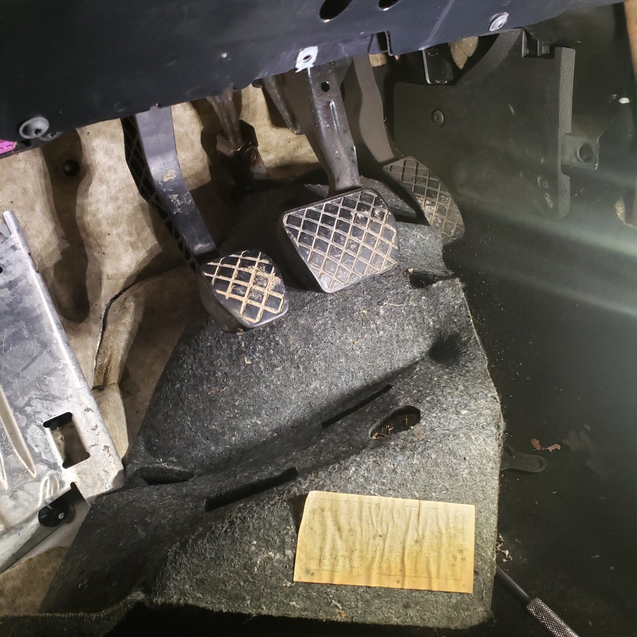

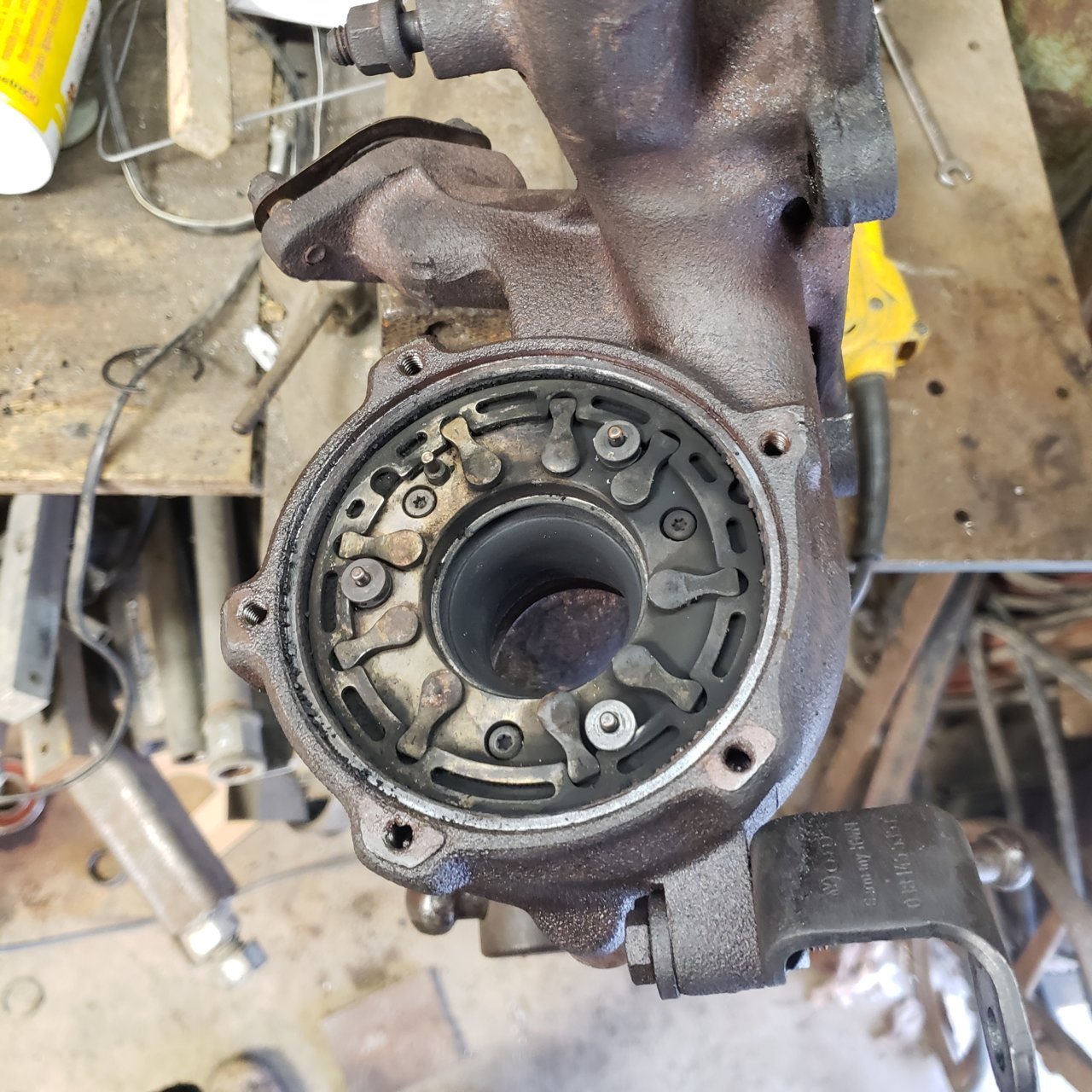

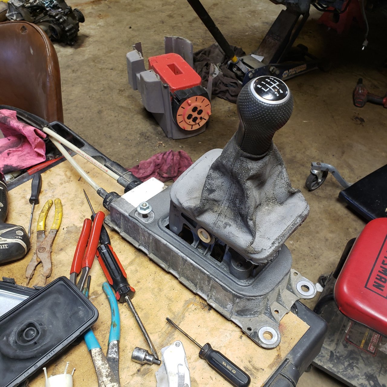

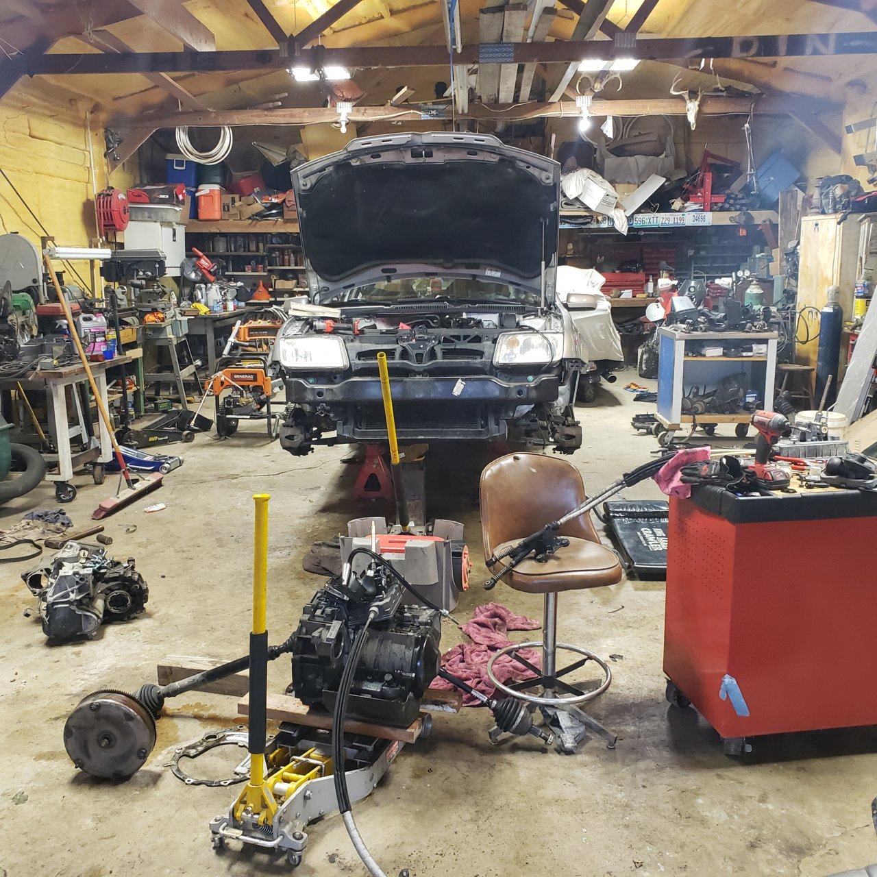

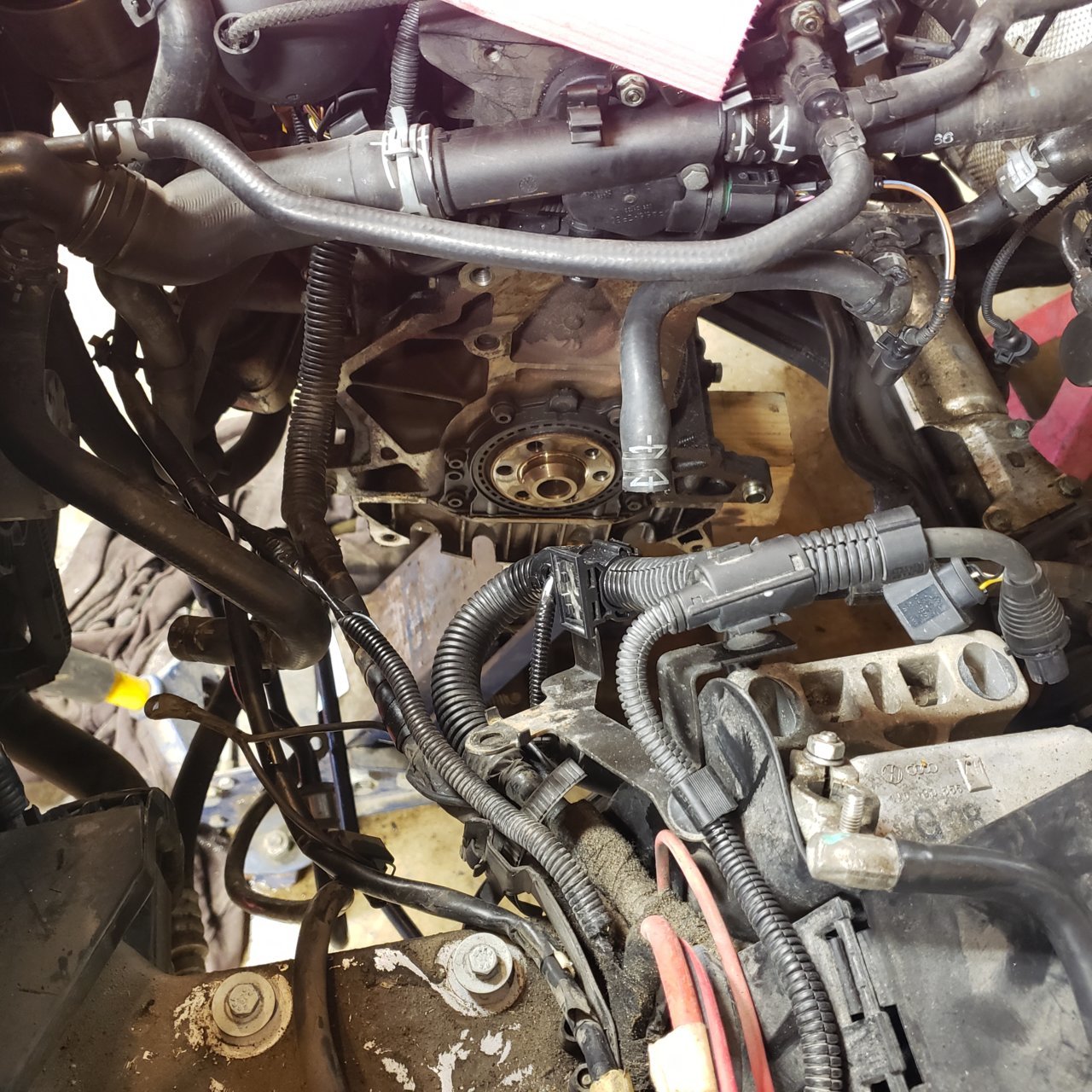

    On another note, I decided to buy a 2002 jetta Volkswagen TDI. The engine is a 1.9L turbo diesel, engine code ALH. They seems to be very well know for there durability and I have always been interested in them with there high mpg capabilities (seen reports of 50+). At one point I had contemplated putting one of the engines in a Tacoma and started getting a parts list together but plans changed, there is a 1st gen out there though with one swapped. They only make 90hp from the factory, bigger turbo and injectors it seems you can get 150hp+ reliably. Anyway the auto trans in it was slipping, they are know to fail pretty commonly because people dont service them like they should, so a popular thing to do is a manual swap. I bought a whole kit form a guy that specializes in them. Also changed the timing belt(pretty big task in itself..200$ for just tools to keep everything in time...), and cleaned the turbo(stuck vnt vanes) and cleaned the intake manifold(egr clogs in up). Also had to rip up the entire carpet and take the sound deadening out to dry...NEVER and I mean NEVER buy a car with a sunroof...the sunroof drain tube had came off of the outlet where it exits the vehicle and soaked the floor. It took days for it to dry out.
    Oil in the bottom of intercooler...what happens when there not driven hard.
    Turbo vanes stuck
    Auto trans center, manual left
    Trans out, new rear main oil seal
    Third pedal! The brake pedal was actually cut down after this pic.
