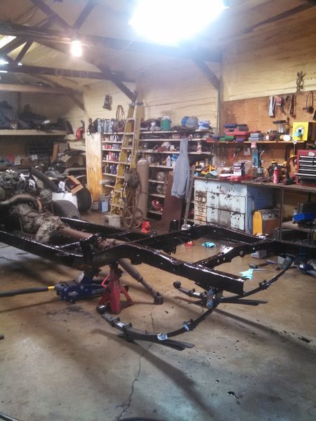

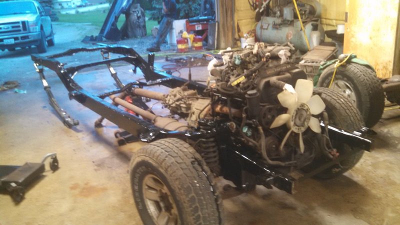

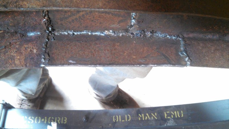

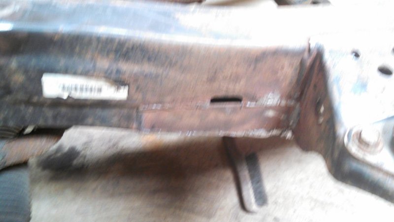

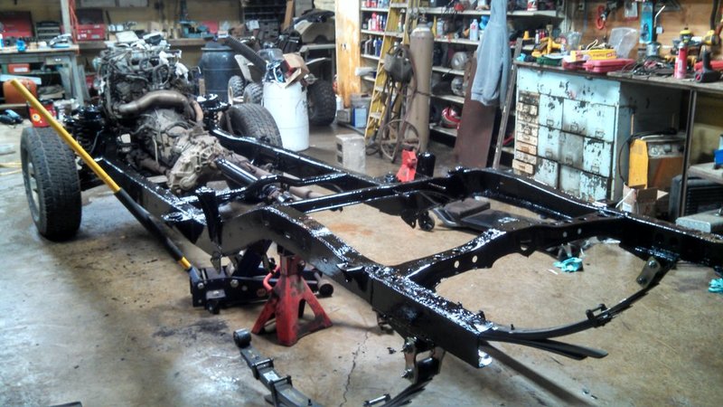

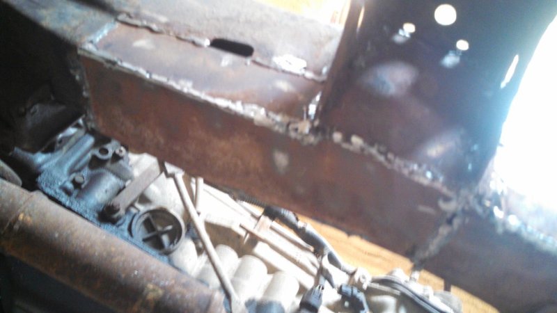

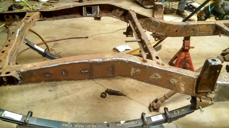

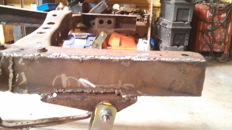

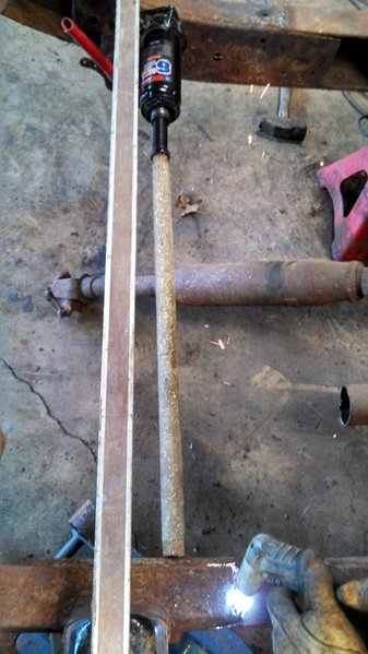

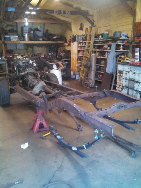

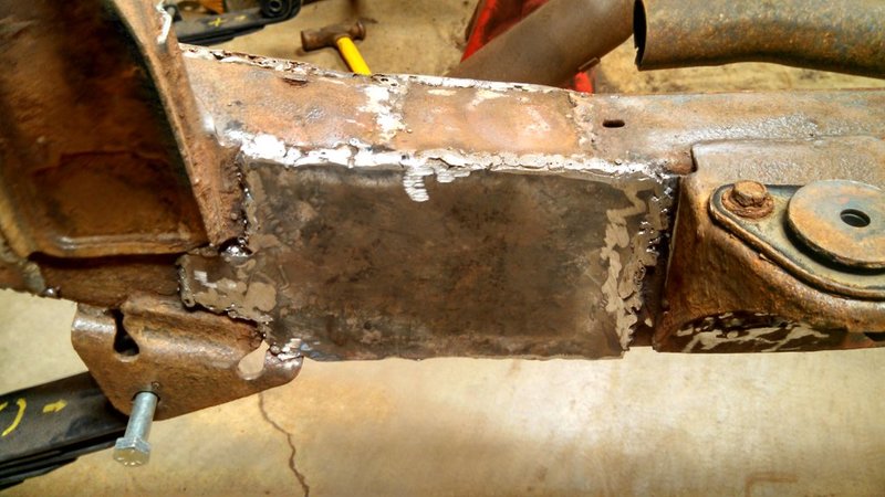

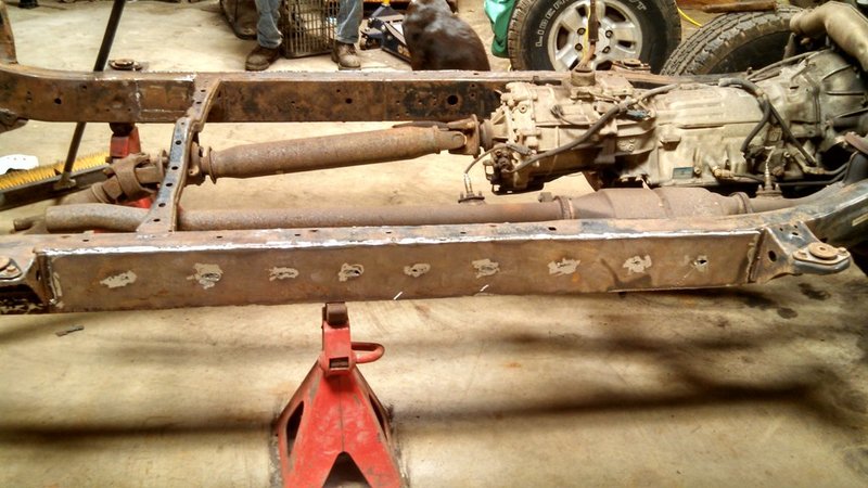

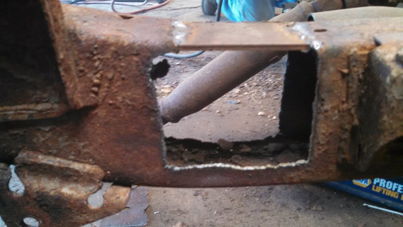

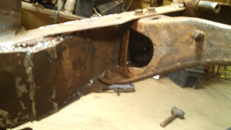

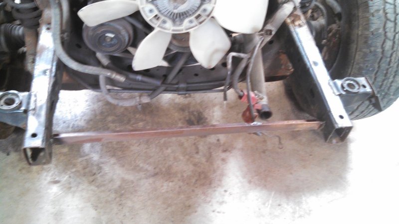

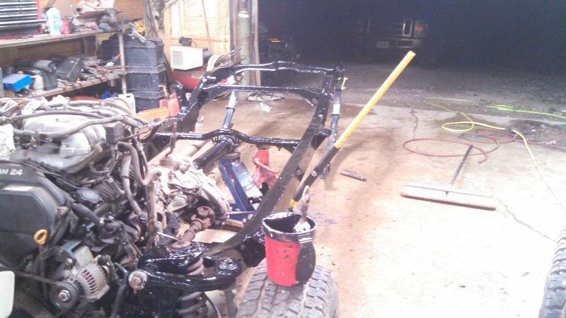

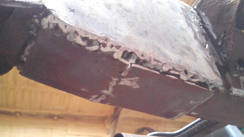

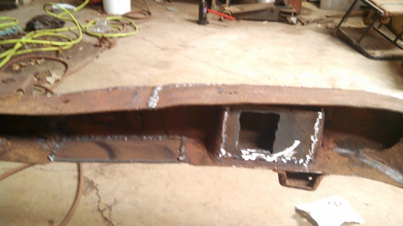

    Icons are in. There a little ruff, but they will work.

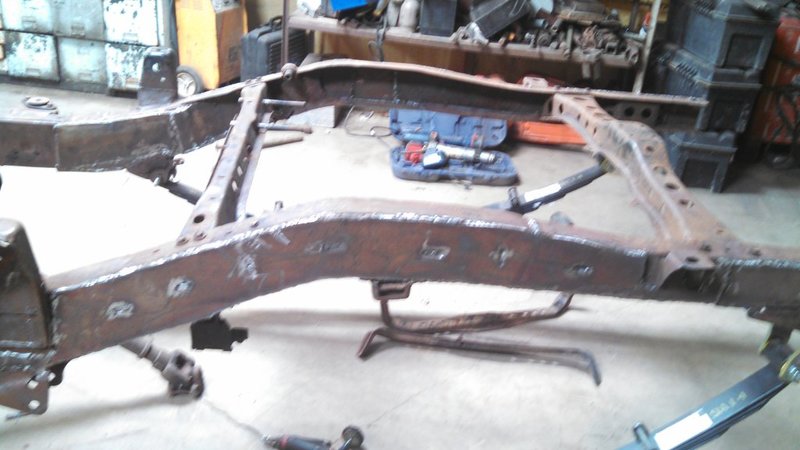

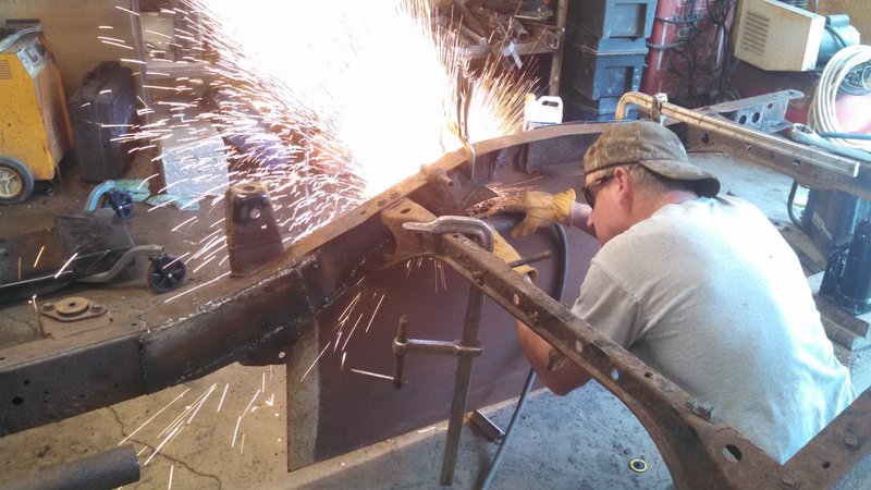

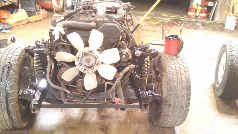

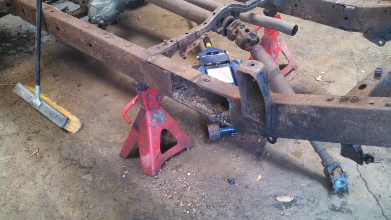

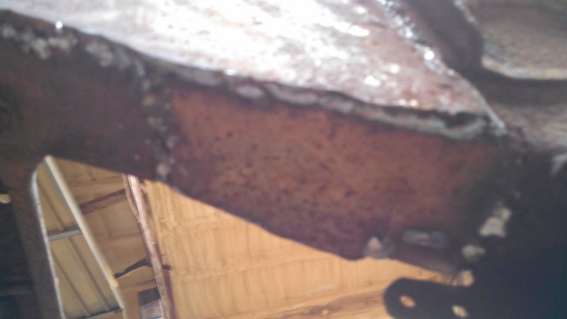

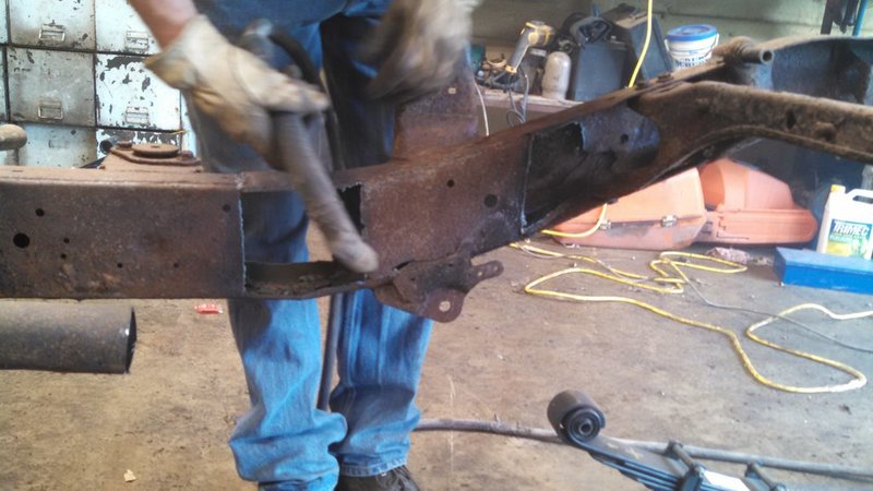

    Started cutting up the frame.

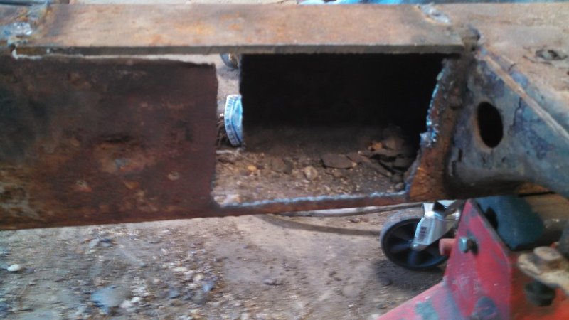

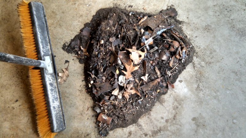

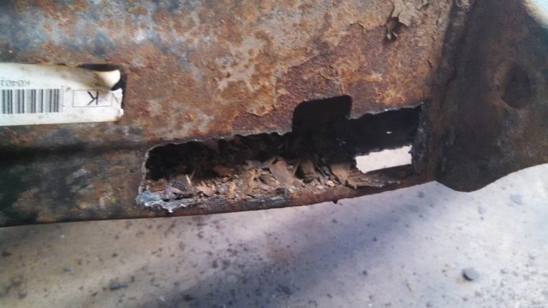

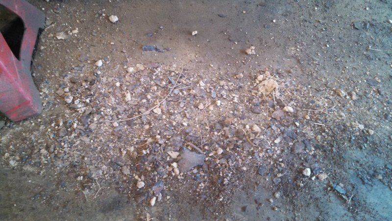

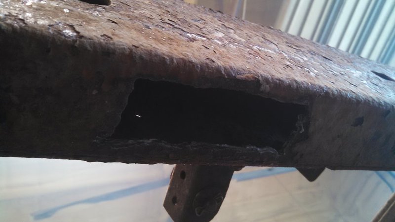

    There was so much dirt and pieces of the frame inside..

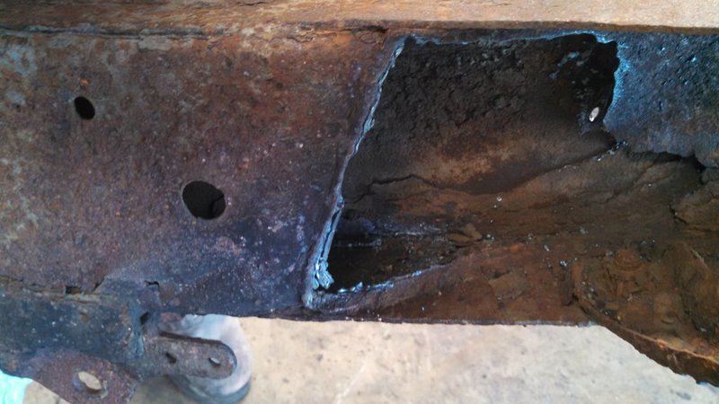

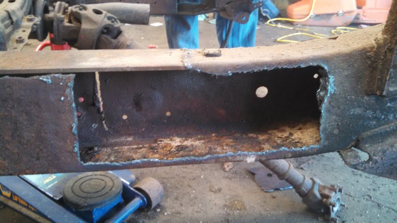

    All the damage.

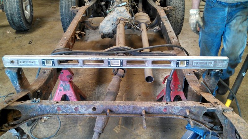

    In the process, somehow something moved but we got it all back and level again
    Forgot the port-a-power so we improvised.

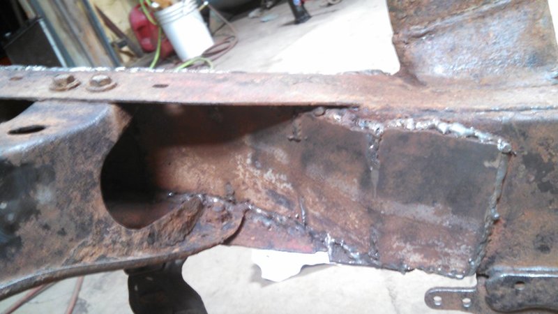

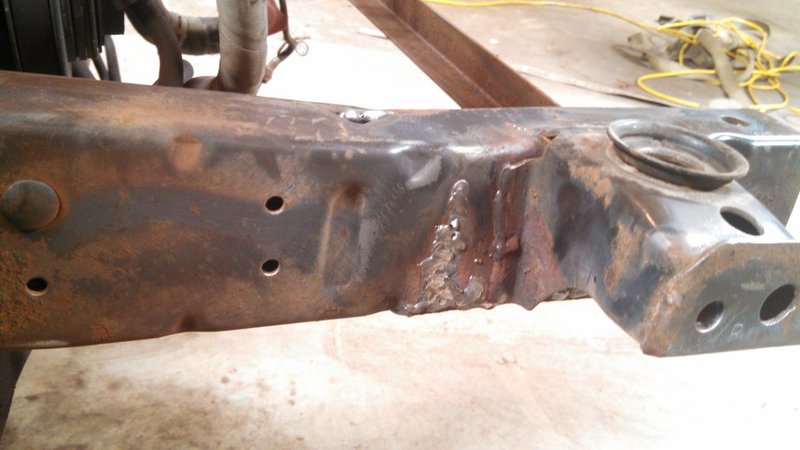

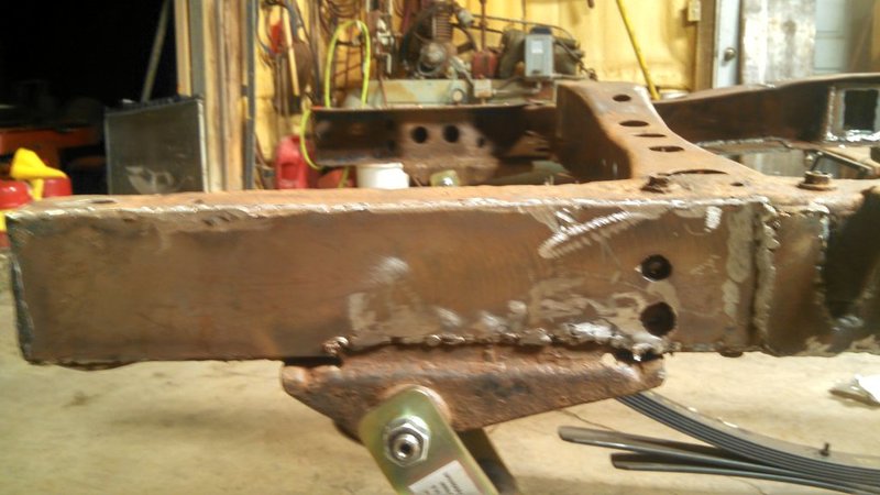

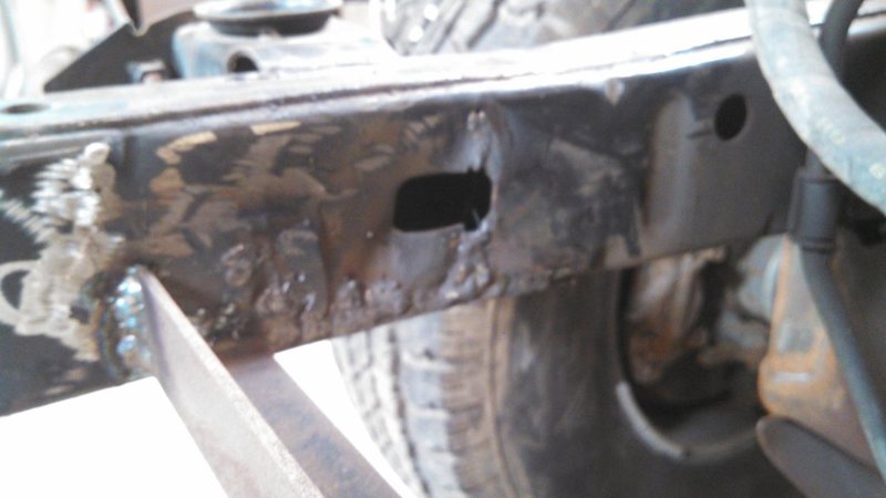

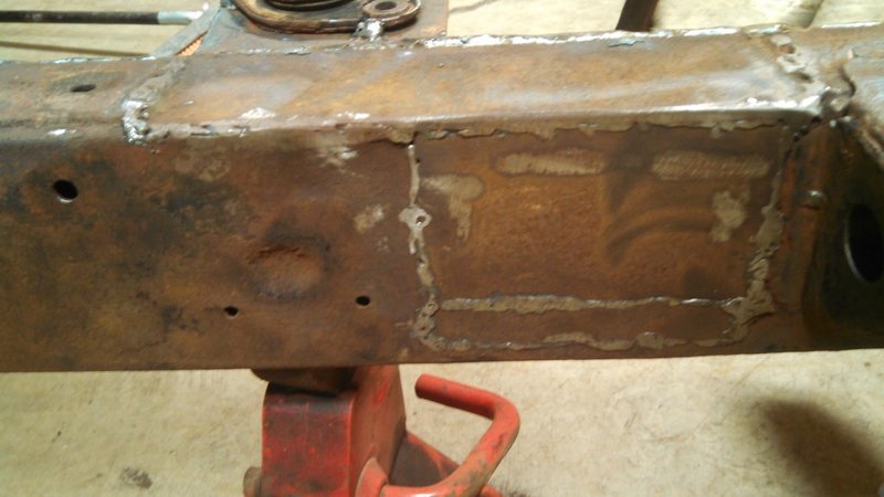

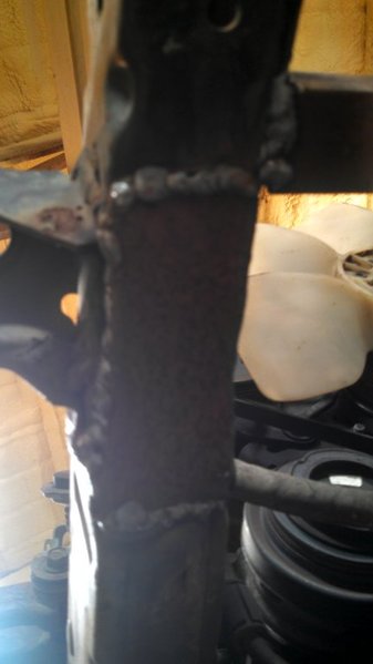

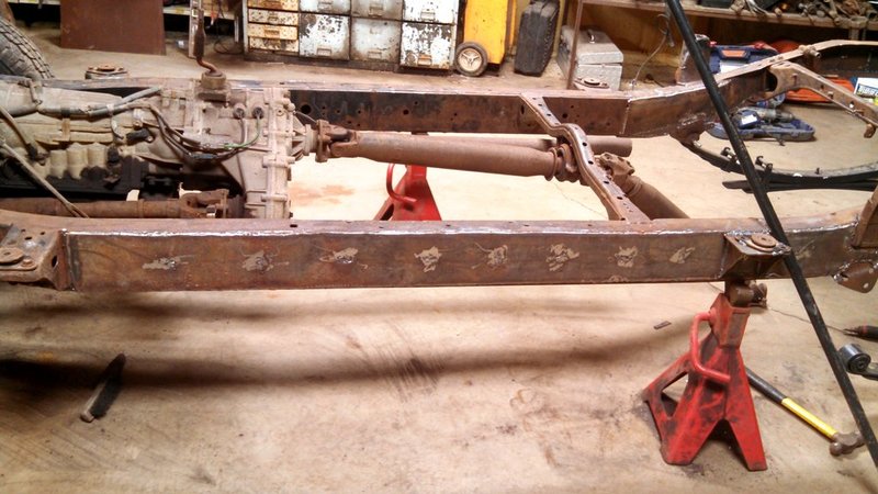

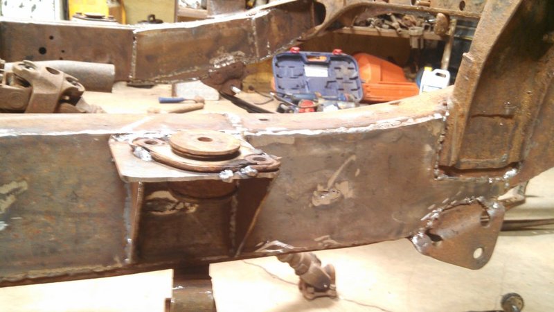

    Then it was time to start patching and plating
    Fab'd up a new cab mount.
    All plated and ready for paint!

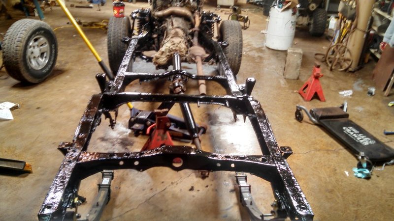

    First coat of chassis saver.

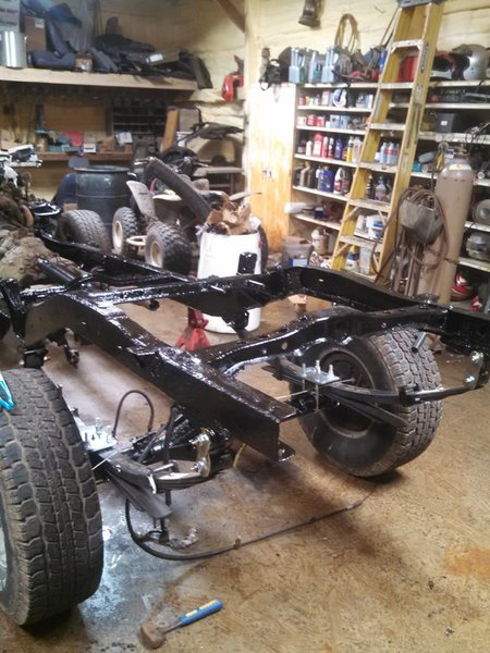

    Final coat.

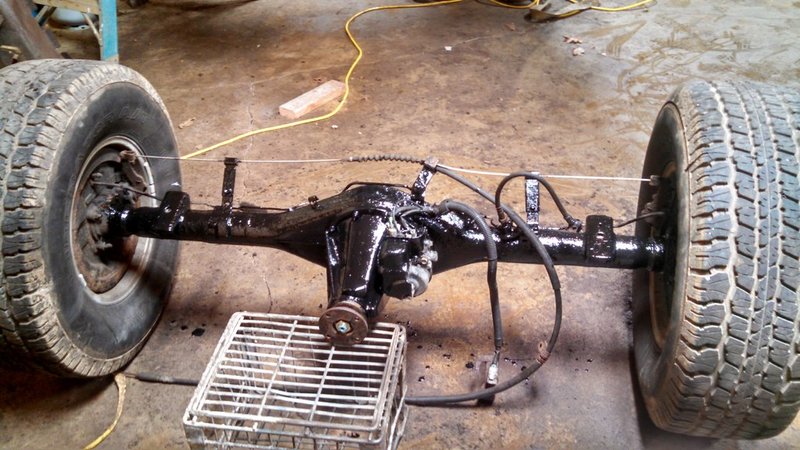

    Painted the diff as well.
    Now its time to start working on the cab to get it ready for paint. We have to do some body work and finish sanding. As well as start sanding on the doors, fenders, and bed.

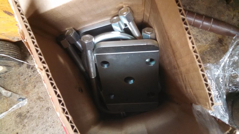

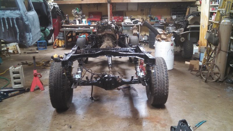

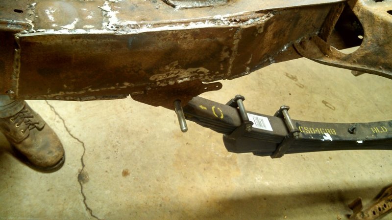

    Toytec u bolt flip kit came in.
    Got the rear axle back under it. Its setting about 4 inches high, hopefully it goes down when we get everything back on.

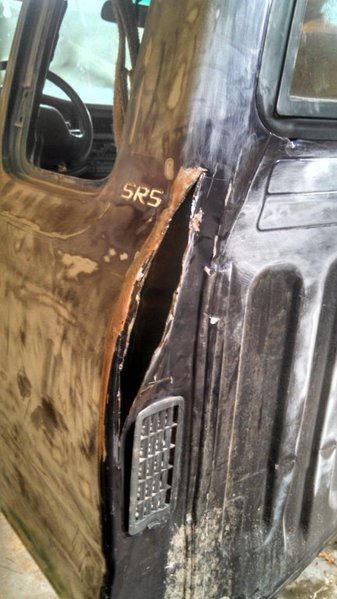

    Fixed the big dent on the back of the cab. Its not perfect but we will fill it in with body puddy.

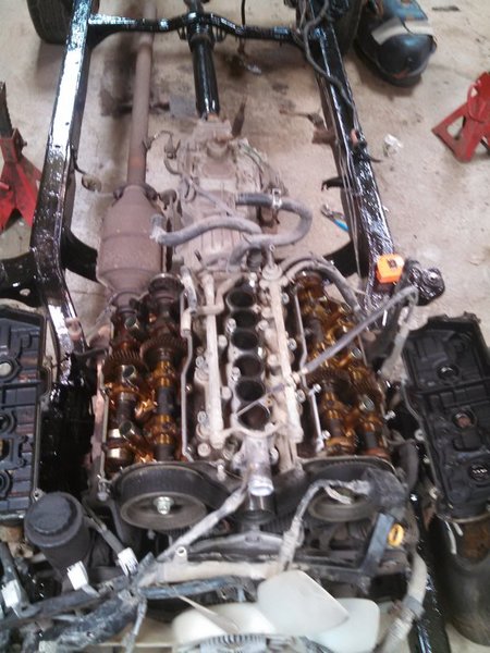

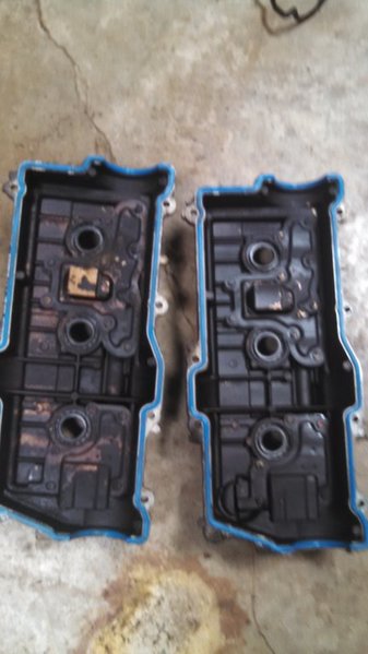

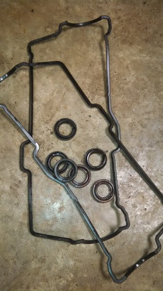

    Valve cover gasket replaced.
    old stuff

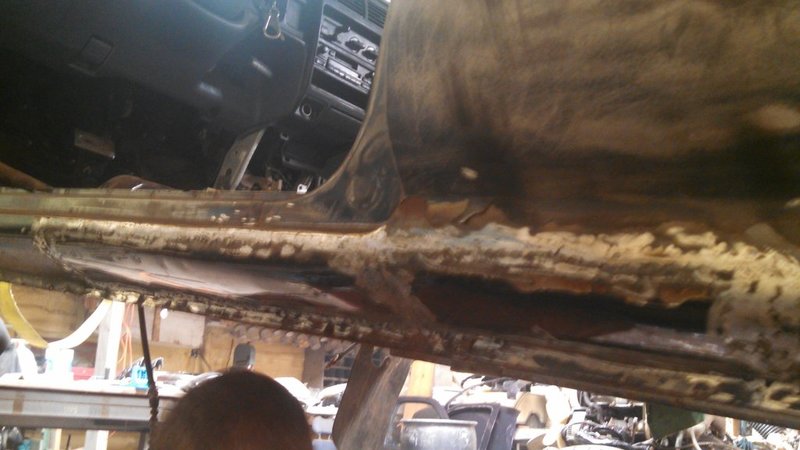

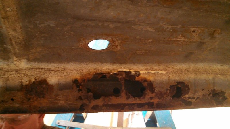

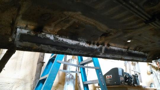

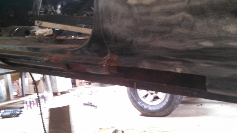

    While I was doing that my dad was fixing all the rust beneath the drivers side door.
    Had to cut out sheet metal from the old bed and shaped them to fit. Didn't come out too bad...
    The intake manifold and throttle body was caked with oil on the inside. Anyone have an idea how to clean it out?

    I can't wait to see this thing when you're done! Hopefully the rear settles lower because that shackle angle looks pretty bad

    Ya I figured that the shackle angle was not good. Hopefully ounces everything is on it will. Its only suppose to give 2.25-2.5 inches I thought. I need to figure out what to do with the intake manifold so I can put it back on.

    Brake or carb cleaner? You can pull the whole piece off of the block and just clean it right?

    I think I might let it set in seaform or something

    With no weight on the frame they'll sit up. once the cab and bed get put on it will still be up a little but not that much
    you can just spray it down with carb/TB cleaner and let it sit. it's mostly carbon/varnish buildup. the cam rollers looked a little darker too but that could be from it sitting. maybe after an oil change or two they'll look better

    :thumbsup: will have to let it set in some stuff see what it does. Now I can't let that stuff set in the intake manifold that is bolted in the block still can I?

    no, it will soak down into the block, probably not a good idea :)
