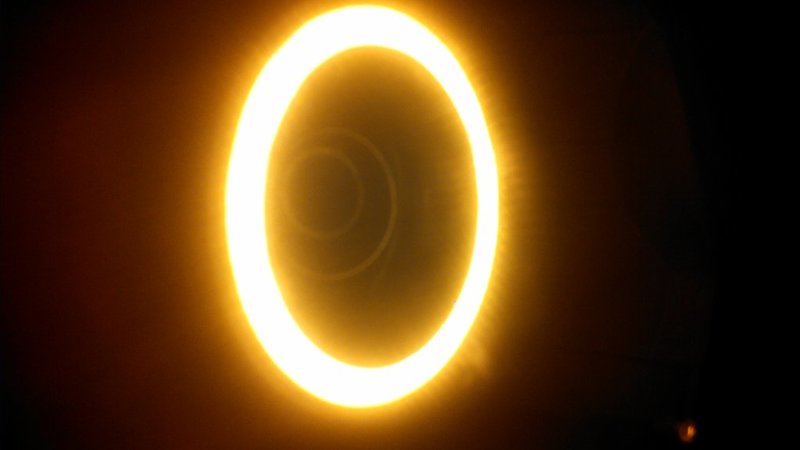

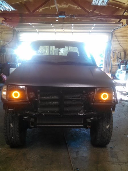

    Got my retrofit done! Came out great! There so bright! Drove it a couple more times and noticed when you put it in drive it takes like 5 seconds for it to go into first and it bucks when it does. Is it cause the rear end is still too high?
    Got the mesh cut out for my satoshi and got it primed also.
    Pics of everything coming soon!

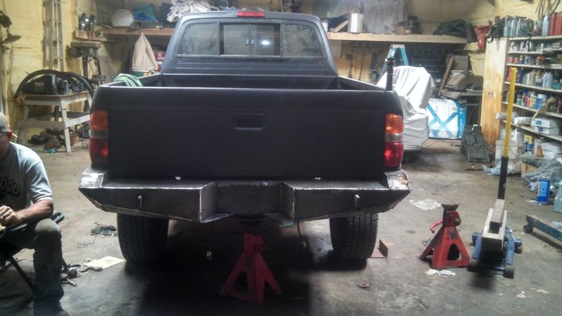

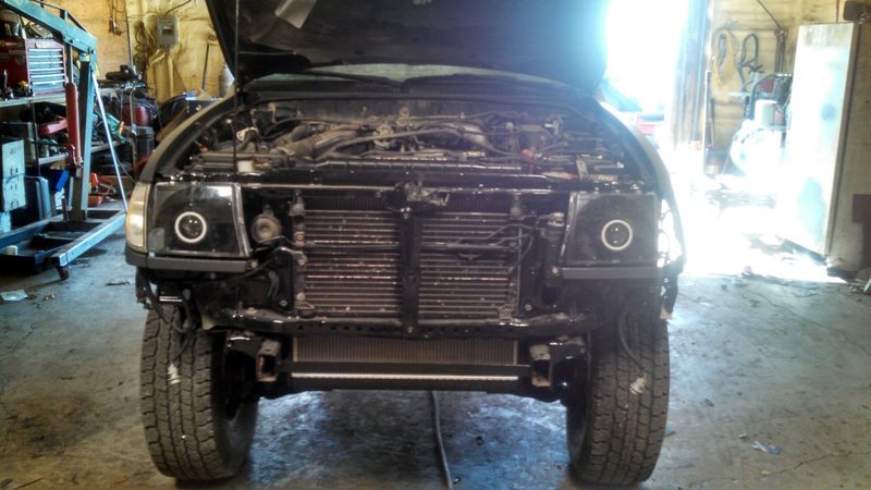

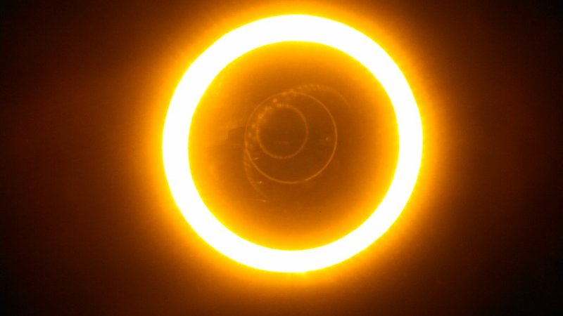

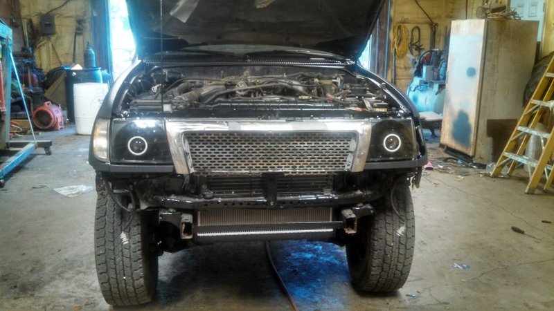

    Finish the retrofit. You cant even compare them to stock, its unreal how bright they are.
    H1 kit with gatling gun shroud painted with krylon fusion and amber halos. All from theretrofitsource.com

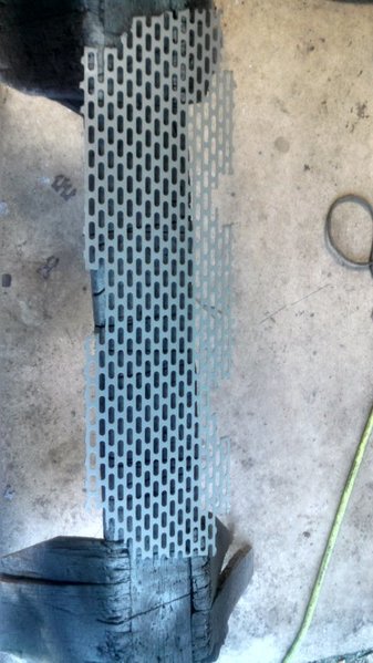

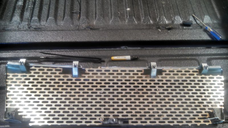

    Started fitting the mesh into the grill.
    Here it is just sitting on the truck. Nothing is attached yet.
    Primed

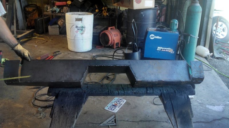

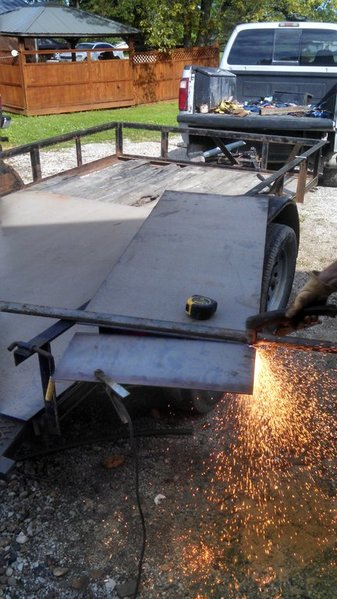

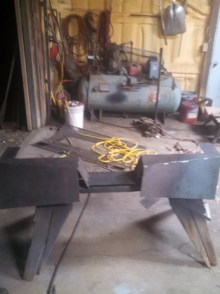

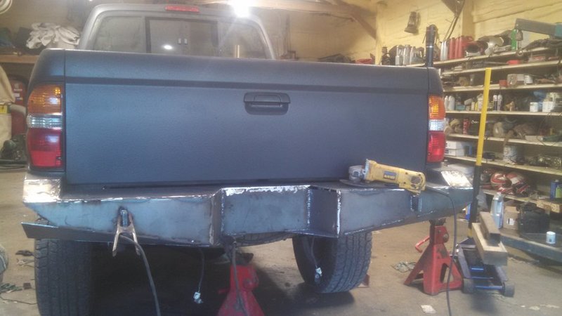

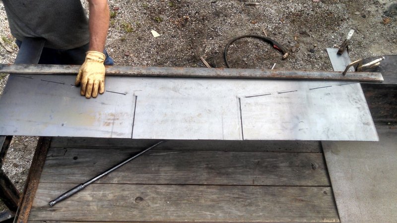

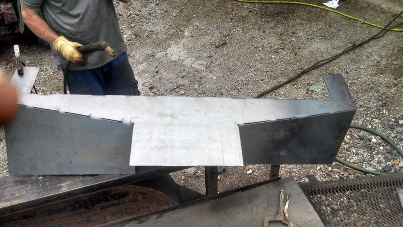

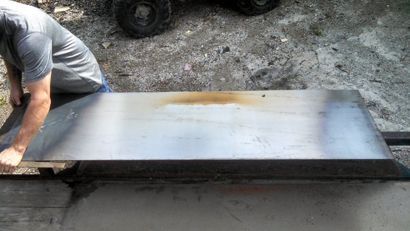

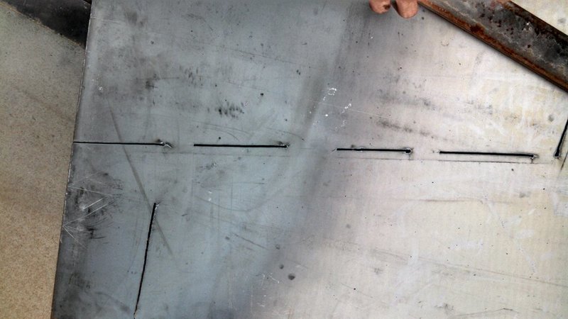

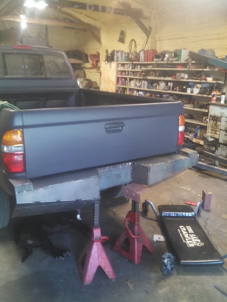

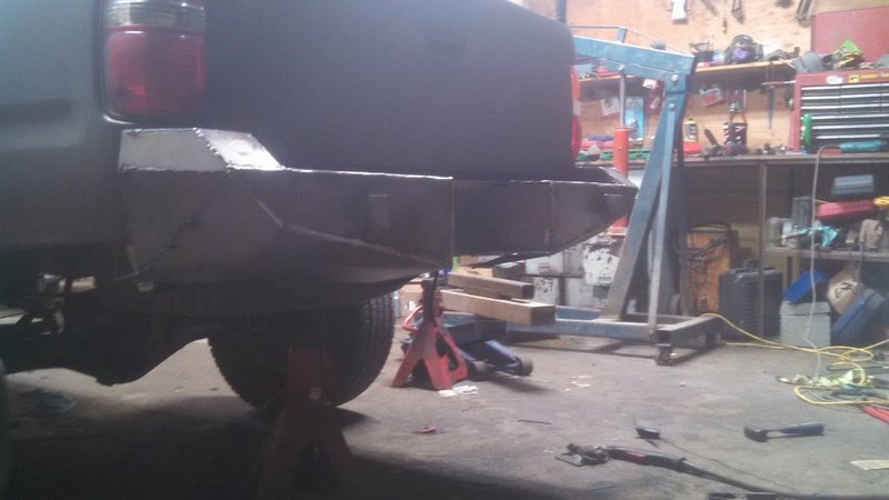

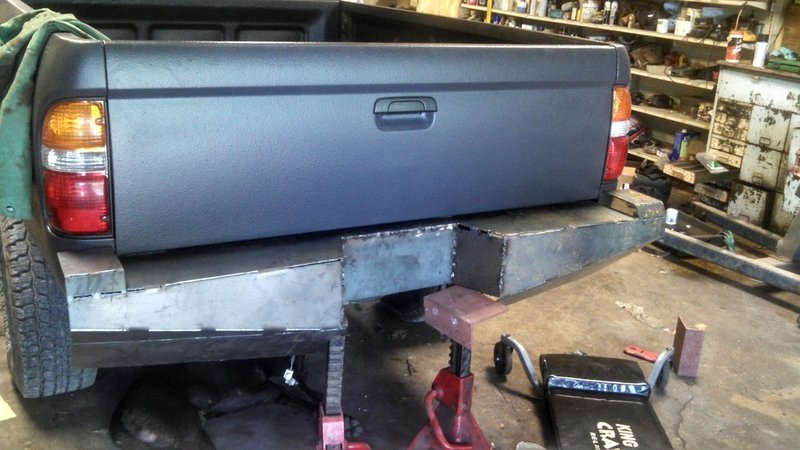

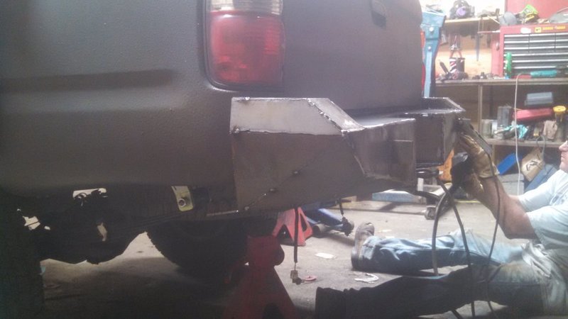

    Then it was on to the rear plate bumper. Using 1/8" thick steel.
    cut slots so we could bend it.

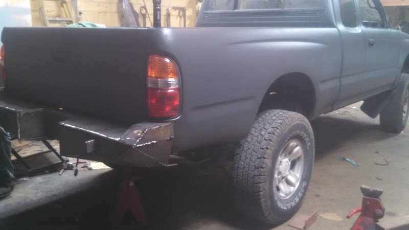

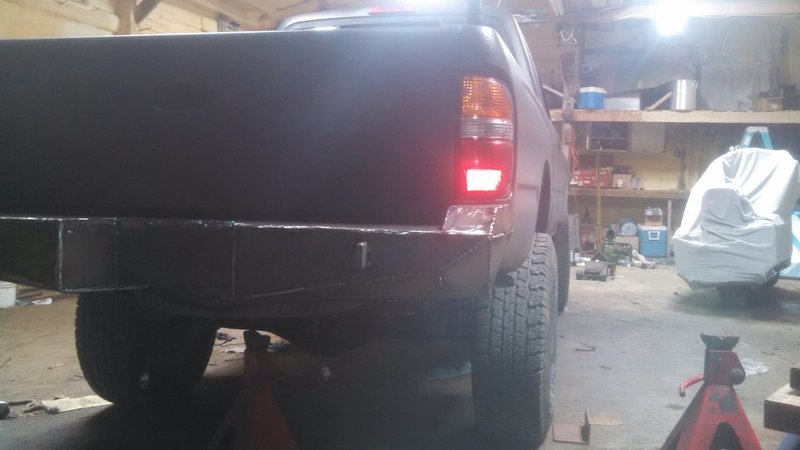

    The rear and front bumper are now ready to be primed then painted, my mom and dad helped me out to get some 16" SCS F-5 3.5bs in gun metal gray and some cooper discover st maxx 255/85/16! So excited wheels should be here by Monday tires should be around that time as wheel. Couldn't get the bilstien 5165 so went ahead and ordered some 13" Icon 2.0 from downsouth motorsports that where shipped today. Pics of progress will be soon.

    I got the LEDs off of superbrightleds.com. there 194 bulbs. Make sure you got the 360° ones. You need 4 for my dash. You just have to get the guage cluster out and you take the stock bulbs out from the back and pop the LEDs in. Make sure you test them before you put it back together if you doesn't work you just turn it around.
    I bought the retro kit off of the retrofit source. It the h1 kit. I got the Gatling gun shrouds and amber halos. There the halos you can run amber constantly. You put the headlight in the oven then pry the lens off. Take all the stuff out so you just have the reflector bowl, then I painted it with krylon fusion satin black. Then there is directions on theretrofitsource.com how to install the projectors.
