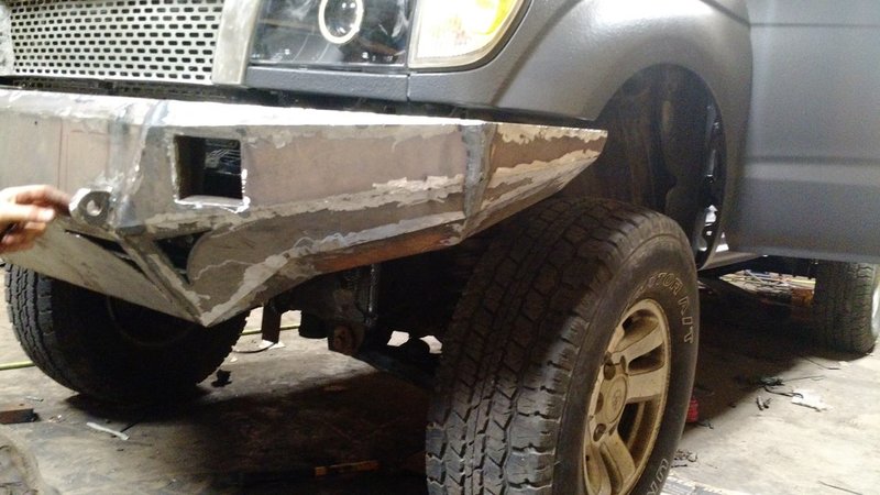

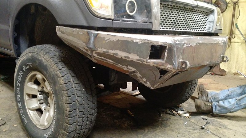

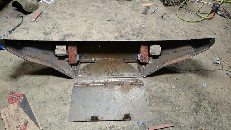

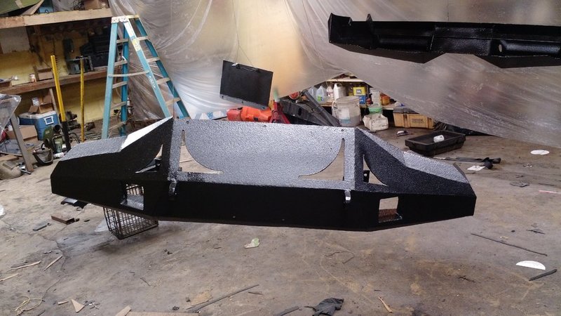

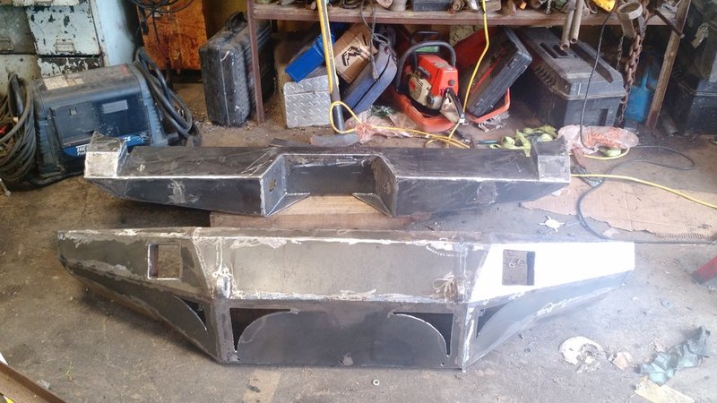

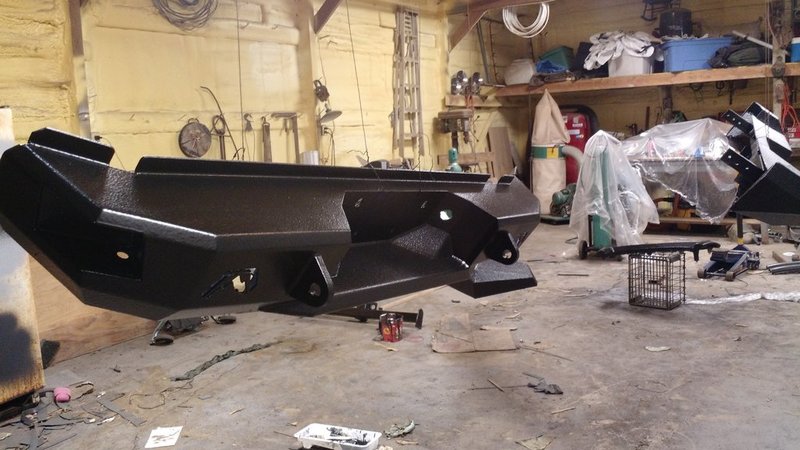

    Front bumper is done!

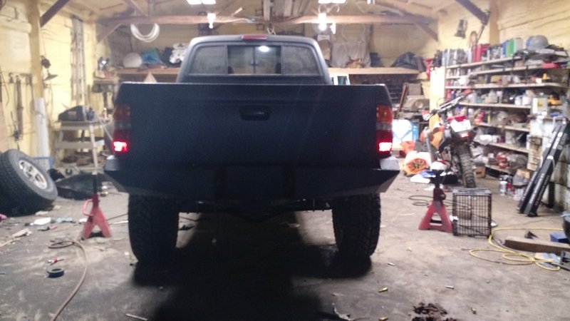

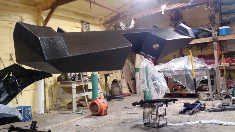

    Rear bumper with monstaliner.
    also did my dads rear bumper for his f-250.

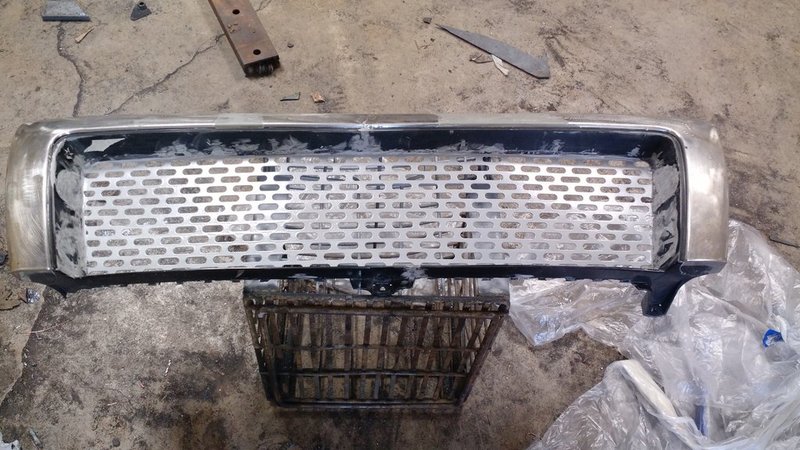

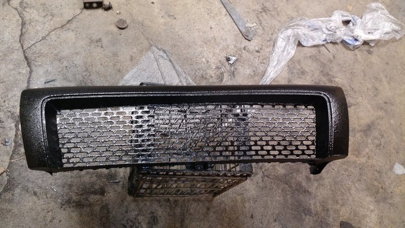

    Grill is done. Went ahead and just monstalined the whole thing. Primed the stainless with the 2k primer and used bulldog adhesion promoter for the rest.

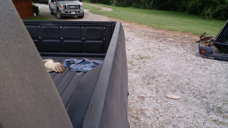

    Tape the bed rails of again and rolled some black on to hide the white line. That away the black is over the gray instead of the other way around.

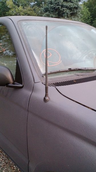

    Got a new antenna from walmart

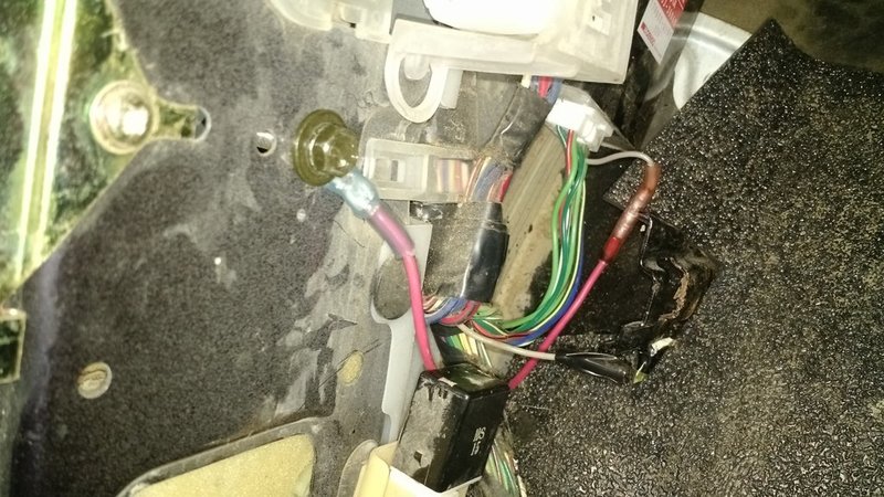

    Gray wire mod. Found out the locker wont engage, so im going to have to tear into it some day.

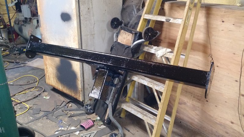

    Put chassis saver on the receiver that came with the truck. We rolled some monstaliner on the part that you will see.

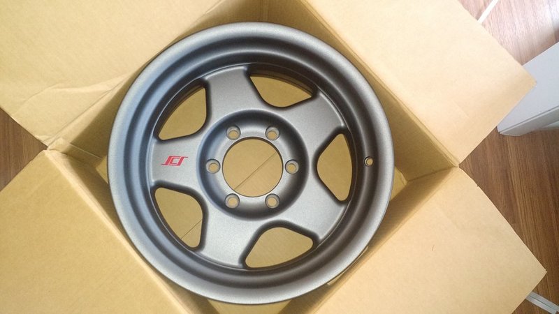

    And these came in today:D
    16x8 SCS F-5 3.5"BS gun metal gray
    Shocks should be here by wednesday. Then that night hopefully everything is back on the truck and we can make the shock mounts. Then its off to get the tires and wheels mounted and an alignment.

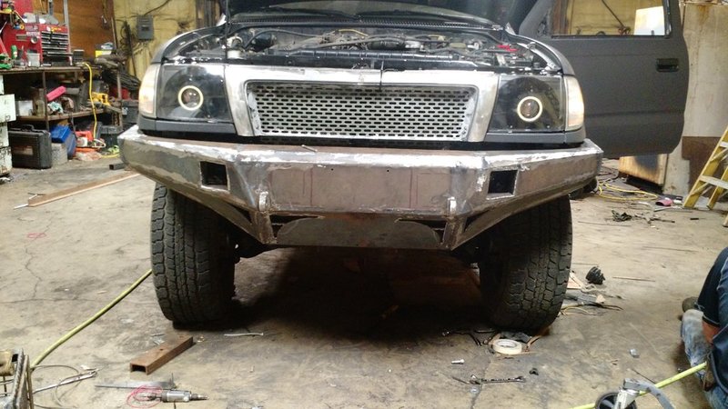

    Truck is looking great! Look forward to when everything is all together.
    Front bumper sorta look like an elite offroad one. Looks good.

    Ya i think it came out pretty good. The only thing i don't like is the gap between the bottom of grill and headlights and the top of the bumper. It wasn't so big but when we took it off the grind everything and then mounted it again it seemed to drop like 1/2 inch. But oh well. In a month i won't even notice it. lol

    How did you mount the bumper?
    The two screw mounts on the side of the frame?

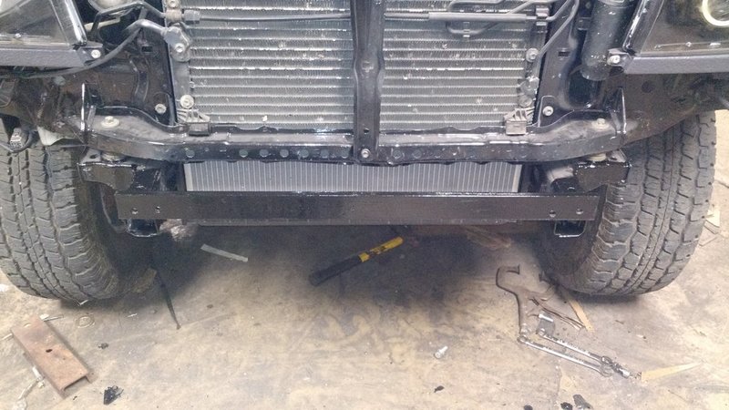

    We welded this to the frame and welded nuts to the back of it.

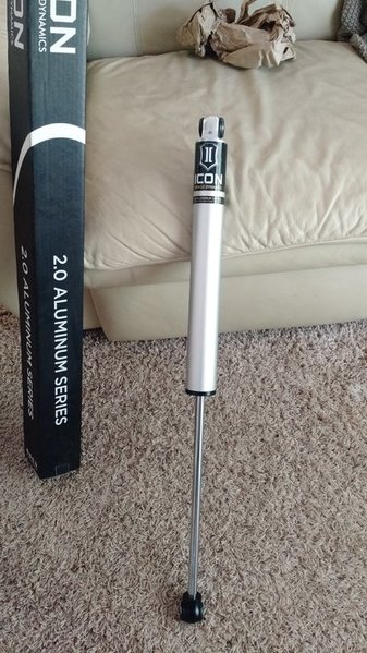

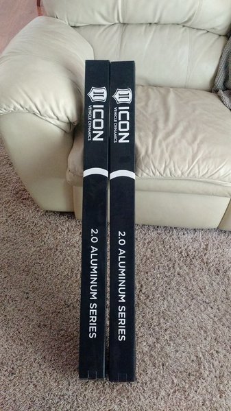

    Just got the shocks in! Now off to my dads to get the mounts fab'd up.

    curious how much the 4 icon shocks cost? in general numbers , the chasis paint I know 1/4 is 39.99 a gallon 99.99 but with all work you did , how many gallons to paint all over those places you already did ?.... is great product but pricy... then in youtube someone did the whole winter protection with chassis paint 1/4 , mixted and spraying... don't think is the same protection diluted.

    Well the front icons I bought off a member for 700. The rears were 315 new. Honestly I don't even think we used a whole gallon of chassis saver for the frame. Once you get the first coat on the stuff spreads really easy, we put it on too thick in places and there is air bubbles in the paint. It sucks in moisture to cure, and when its too thick tiny air bubbles form. Suppose to do light thin coats. As of today we have used just over a gallon of chassis saver. That's painting the frame, backside of fenders, underside of bed, underside of cab, front of truck, and bumper brackets, all three coats.

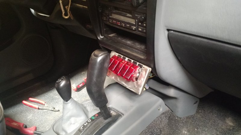

    so got the shock mounts fabbed up, they came out pretty good.
    SCS F-5s and 255/85/16 cooper st maxxs! Love them!
    compared to 31x10.5-15
    Switch panel is done
    Truck is all put together (minus rear fender flares)
    Coverking tactical seat covers came in.
    Sticker collection
    So the rebuild is pretty much over, just in time as i move in for college on Thursday. After i put the tires on i took it for a short drive and we found out the driver side inner tie rod was toast, and there is a hole in the steering rack boot... So those will be fixed tmrw and it get an alignment tomorrow. And for the transmission problem i made a thread on here and people said it seems to be having a hard time picking up fluid so we checked and its full, so im going to drop the pan and check the filter/screen to see if its clogged or something. Also found out that it could be bucking hard going into drive or reverse because of the throttle body cable needs adjusted (makes since because we did have all that stuff apart). so i will be doing that as well as changing oil in diff and transfer case and the motor oil. As well as install my seat covers. Order the rest of the clips i need for rear fender flares...hopefully they get here before i leave...probably not though.
