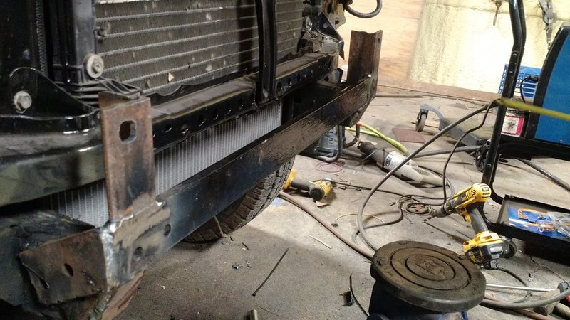

    Like under the recall or buy a new one? I don't think Toyota would have gave us a new frame since it had a salvage title. I think I new one was like 4k looking off of one of the OEM parts websites. But steel, a welder, plasma cutter, paint, and time did the trick

    Oh ya! Forgot to add that, cut apart the mount and raised it up. Looks 20 times better.

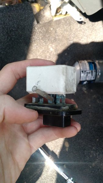

    Been busy with school but was able to fix the hvac fan. The resistor was junk. Also had a blown fuse for the 12v outlets. Got the rear fender on and did the deck plate mod.
    Here is a pic of the resistor

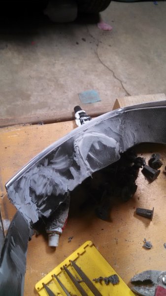

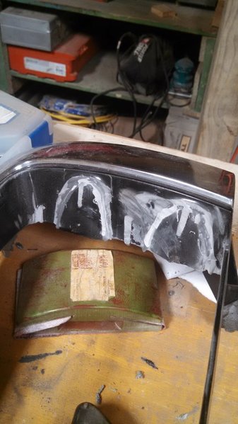

    Since I've had some questions on how I did my grill I made a small write up. Wish I would have took more pictures.
    Here is how I made it...
    I used stainless mesh that came off semi truck stacks...
    I got the center part of the gril out, then cut out pieces of plastic from it, and jb welded then in there to fill the holes. Sanded it all smooth.
    Then I sit the mesh behind it and jb welded it to the grill. The bedliner helped hide the un eveness of the jb weld.
    Here is it with the bedliner
    Did scuff up the chrome some for the bedliner and the stainless, sprayed the plastic with bulldog adhesion promoter per monstaline instructions
