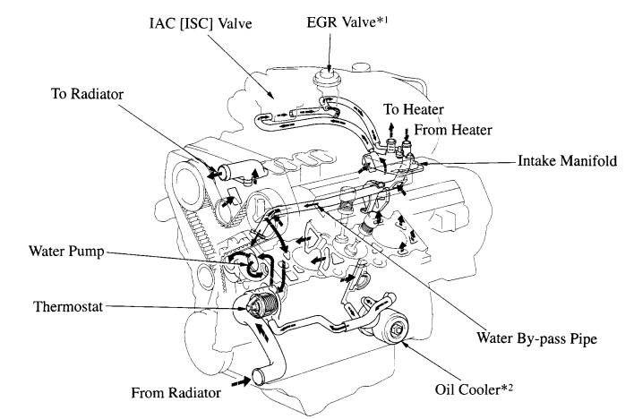

    What did you use for water lines on your turbo?

    Did you tap into those lines running to what is labeled as the iac valve? Then did you just return it on the other side? What did you use to tape into it?

    Yes. You can cut the lines and use like a 2 way nipple and hose clamps, or just take it right off the oe locations. Hose clamp it to those. I'll have to look at mine to make sure. Remind me and I will. Vaccum got me too at first but it's pretty simple. You'll reroute your fpr hose to the manifold on front where it is capped off. The cap will face you. Just below that cap is the fpr hose. This increases your fuel pressure as you boost. You'll need a 3/8 inch check valve. $2 on ebay. The back right of the manifold is where you will tap into for boost reference. I'll send you some pics too later. Also you will drop your front different to install the turbo oil drain.

    I use Norprene tubing with 1/8" wall thickness. Resistant to everything but kinks easy and tears easy so be careful. I forgot the ID I'm using. In fact, now that I think about it, I might have some left over. I'll check on it.
    Look at your TB, there are coolant lines running to it to keep it from freezing over (some people in the southern states remove this to keep from heating the intake air).
    I removed the lines from the block to rear of the TB and ran it from block to heat exchanger (used a small trans fluid cooler) to the turbo to the TB. I didn't touch the coolant return line from the TB.
