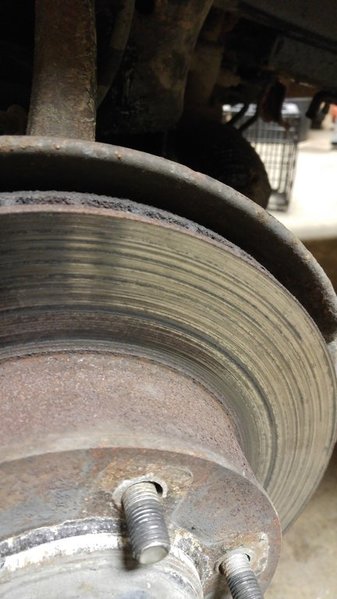

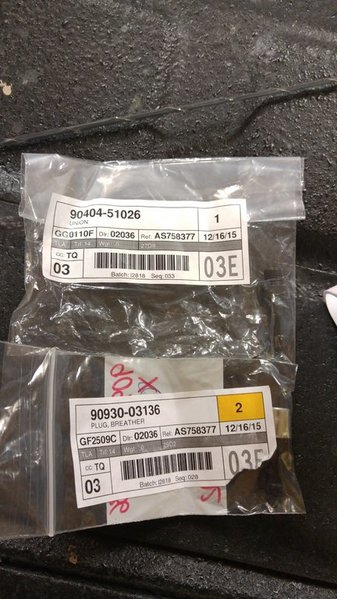

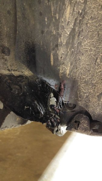

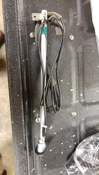

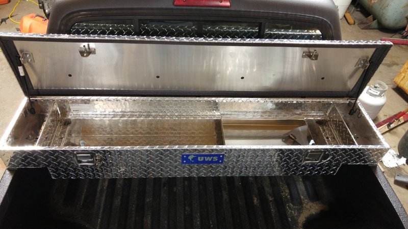

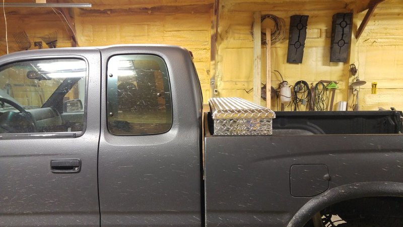

  15. Jan 9, 2016 at 7:49 PM
    #175
    gray223
    gray223 [OP] Well-Known Member
    Nov 6, 2013
    #116062
    3,439
    SE Missouri
    2014 Tundra Limited

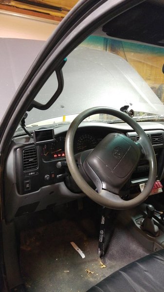

    Got a bunch of things done this past week...

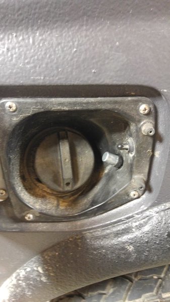

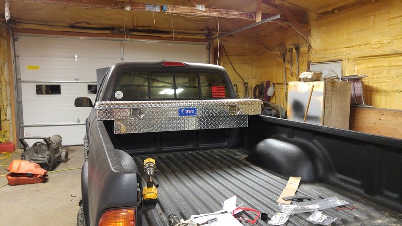

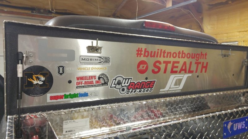

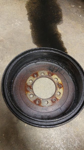

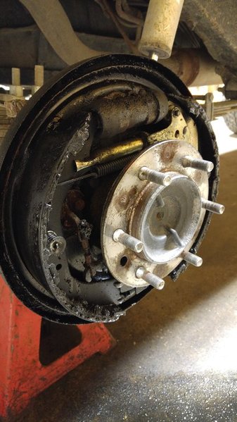

    Replaced my carrier bearing, old one was shot

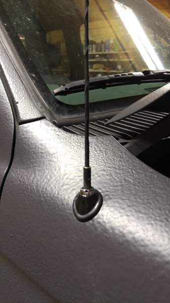

    replaced walmart antenna with OEM

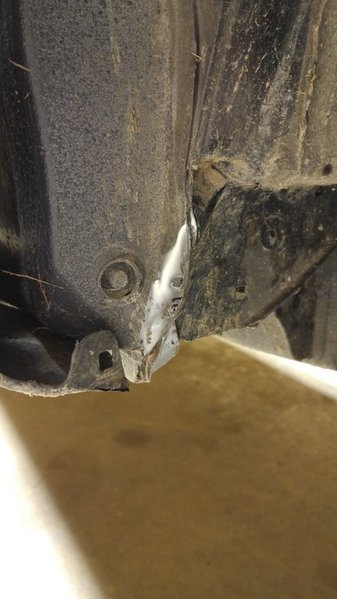

    Beat in pinch weld
    Replaced steering rack boot

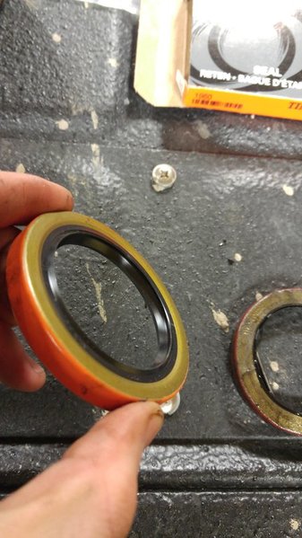

    Replaced rear axle seal
    old - Looks like whoever put it in there had no idea what he was doing
    new
    mounted ulta guage
    mounted my uws toolbox I got for Christmas
    good place for all my stickers
    rear diff breather mod

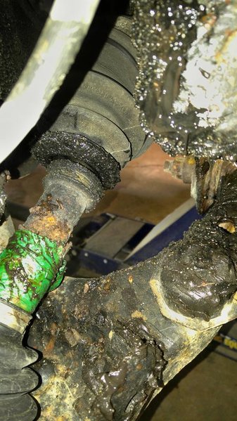

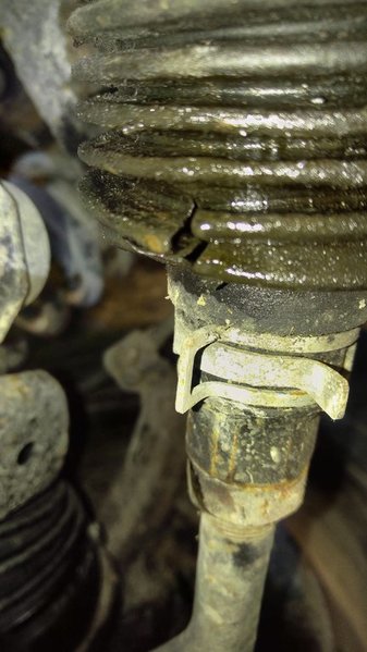

    found out booth cv inner boots are junk

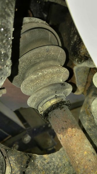

    front dics are shot, they both look like this. Getting tundra breaks next.
    Also took off my elocker to try to fix it and it was not salvagable. Made a plate to cover the whole in the diff. I'll post pics of it soon.
    tacomatrd22, JonEvans56 and j0shu4 like this.
