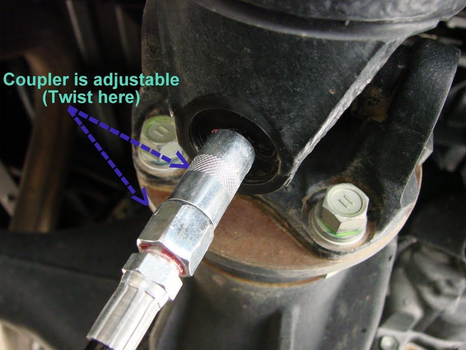

    Very true. Yesterday I was greasing a bolt, hence no zerk and needed the grease to come out. :D
    Also for the OP, here is a pic of the coupler. Notice it twists onto the zerk fitting. and twist off when done pumping grease.
    If it ain't tight, grease will just come out the coupler end, and make a mess. :)

    Shauncho
    Shauncho Embrace your inner Bro-ness
    Sep 19, 2012
    #87284
    4,510
    Shaun
    Parts Unknown...
    none
    what i've found that works when greasing UCAs, connect hose to zerk, rest canister on your tire, hold canister against tire with your forearm while your hand of the same arm holds the hose on the zerk, then use the free hand to pump the handle with care. you want control on the pumping hand because you don't want to over-grease your UCAs.

    #35
    Thomas Jefferson
    Thomas Jefferson Keyboard Warrior
    Jul 8, 2013
    #107851
    1,291
    Sacramento,CA
    '13 SR5 DCSB 4x4
    One can never have too many light bars.
    Holy shit I never knew those were adjustable I just shoved them on and pulled them off. Mind Blown!

    lol
    You aren't the first person to say that after I've shown that pic. And yeah, if you can't untwist the coupler because it's greasy, just pull it right off! Heh!
