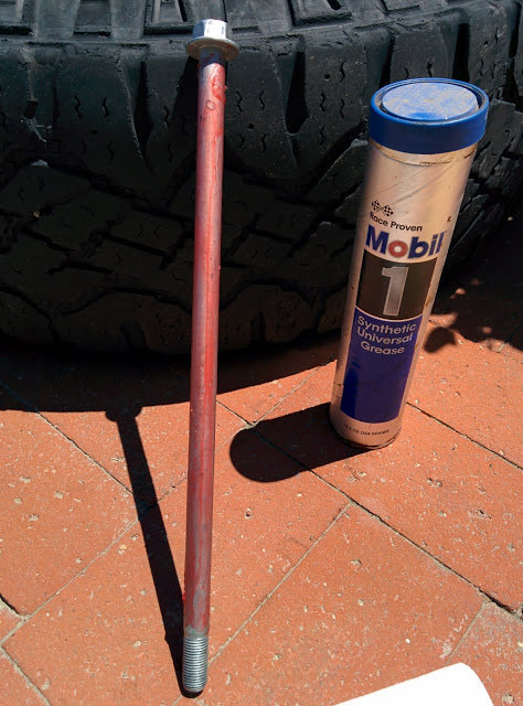

    Should I grease around all the washers of the UCA's as well?

    If you got stock UCA's there is nothing to do.
    Putting grease there wont help, and at worst, if you use a petroleum based grease it will promote decomposition of the rubber bushing.
    If you ever get around to pulling your UCA bolts out, grease em'. Helps them withstand corrosion much longer.

    Installing Camburg Ball Joint UCA's Saturday with new UCA bolts. So I should grease the entire bolt as well

    And on a side note of overgreasing your UCAs: I overgreased when I installed mine. I stopped immediately when I noticed that one of the bushings started to bulge, but it was already too late. It ended up being a simple fix though: unbolt the zerk and loosen the UCA bolt. Then just massage and rotate the bushing back and forth and it will push the grease back out the opening for the zerk. Wipe away all the excess with paper towels or you'll have a greasy mess on your hands (literally and figuratively). Then put the zerk back you you're golden.

    I would grease the UCA bolt, but follow the Camburg directions and do whatever they say for their product.
    If you're up to it, I strongly recommend you grease your LCA bolts and cams before they rust to the bushings.
