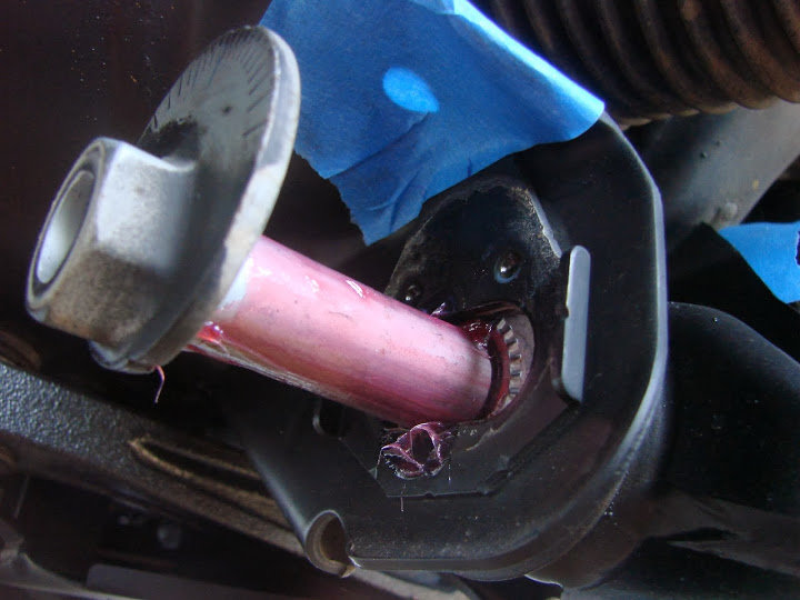

    ^this. @Crom just did his, see his thread. Apparently you don't even have to jack the truck to pull them. Just make sure to mark the bolts before you take them out to get your alignment back. I'm planning on doing mine this weekend as a preventative measure.
  9. Nov 12, 2015 at 4:27 PM
    #69
    Crom
    Crom Super-Deluxe Member
    Jun 22, 2009
    #18782
    9,648
    Nick
    San Diego, CA
    2009 4x4 DCSB Camp Supreme
    Millions
    THIS
    Grease will save your truck.
    This picture was taken two years ago:
    I pulled the cams and bolts out yesterday and it looked almost like it was done a few days prior. Everything was in great shape.
    Here is what they looked like with yesterday after cleaning the old grease off:

    I have at least one seized cam

    Do the alignment cams first
  19. Nov 12, 2015 at 4:41 PM
    #79
    Unchained 5150
    Unchained 5150 [OP] Rick
    Sep 25, 2014
    #139054
    65,355
    Rick
    Auburn Ma
    2021 TRD Poser Pro Manual.
    So have him mark them, take them out and grease them. Than align it?
  20. Nov 12, 2015 at 4:43 PM
    #80
    OZ-T
    OZ-T I hate my neighbour
    Dec 15, 2009
    #27584
    50,587
    Peter North
    British Columbia
    No need to mark them if you do it right before an alignment , you do that if you are doing it without wanting to have to get it re-aligned
