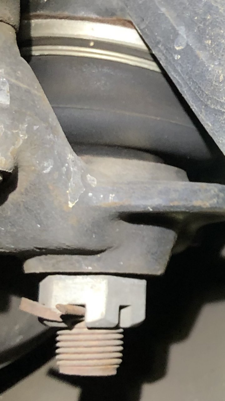

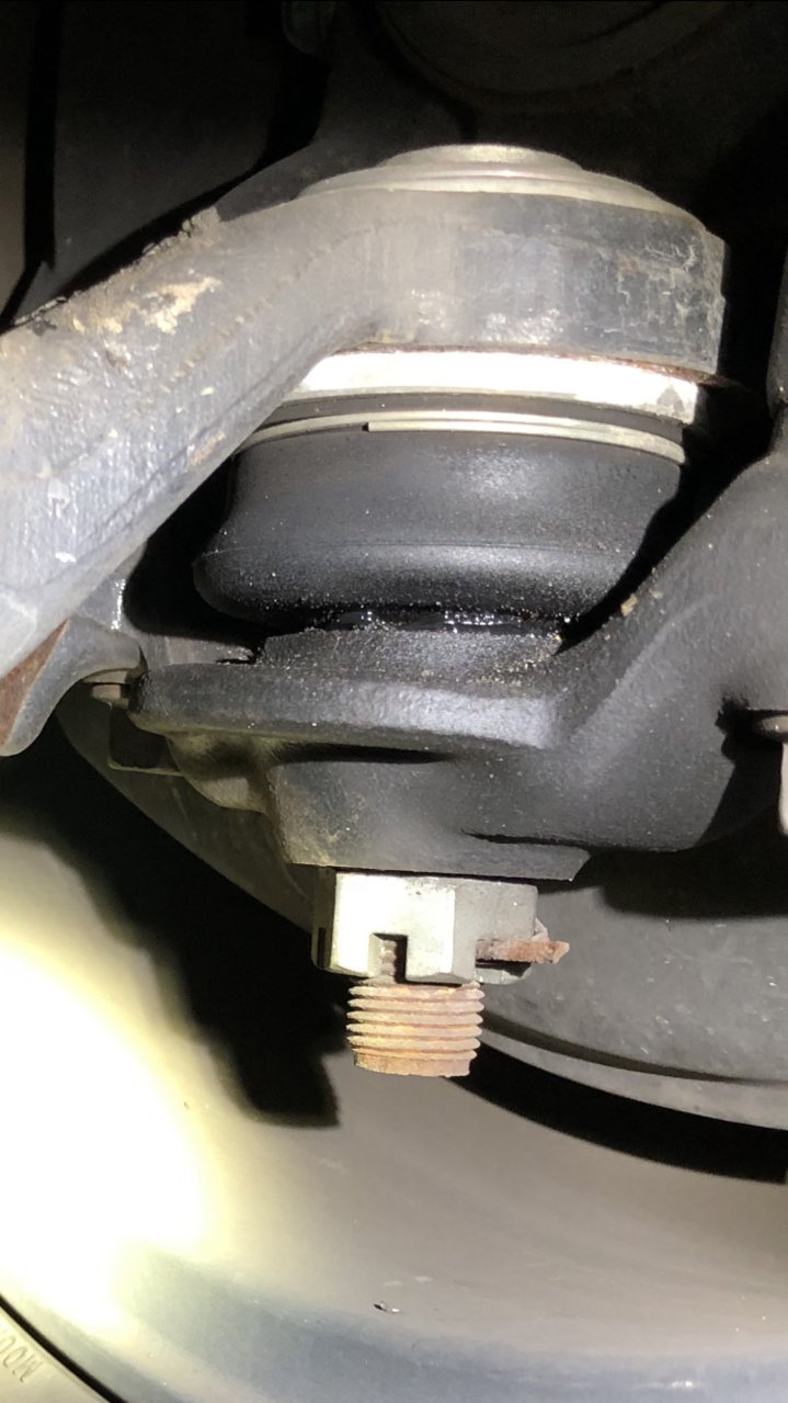

    How big of a problem is this?
    the other side seems to be dry

    Not that big of a deal right now, eventually when all the grease leaks out the ball joint will be metal on metal and wear out. Keep an eye on it, if your under warranty have them replace it now.

    I have this on both of my lower ball joints, I just wiped it off and just keep driving. No problems yet.

    you will once all the grease leaks out
