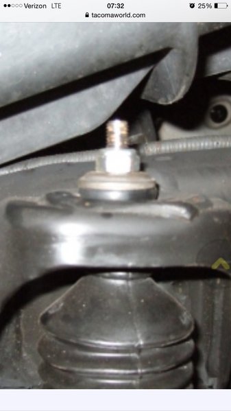

    On another note I'm going to jack my own thread for a moment and ask you guys a question. I have searched and have found nothing. I just put rear billy 5100 on the other day and want to know where is a good medium to tighten the top nut? I know the specs say 20 lbs but there is really no way to gauge that. Once you start tightening the nut the resistance feels the same until you bottom the bushing out which I know is not right. As of right now I have about 1/4 or a little more of the threads showing on the top and stopped there because the bushing and washer are around about the same diameter if that makes sense. The bushing isn't smashed and the washer isn't just over hanging the bushing. Does this look about right as a good medium for the rear shock tightening or do I need to back off just a tad?
