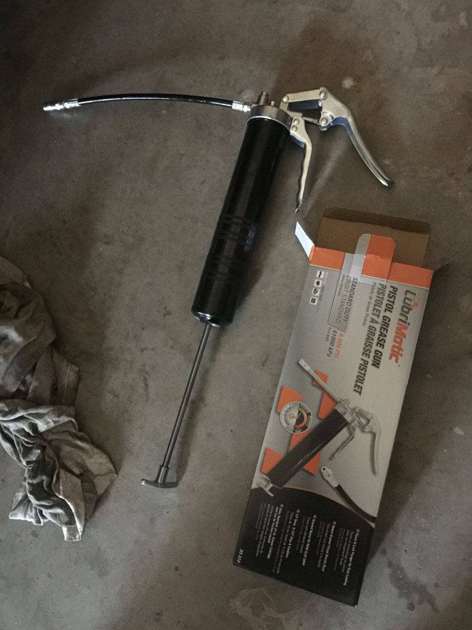

    Best money I've ever spent. Doesn't fit on the front shaft zerks, but it actually WORKS on the UCA.

    This is what I used and worked without removing the shield. It was tight angle to fit the zerk for sure.

    This^.
    I've got the same grease gun and have zero issues reaching all the zerks.
