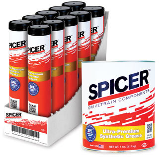

    From what I’m aware spicer has made Toyota u joints for a long time. In terms of grease, I’ve always just used valvoline synthetic lithium grease. I’ve never had a u joint fail/issues in a combined half million miles between my 1st, 2nd, and 3rd gens. My simple theory is keep them greased up, and don’t abuse your truck.

    JFYI, Spicer grease is a calcium sulfonate base grease. It's good shit and totally compatible with lithium base grease. I think Redline has a calcium sulfonate base grease as well.
    Stocklocker[QUOTED] and Paul631 like this.

    I work for a Tier 1 Toyota supplier and have access to some of their specs online. There are several approved brands, but after looking at most of them, that seems to be the magic black stuff.
    Stocklocker[QUOTED] likes this.
