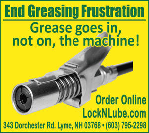

    This costs $40 Canadian, my grease gun was like $20, but it's the best thing I've bought for greasing. Works so damn good! You won't regret buying one
    I've used it on old grease fittings that wouldn't take grease and it worked perfect. Nothing more frustrating than trying to hold the end of a grease gun on a fitting only to have grease shit out all around fitting. Makes my blood boil

    Does it fit in the front driveshaft? I have one and it's huge compared to the end that comes on the gun.
    If used properly the standard tip doesn't have to be held in place.
