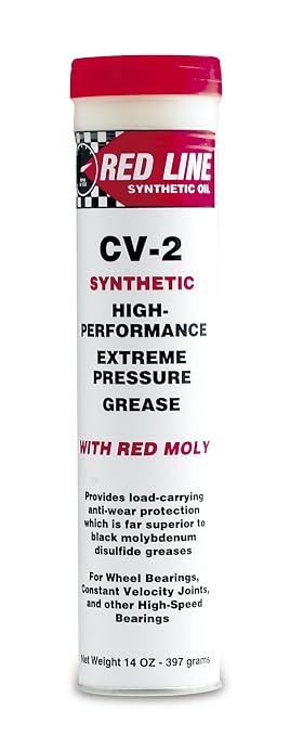

    Im down with CV2 [​IMG]

  17. Mar 3, 2017 at 6:02 AM
    #17
    Scott B.
    Scott B. Well-Known Member
    Nov 11, 2014
    #142118
    4,476
    Scott
    Georgia
    2015 ACLB SR5 4x4 Expo
    I just switched to this stuff. Comes highly recommended.
