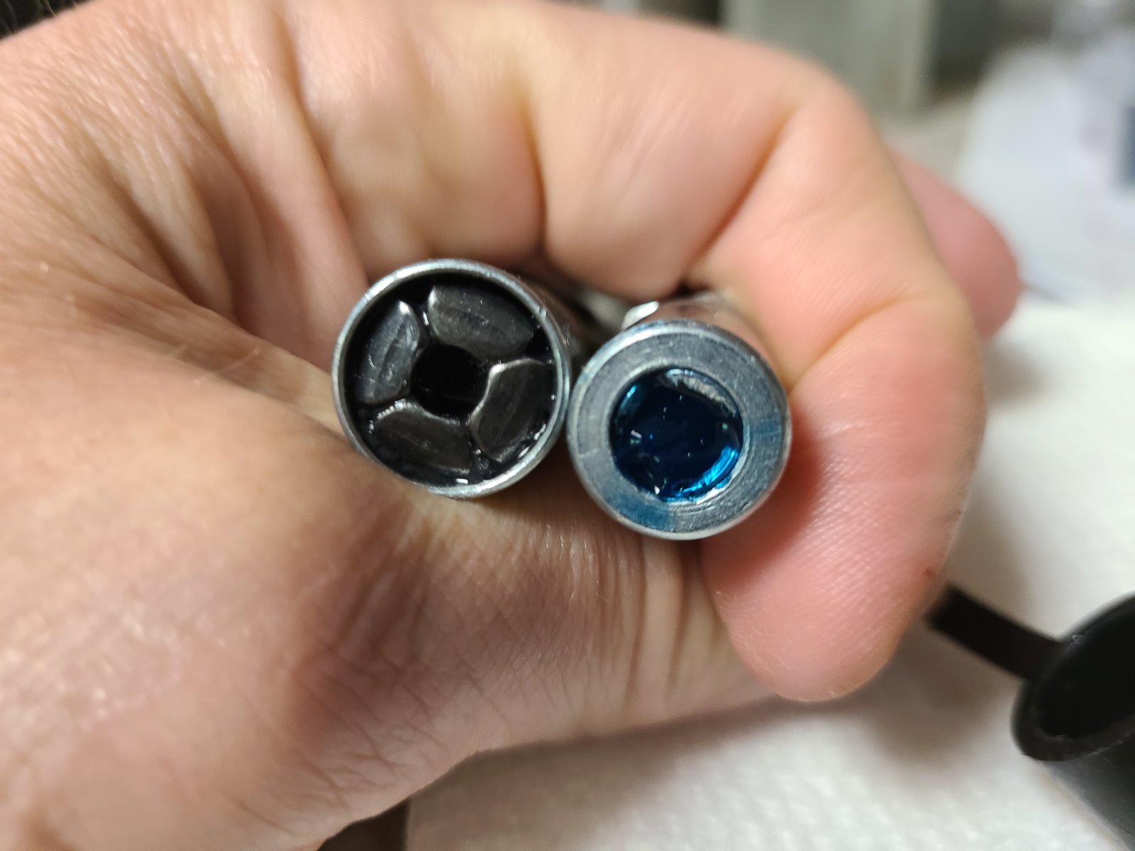

    Does anyone know if a LockNLube grease gun coupler will fit on the zerks in the U-joints? It's a tight space, but I hate the standard screw on coupler that came with my grease gun. The LockNLube coupler looks a little thicker than a standard one. Is there enough space to fit it in the U-joint and lock it on properly?

    No, in my very recent experience, the LockNLube will not fit. They're just a little too large in diameter, both the long and short LockNLube..
    Lincoln on the right, LockNLube on left.

    That's unfortunate. I just looked up the specs, and it's only about 1mm larger than standard, but I guess it's a tight enough fit that it doesn't work. I remember barely having enough room to use a standard coupler, so I'm not surprised.
    Does anyone make a long version of a standard coupler? I don't mean a standard coupler on the end of a rigid extension, but something along the lines of the LockNLube XL where the threaded coupler itself is longer.

    Yea, it's so close.
    It's not the first time I've run into spaces where that extra 1mm on the LockNLube rendered it useless.
    I got tired of switching out couplers and just ordered a Lincoln gun.
    I needed two guns for two greases anyway.
    The coupler that comes on the Lincoln is effortless on these zerks, fwiw.
