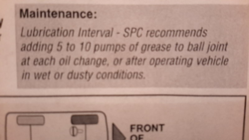

    Which grease are you guys using? SPC seems pretty specific about what kind of grease, but I can't find a tube anywhere that matches their recommendation.

    Super lube, synthetic grease

    Lucas Red n Tacky will do just fine. Was doing an install and I pumped grease in til it come out the bottom of the boot, bit I did that before I attached it to the spindle. I personally would fill the BJ up until grease did come out. It should have a relief on it somewhere. Maybe contact SPC tech support for their recommendation.

    Any auto parts store will have a moly grease in stock 14oz tubes

    OK installed LR UCAs yesterday, 10 pumps grease each, i could feel it going into the boot. The manual calls for 5 to 10 pumps at oil change intervals. Wouldn't that be too much? Would the boot swell, or is there a seal that the old grease is pushed out / purged from? Don't want to bulge out my boot, afraid of damaging these ucas, hoping for them to last a long time as they were not cheap
