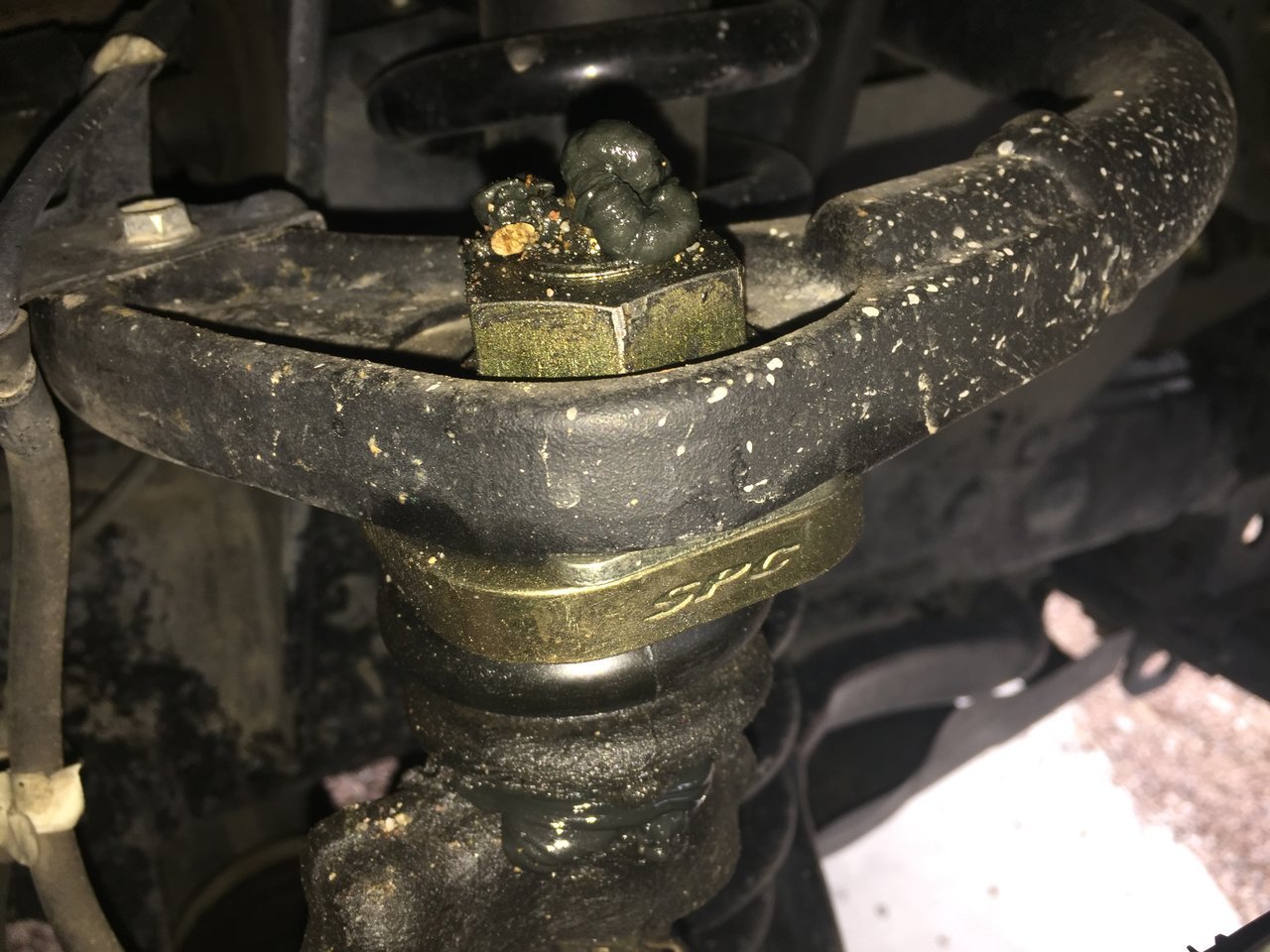

    Did I over-grease mine or is there something seriously wrong here? I put 5-7 pumps every ~6000 miles (have maybe 25k miles on these UCAs). Just noticed this the other day - grease had oozed out near the zerk and below the boot. Makes me think I've just put too much in. Everything seems to be functioning properly...

  13. Mar 11, 2018 at 11:15 AM
    #33
    eon_blue
    Mar 4, 2016
    #180213
    69,853
    Azusa, CA
    Mine do the same thing, have been for the past year and a half that I've had them on. I used to worry about it but the old grease has to go somewhere. I just make sure to clean it up whenever I add a couple more pumps every few thousand miles.
    Edit: mine only have grease coming out of the bottom of the boot, not the top of the zerk...that's a little odd, probably way too much grease in there.

  14. Mar 11, 2018 at 2:47 PM

    Cool thanks for the reply. I did notice a few months ago that one of the zerks was loose. Tightened it of course, but could be why it leaked out the zerk

    Because you didn't have the zirk fitting, that's attached to the grease gun hose, on the zirk properly. I've greased a metric F ton of zirks and it'll do that if it's not on properly. It's pretty much a one way ball valve that doesn't allow grease to push back out if too full. It'll come out of the boot if it gets too full, which you don't want, either. 5-10 pumps with Moly each oil change. Very, very simple.

    This has nothing to do with the actual greasing of the zerk... the hose fitting fits fine. When I finished greasing everything was fine - no grease leaking. It was about 1000 mi after the greasing that I noticed this leak... I agree that oil should not come out of the zerk tip, but the actual threads of the zerk itself may be loose, as I had previously observed.

    That makes sense. It wasn't explained that way earlier. Hopefully that post will help others. Thanks.
