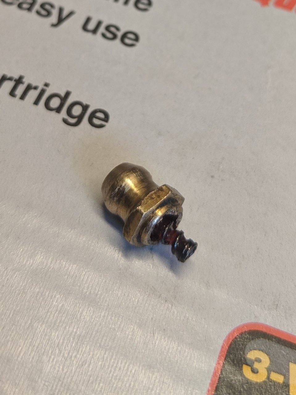

    Did this break off or just simply come off because it was loose? Trying to screw it back on and it isn't catching. I'm thinking it snapped. Greasing the joints today and it popped off when I was removing the gun. They came out way easier than the normal pressure to remove the gun.
    If this is broken off, will the grease stay in the uca or is it messed up and grease gonna spew out.

    It's broken off, you need to get the rest of it out before you can screw a new one in.
    I guess you may have over torqued it or maybe it was defective, like had a crack or weak, from the manufacturer.
    Grease is going to make a mess as it's pushed back out.

    Shit. They both snapped off. I had never torqued these bad boys and this was the first time I second time I ever greased em

    They snapped off when pulling the grease gun off? If so then my guess is they were over-torqued when they were assembled, if I remember correctly the zerk fitting came assembled on the ball joint from SPC so it must have happened during production. That sucks, zerk fittings are easy to replace but since that one snapped off you'll have to find a way to get the rest of it out.

    These are only about two years old. I'm pretty pissed right now. Pulled straight up on these like I do with other zerks. I wonder if @HeadStrong Off-Road has ever had complaints like this

    Yep just broke right off. Now to brainstorm. Indeed grease is coming out after taking it around the block
