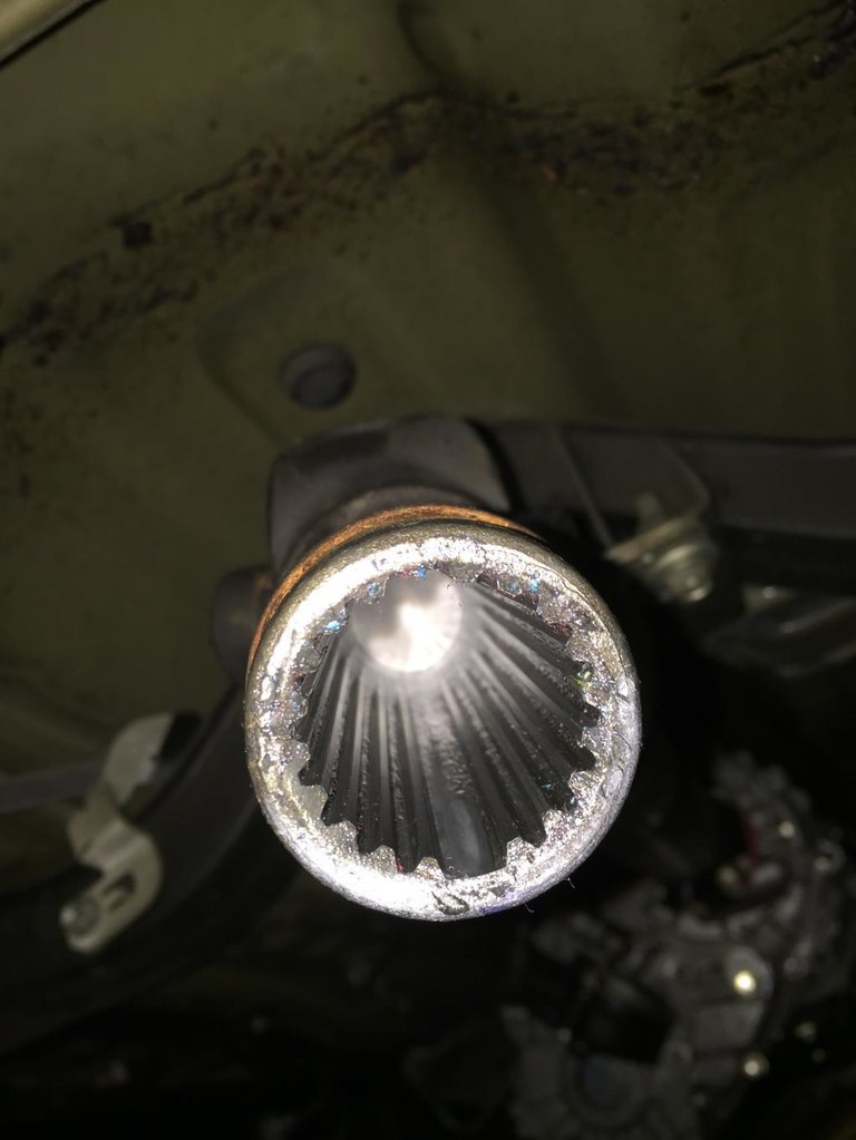

    As far as turning it 90*, it doesn't seem to want to go.
    The female side is indexed. You can see where it looks like there's a spline missing on the bottom:

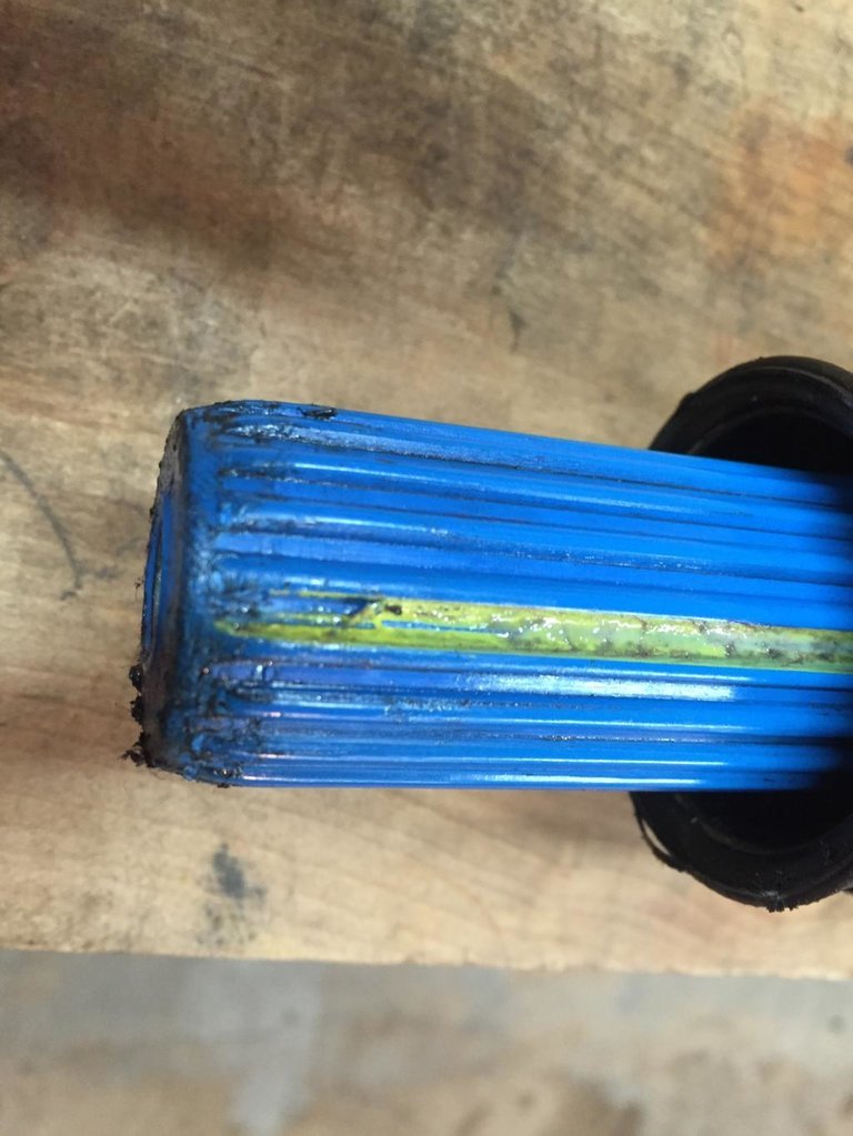

    FB40219F-51FC-4F46-85E0-C424A99CDD87_zps_7bf8e00edd349d0002f914a47ff4b5ef2bf3889c.jpg
    The splines on the male side all appear to be the same. However, if I tried to slide it together any other way than with the yellow mark on the male side matching up with the index on the female side, it wouldn't go. You can see in the pic, that it started to chip the rubber coating off by trying to force it a little. That's when I gave up.
    A7262B18-DA6E-482A-A576-4350F9292F42_zps_dedde905f82c44d9effe80a04eaec6c500e7c1f9.jpg

    That joint is pretty tight tolerances , spray lube will not penetrate far enough to be effective . When I get time in the spring , mine's getting a damned zerk installed...

    Fyi you should be able to drop the center carrier bearing to pull the slip joint apart rather than unbolting the driveshaft from the pinion.
    and thanks for seeing if you can rotate it. It doesn't look like the teeth on the male side are spread apart any differently which strikes me as odd why it can't be put together differently. But then why would they have that indexing gap on the female. Who knows!

    You're right. Maybe I just couldn't get it? Although, it slid right back in the original position.

    That shaft is master splined for a reason . Usually to keep guys from accidently re-assembling the driveshaft out of phase

    ^^^ This. Most of the time when one gets installed out of phase it leads to massive vibration and binding problems.
