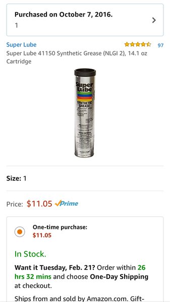

    I'm also curious as to what is considered the "best" grease for ujoints.

    Any bearing and chassis grease will be fine if applied at appropriate intervals. I use Valvoline Crimson. I grease the front every 5k miles and the rear every 2.5k miles. What you do with your truck determines how often you need to grease. Wheeling in mud and water requires more greasing, as does heavy towing and hard wheeling - when compared to daily on road driving.
