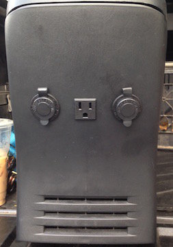

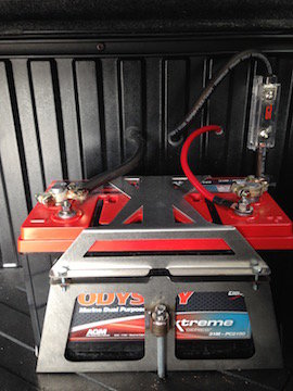

    Odyssey Group 31 in a Pelfreybilt SS cage thru-bolted to the bed behind passenger. 0 gauge power cable, 100 amp fuse top right, cables run through grommets for dust/water control. On the right, 12v, 110, and USB plugs in the back of center console.

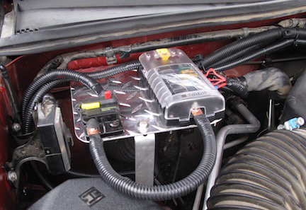

    Blue Sea fuse block and fully loomed cables. I have to take the dubious credit for the redneck diamond plate aluminum mounting bracket.

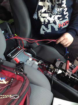

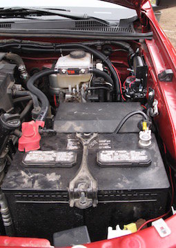

    Nice clean battery area, clean installation of the National Luna control module, far right, and a 100 amp fuse attached to the brake fluid reservoir. Glad it wasn't me wiring up the center console. I'd have buggered it for sure!
