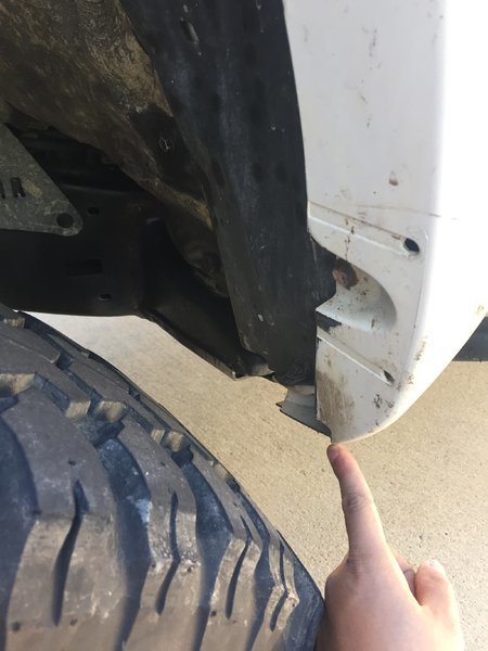

    My fenders are minimally trimmed. But I think it was because i put the tires after an alignment, and didn't get realigned. It was rubbing just a little bit. I also thought I needed a cab mount chop, but now I don't think so.

    where did you trim? I'm fine with trimming inside on the front or back of wheel well. but I've read if you push 255s out, you need to trim the actual fender flare. did you trim the fender flare or just inside the well? do you have a pic of what you trimmed? sorry for all the questions bro. I'm just on the fence with 255 or not. lol

    Thanks bro :thumbsup: 255s gonna be my next tire. Think cepek extreme country mt

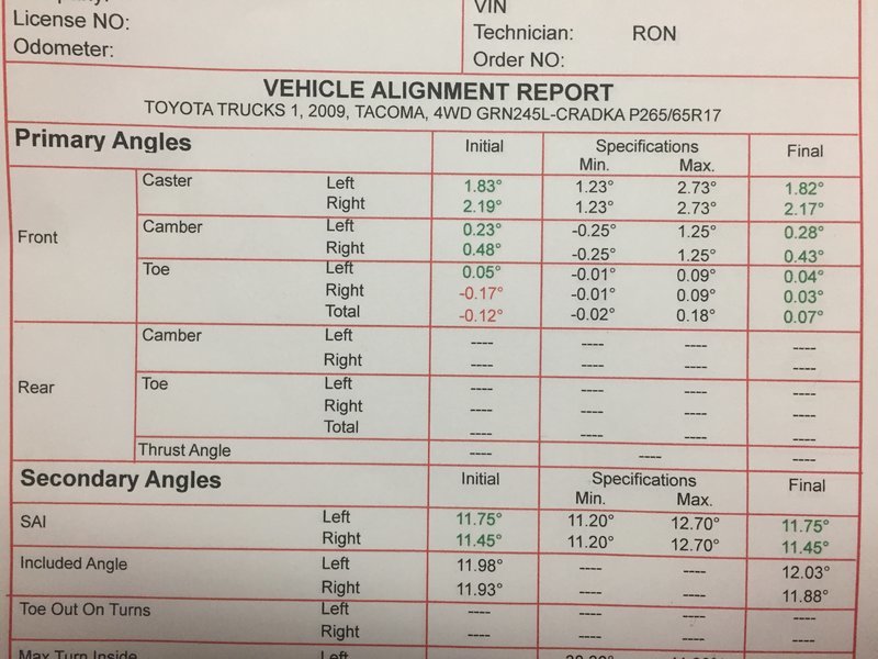

    The most recent alignment specs

    Not bad...needs more caster

    Just getting started
    Yeah I agree. Bring it back and get at least 2.5 caster and 0.0 toe and camber. I've had to be persistent when I had alignments done.

    I don't get how people don't at least set the toe to 0.0 before taking it off the rack. Really no excuse for it, its only one adjustment
