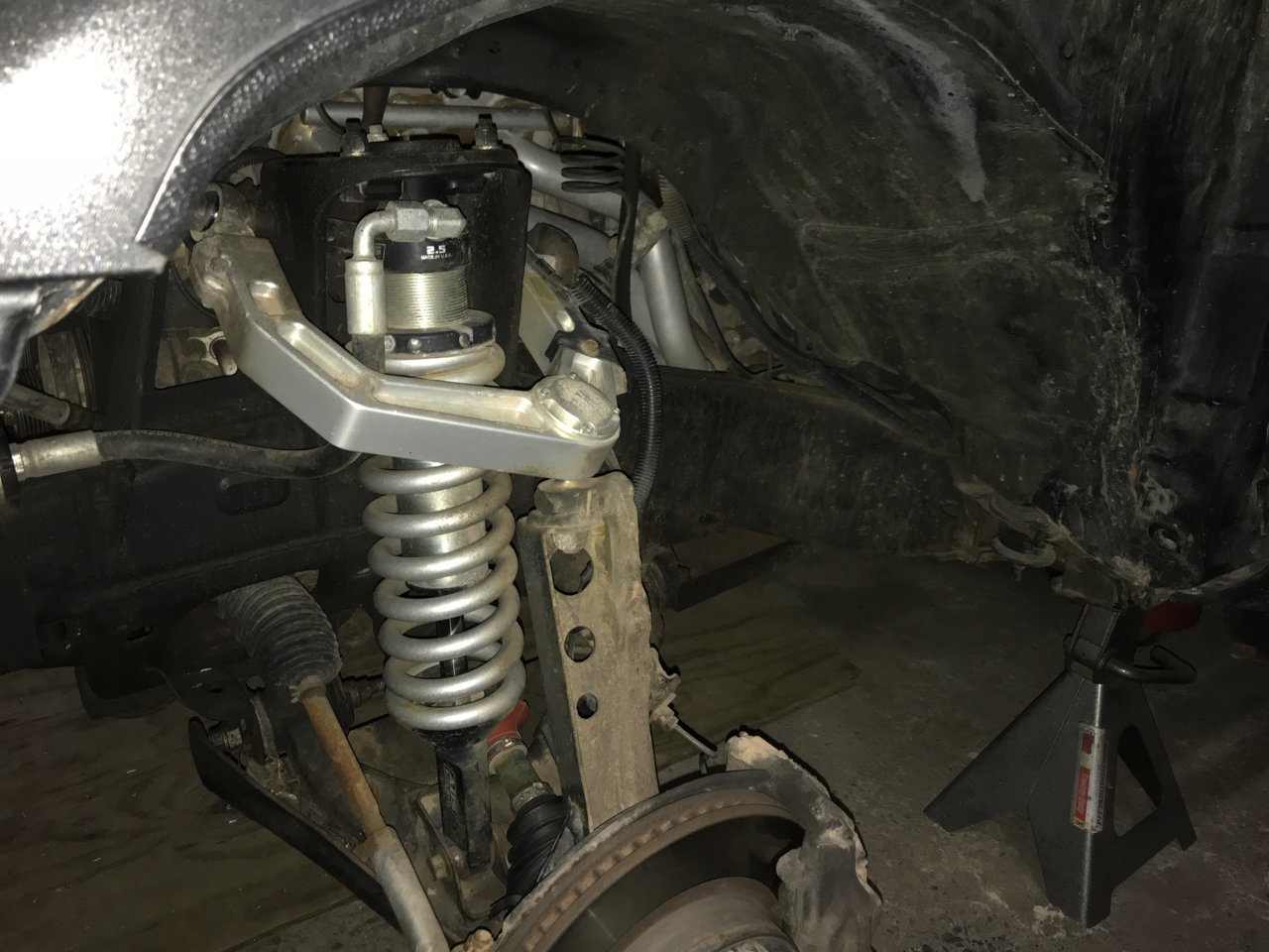

    KS

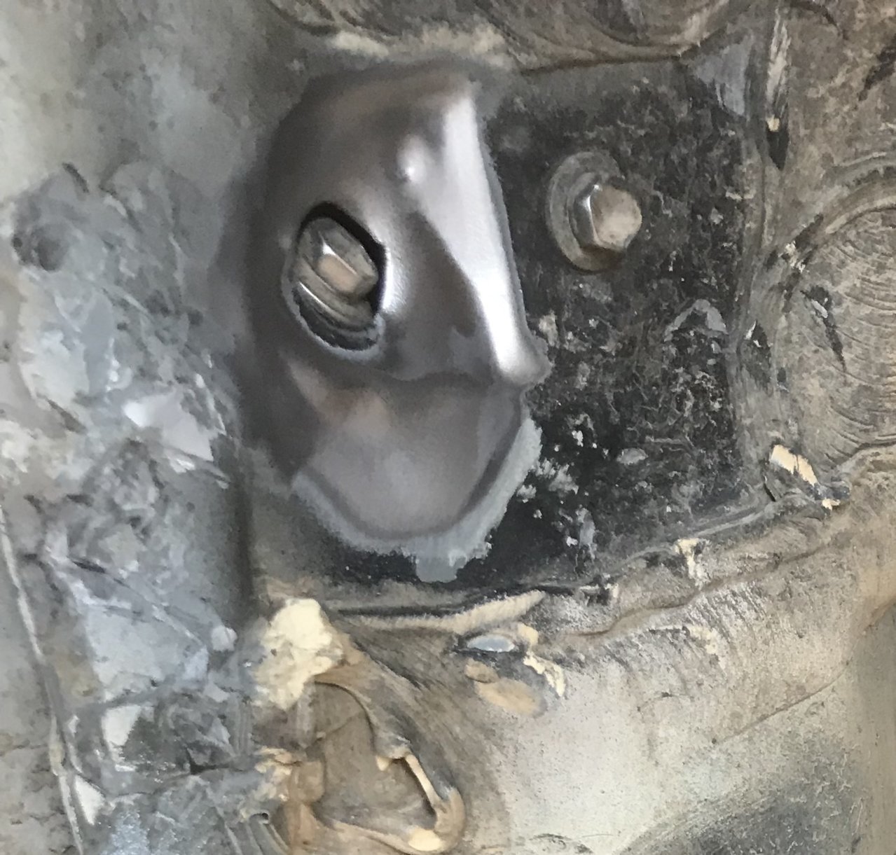

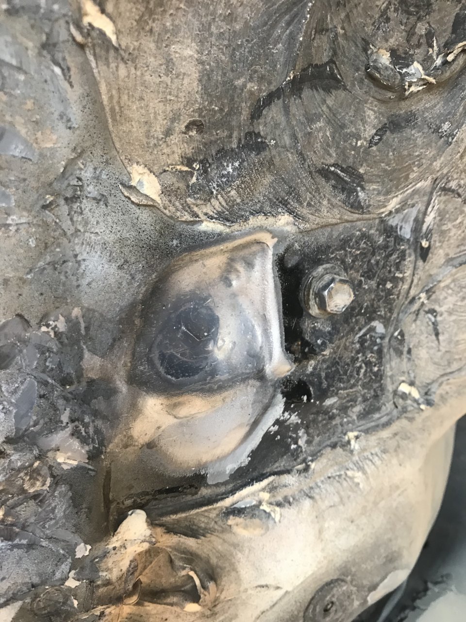

    i cracked my firewall and used silicone. did the flashlight test at night

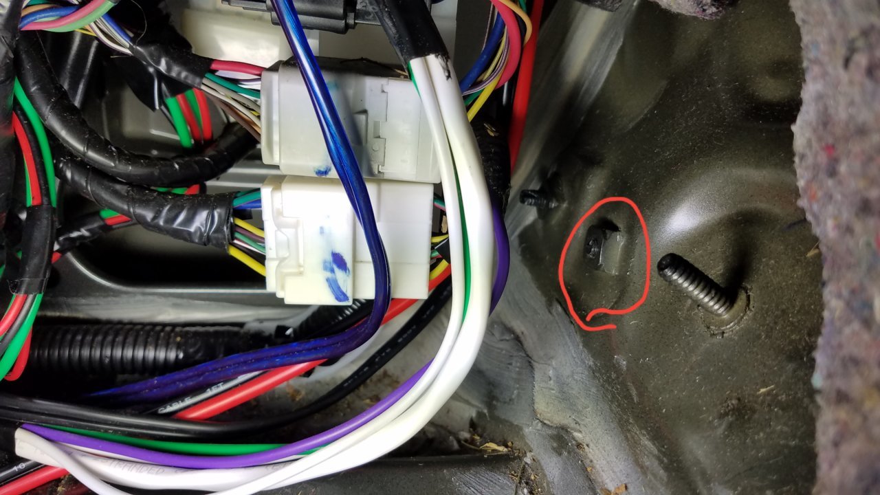

    Ok you punched this one. Those are threaded in the cab but go to nothing on my truck. They are to the left of the footrest block which mounts to that long bolt you see in pic. 20180327_213513.jpg
    I'm looking at a parts diagram online now. The lower bolt I have must have been for mud flaps. :woot:
    Edit. Nevermind you said passenger side.

    It’s holding up? I used a wire wheel to take it down to bare metal, and then silicone’d it. Wasn’t sure how well it would hold up though.

    Yeah I would silicone it. You'll probably burn right thru trying to weld it

    yup its held up fine for the past 2 years

    That’s good to know. I would have assumed the mud and rocks flung up would have messed it up, but I’ll just leave it be and keep an eye on it.

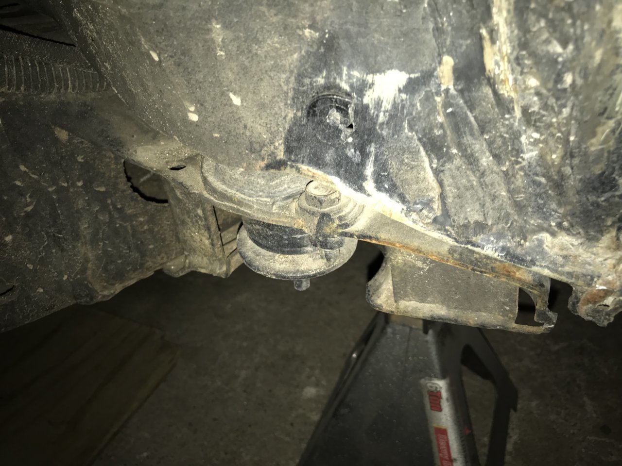

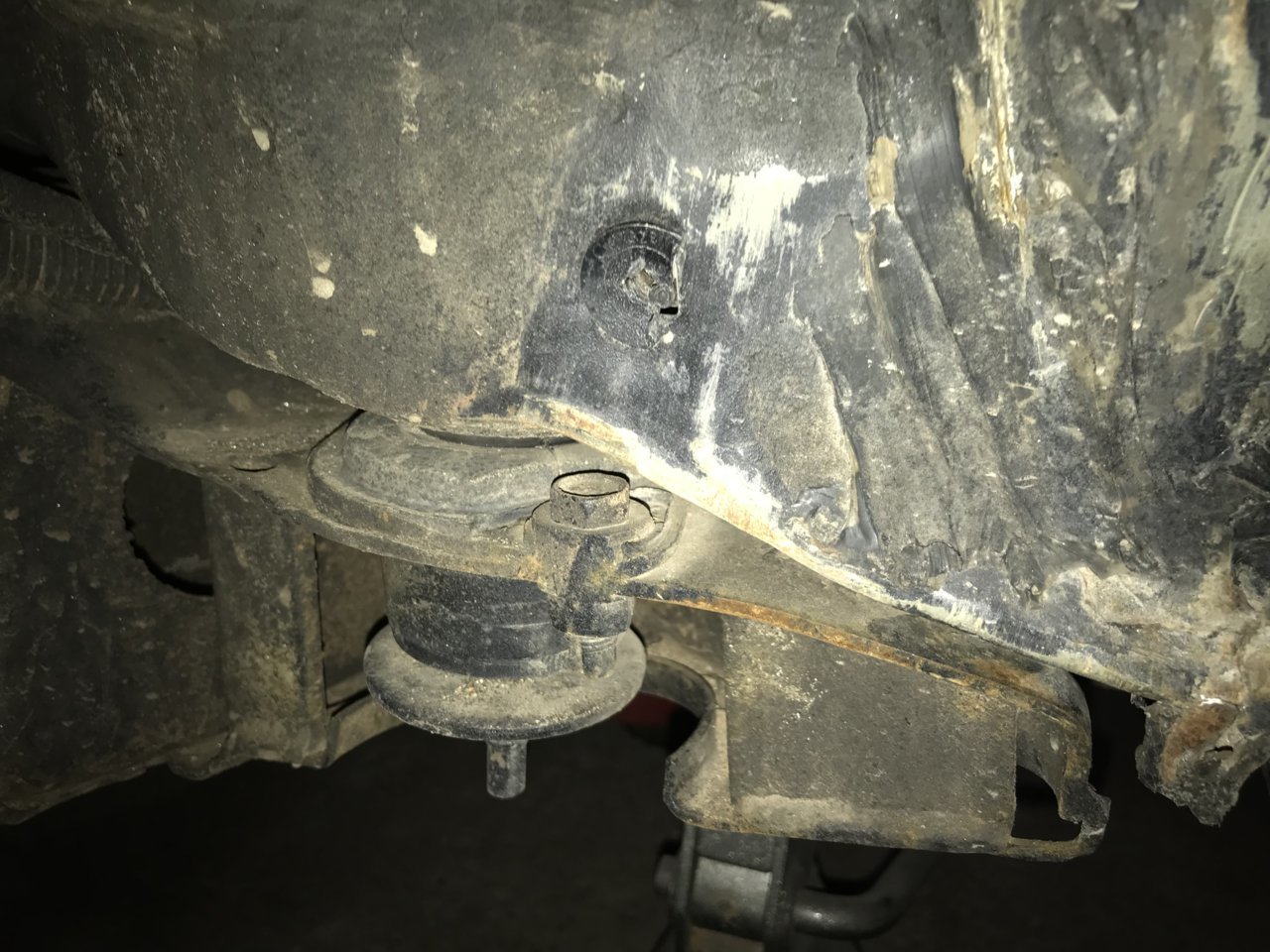

    Just realized this pic is dark and useless...
    As you can see, I cut and ground the cab mount back and into the washer. The firewall is beat back to match. Still rubbage.
    Rubs here too, and on the frame. I’m not cutting, grinding, or hammering anymore. It is what it is.
