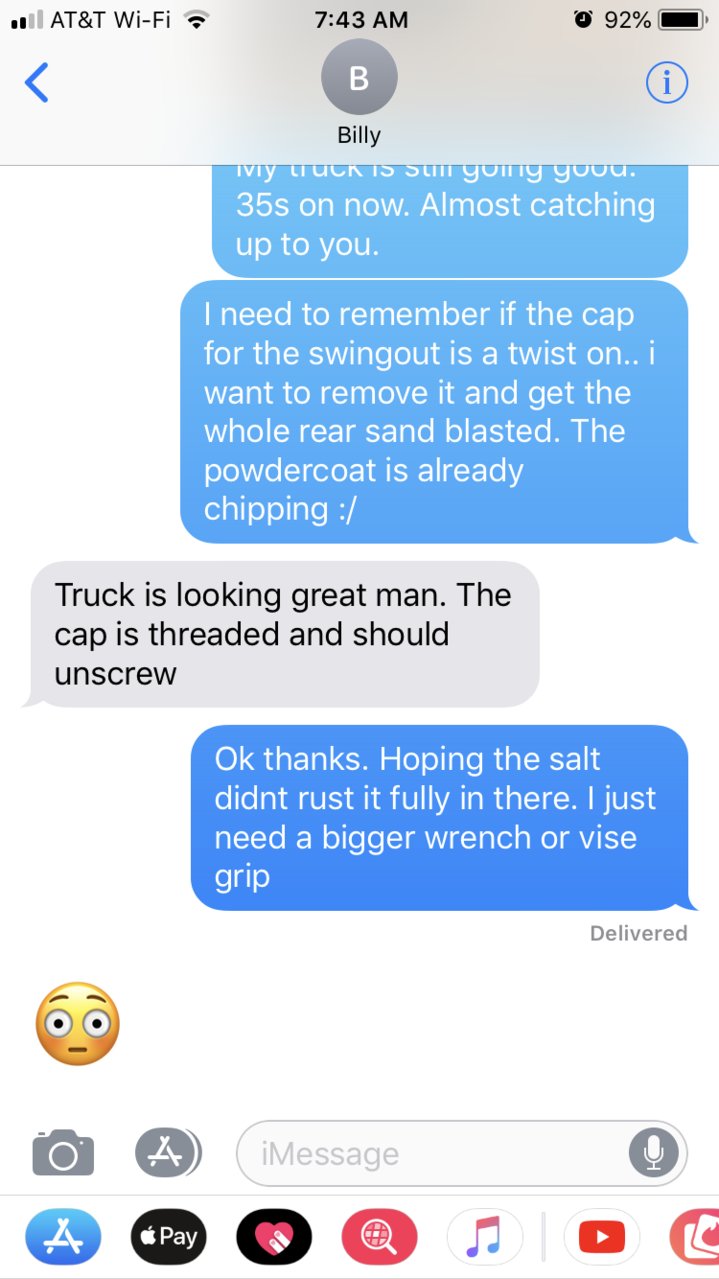

    I want to pull the cap to put anti seize on/get the swingout sandblasted so I can spray paint it.
    I was thinking about a rubber strap wrench, or a big vice grip and a couple swings with a sledge.

    Get a big nut TIG welded to the top. Go at it with a breaker bar.

    idk if youll get that pulled off. i guarantee its corroded as fuck because of the two metals. id say cut it..

    Serious question. What is he supposed to cut? If he cuts the top off, he’s left with corroded threads stuck inside with no where to apply leverage.

    My Pelfrey spindle cap is just a press in with a set screw

    I’d cut a small line, and use an air chisel to try and knock it free. The cut would just be something for it to grab onto.

    @fatfurious2 are you working today? You could come by and we could try and air chisel it free

    @PyritePirateBill tried this

    Just a couple times. Maybe we can do heat and air chisel again
