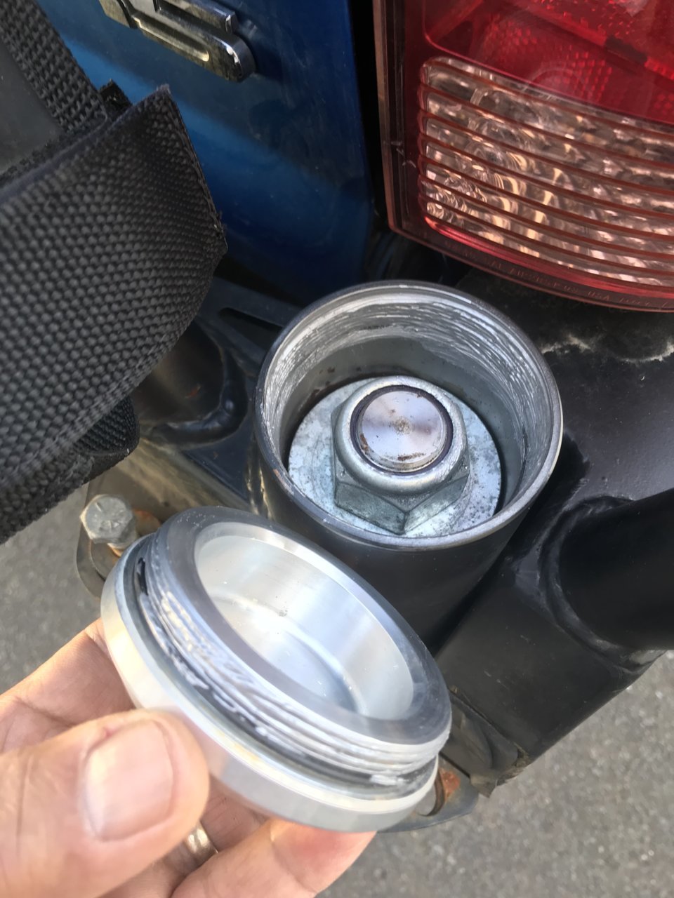

    Why spray paint it? I thought powdercoating is the best thing since sliced bread.

    Touch ups. PC is chipping now.
    I haven't tried anything else yet. Possibly Monday, as I have work this weekend

    Twisted mine off by hand, re-applied antiseize and screwed it back in by hand. About the same torque as a spin on oil filter.
    Yes. Rubber O-ring.

    thanks. Monday Im going to attempt @EatSleepTacos method of drilling 2 holes for bolts, and using some flat bar or a pry bar to unscrew. I bought that big bottle of anti-seize and I plan to put it to good use

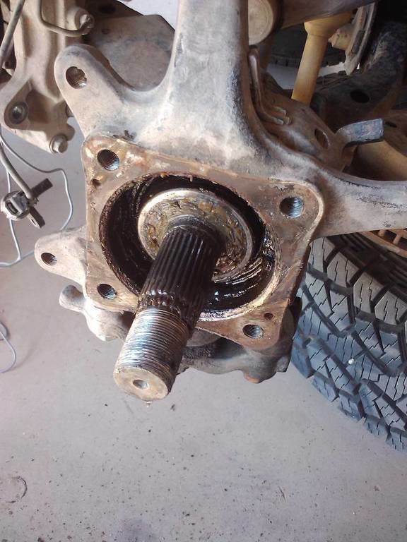

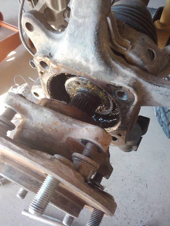

    I think spindle can be removed from hub, without taking axle nut off the axle?
    End goal: remove spindle

    Looking at these two pics, it looks like it would have to come off. The wheel bearing assembly is in the way.

    Shit ok. I hope i can get the axle nut on/off. The threads are messed up a little bit on the end of the axle

    fyi the axle nut holds the wheel bearing together. it will always have to come off to remove a spindle
