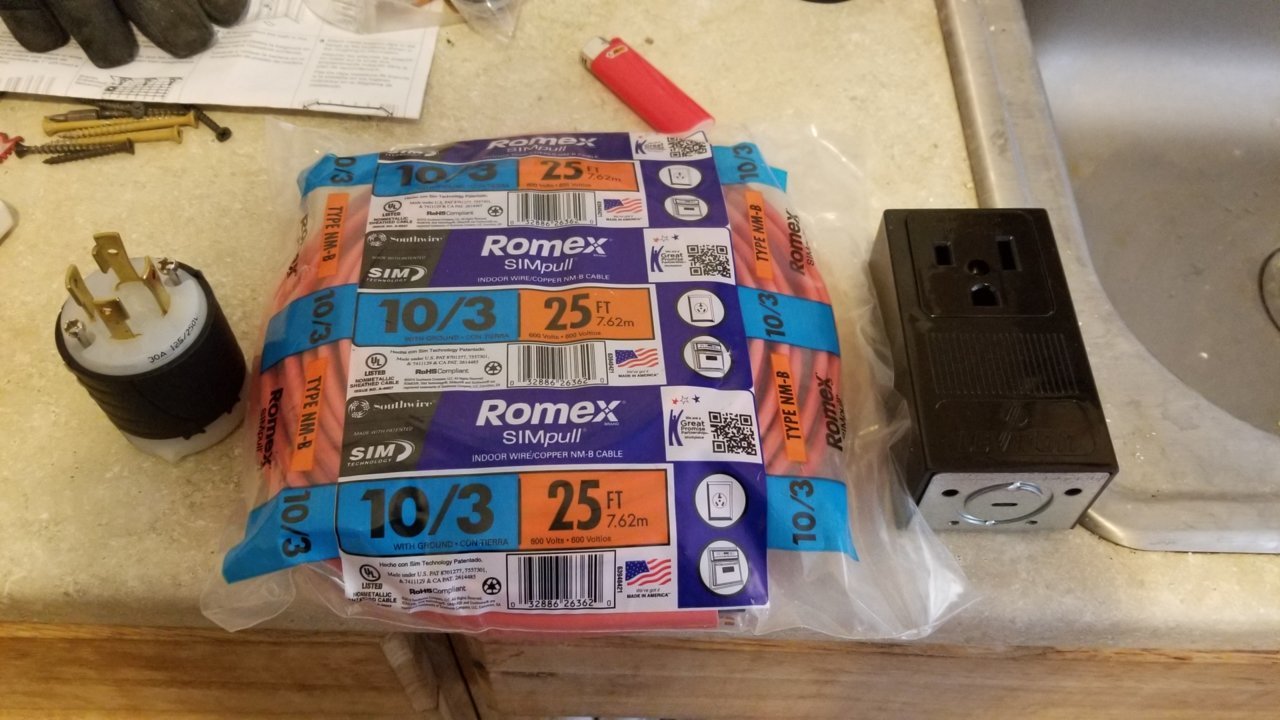

    Not sure it'll be less money, or even better. Those ends on the cords are great. Rubberized and water resistant.
    When we did my rear suspension, we needed a welder. The welder requires electricity. The only option was to use a generator. The female end of the adapter (part that the welder plugged into) was easy. Just match it to what the welder had.
    The male end would be plugged into the genny and therefore had to be matched to that. It was a 30amp twist lock style female end on the generator and I had to get the male version of it. All female and male receptacles have specific configurations depending on what they are rated for. See @Blackout14 picture for evidence of this. It shows the difference between a 15 amp rated and a 20 amp rated duplex receptacle. The male ends will be the same, just male.
    Now, the wire to connect the twist lock male end to the 50amp welder female end was determined by the load (the welder) If you look at the cut sheet for the welder, it should specify what it wants to run. Check out the peak amps it says it will use. For the welder we used, the peak amps was like 27A if I remember correctly. #10 is good for 30Amps, but we generally like to only use 80% of whatever something is rated at. That means the peak current of 27amps could be too much for the wire to handle, seeings how 80% of 30amps is 24amps. Being that the 27Amps peak current draw was only for the initial spike in current, I felt ok using the #10.
    The other thing when it came to the adapter was that the generator had a 4 prong (2 hot legs, a neutral, and a ground) but the welder only had a 3 prong plug, 2 hots and a ground. I used 10/3, which is 4 conductors.... red and black are the hot legs, white is the neutral, and the bare copper wire is the ground. I kept the ground and neutral separate at the generator, but combined them at the welder. I'm not 100% on if any of that matters really, but I know for residential electricity, all neutrals and grounds will come together at the main panel anyway.
    I know I didn't link anything, but I feel as though armed with this bit a knowledge you can figure it out easily. I'm always here for questions.

    Heres the adapter I made for the generator to welder.

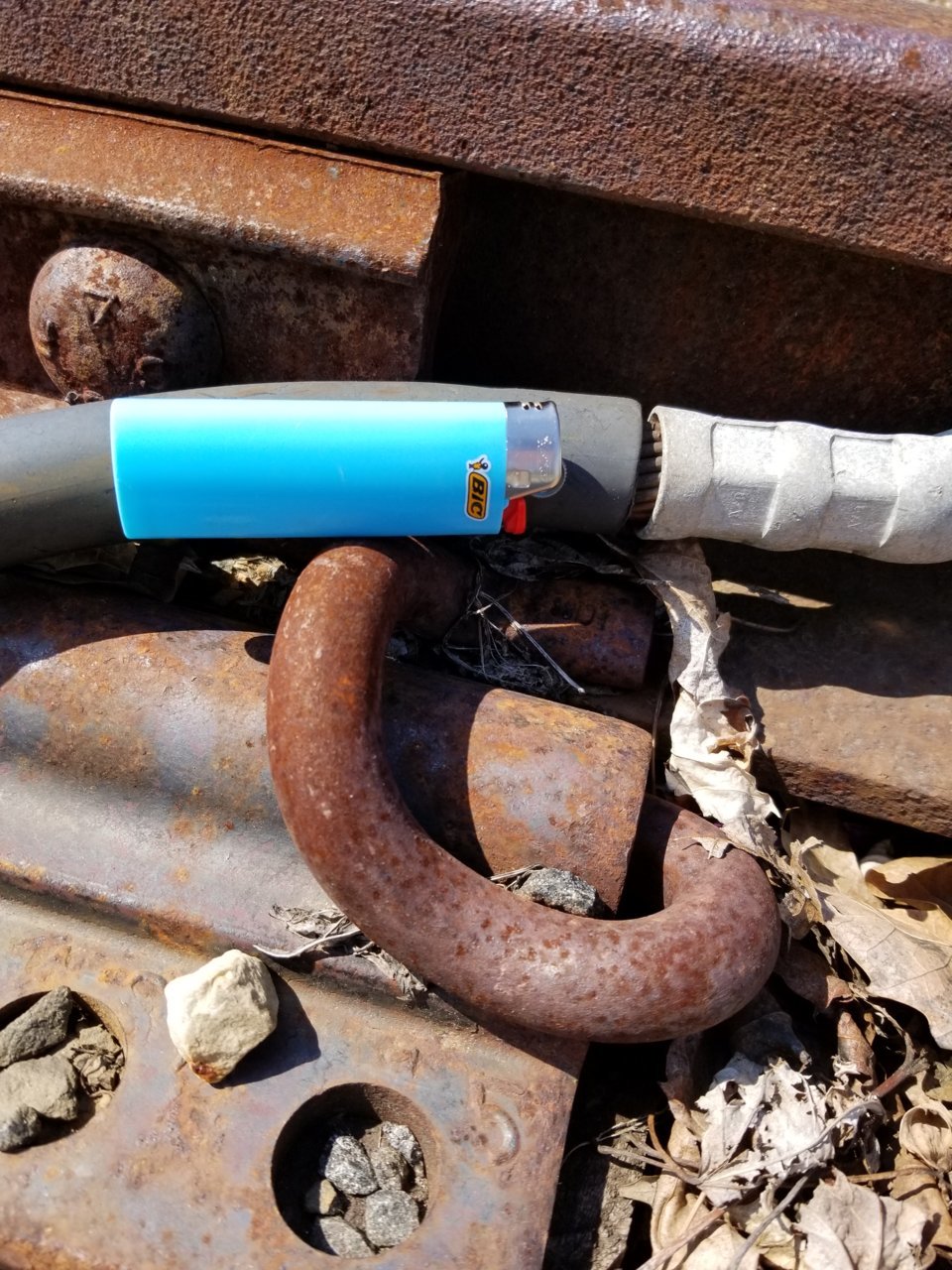

    This is one of the bonds we make that we have on the train tracks for the return of 600v DC. Its 500mcm size.
