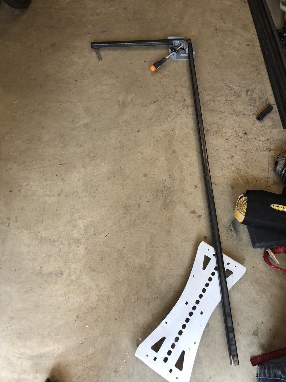

    I would prefer the clamp like David has over the magnets. Welding a perfect 90° without having everything clamped down is hard (from what I’ve researched) due to the welding heating and cooling the metal, making it pull inwards. That clamp would keep it at a perfect right angle until it cools off, and I wouldnt think a magnet would be strong enough to achieve that.

    Jody has a good video on weld sequencing on Welding Tips and Tricks.com also. Once you know the reasons for warpage, you can think through sequencing almost any welding project

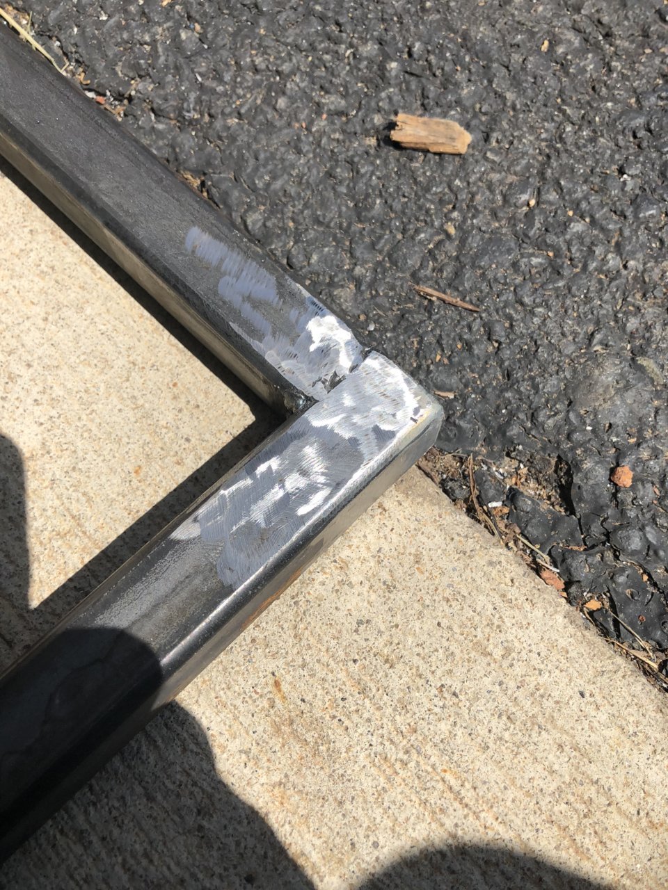

    why didn't you mitre that corner?
    edit: is that plastic?

    I suggested that to him via text and he said he's gonna do that from now on. Then no need to make a cap for the open end of the tubing.

    No not yet. Been broke. As always. I cut these with the cut off wheel.
