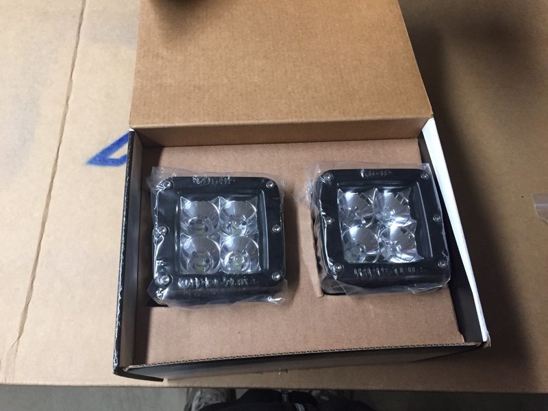

    Added these guys tonight. Wow! Night and day difference! And I'm using my factory fog light button. It was a plug and play installation. They are rated at 1532 lumens each.
    Used this adapter to go from H10 to Deutsch

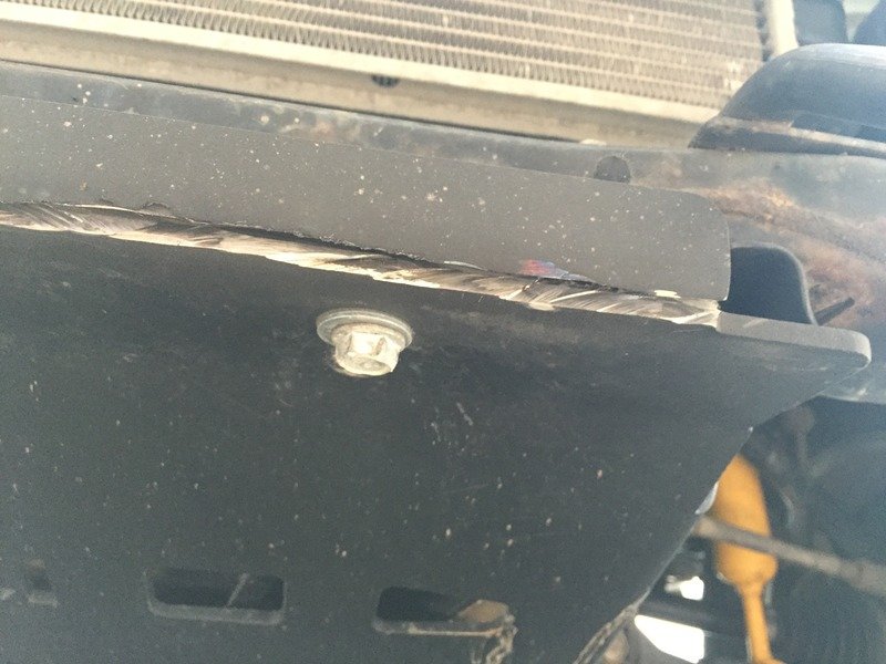

    Wanted to make a note.. If you have the RCI front skid, you will have to cut the lip off like this, to fit the Pelfreybilt front bumper.

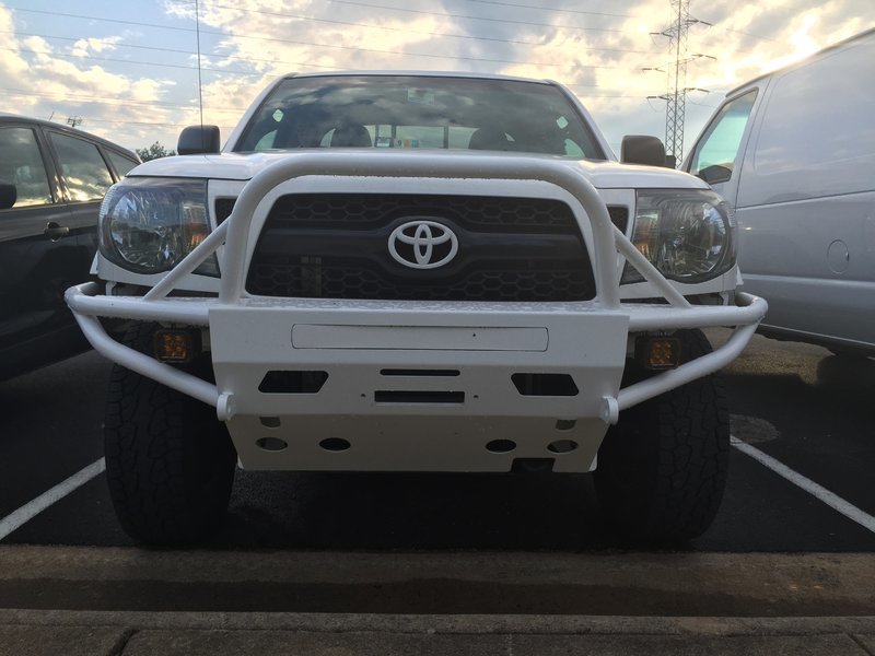

  4. May 3, 2016 at 3:56 PM
    #24
    fatfurious2
    fatfurious2 [OP] IG: great_white_taco
    Jun 28, 2014
    #132884
    49,822
    David
    Ashburn, VA
    2010 TRD OR Access Cab
  5. May 4, 2016 at 7:35 AM
    #25
    TheTacoma
    TheTacoma Well-Known Member
    Oct 11, 2015
    #166371
    5,479
    Birmingham, AL
    2017 DCSB, TRD OR 4x4, Quicksand. SOS Bolt-on Sliders. 285x75r16. Kings

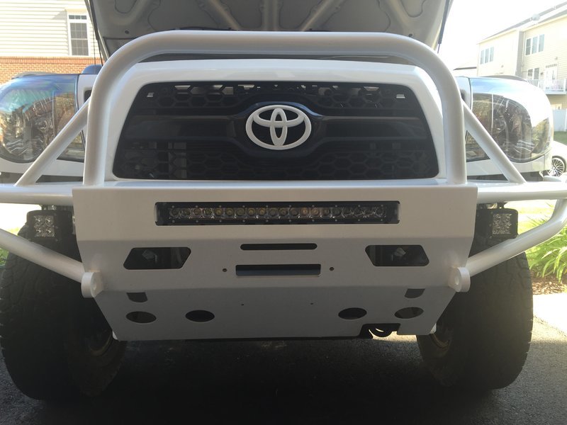

    Looks bad ass! I am thinking about going this directions rather than a full plate bumper. Any reason you chose the hybrid over the full plate?
    ChadsPride likes this.
  6. May 4, 2016 at 12:17 PM
    #26
    fatfurious2
    Jun 28, 2014
    #132884
    49,822
    David
    Ashburn, VA
    I loved the look of these. I feel like they do the same job as a full plate bumper, and save a bit of weight.
    Tatts521 and ChadsPride like this.
  7. May 4, 2016 at 12:22 PM
    #27
    TheTacoma
    Oct 11, 2015
    #166371
    5,479
    Birmingham, AL
    I see you have ome 885 coils, I have the same on the way, did you lose any lift after installing the bumper?
  8. May 4, 2016 at 1:17 PM
    #28
    fatfurious2
    Jun 28, 2014
    #132884
    49,822
    David
    Ashburn, VA

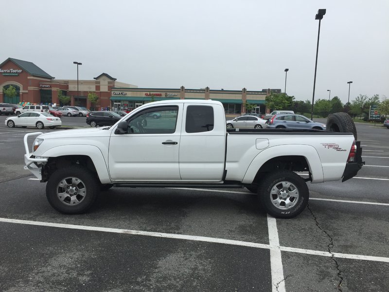

    I didnt do before and after measurements, but @DCSBFTMFW says its supposed to look this way.. I think it looks higher in the rear
    ChadsPride and DustStorm4x4 like this.
  9. May 4, 2016 at 1:24 PM
    #29
    TheTacoma
    Oct 11, 2015
    #166371
    5,479
    Birmingham, AL
    :drool::drool::drool: Yea, I think dakars give a little rake to start with.
  10. May 4, 2016 at 1:40 PM
    #30
    T4RFTMFW
    T4RFTMFW Well-Known Member
    Jul 23, 2014
    #134525
    69,757
    Meaning you have insufficient coils for the way your truck is setup if you wanted to be level front and rear.
    It's not supposed to look that way, or maybe it is. I think you think it should be level with 885s and I think the result with the 885s is what anyone should expect with a plate bumper up front.
    I would try 886s or I'd get some top plate spacers of you want to add height up front with that load. Or roll the dice on some 887s, which are taller than your 885s but have the same coil rate, where the 886 is the same as your 885, just stiffer.
    doig, Kyitty, ChadsPride and 2 others like this.
