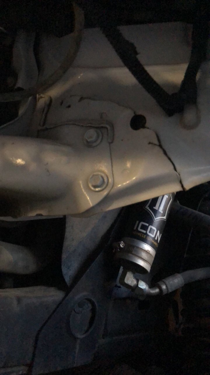

    Well shit. Going to have to attempt to patch this at aome point

    Dang, that's gotten a lot worse

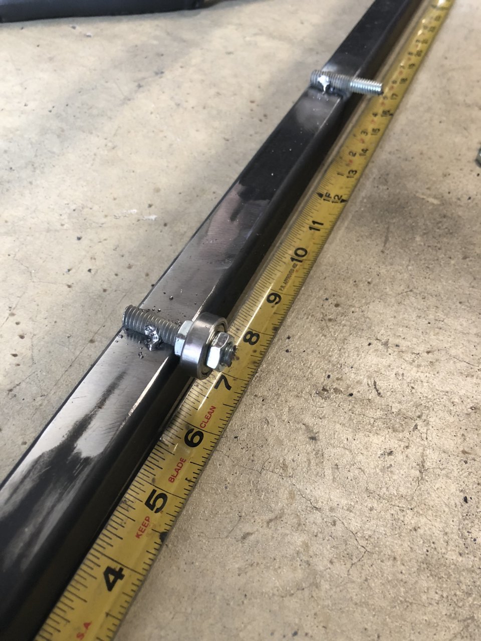

    You need a band saw or similar to do miter joints, the cutoff wheel is to thick. It also takes a steady hand to conrolcthr blade on both sides of the cut.
  5. Jun 7, 2018 at 5:36 AM
    #4025
    fatfurious2
    fatfurious2 [OP] IG: great_white_taco
    Jun 28, 2014
    #132884
    49,824
    David
    Ashburn, VA
    2010 TRD OR Access Cab
    no one told me that I also needed to factor in adding an inch, so I was off. I like the butt welds anyways.

    Yeah, you have to do all the math by the outside measurements.
    Then transfer those '''center lines" to the inside, measure the cut width to make a triangle and cut it out.
    Remind me tonight and I'll sketch it for you.

    I think we were talking about this. But its the radiator support in front of the driver front wheel. Basically under the battery

    I have seen where this has happened to a few people right under the battery. Not sure how they fixed it.

    Okay, that's what I thought.
    We can rivet and weld a plate on it. You also need to get the damned battery off the fender.

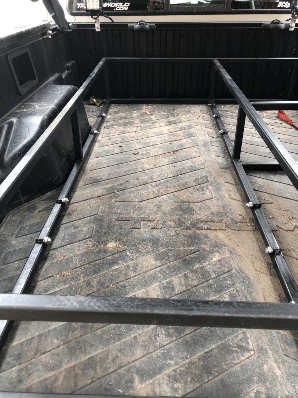

    Build progressing slowly
