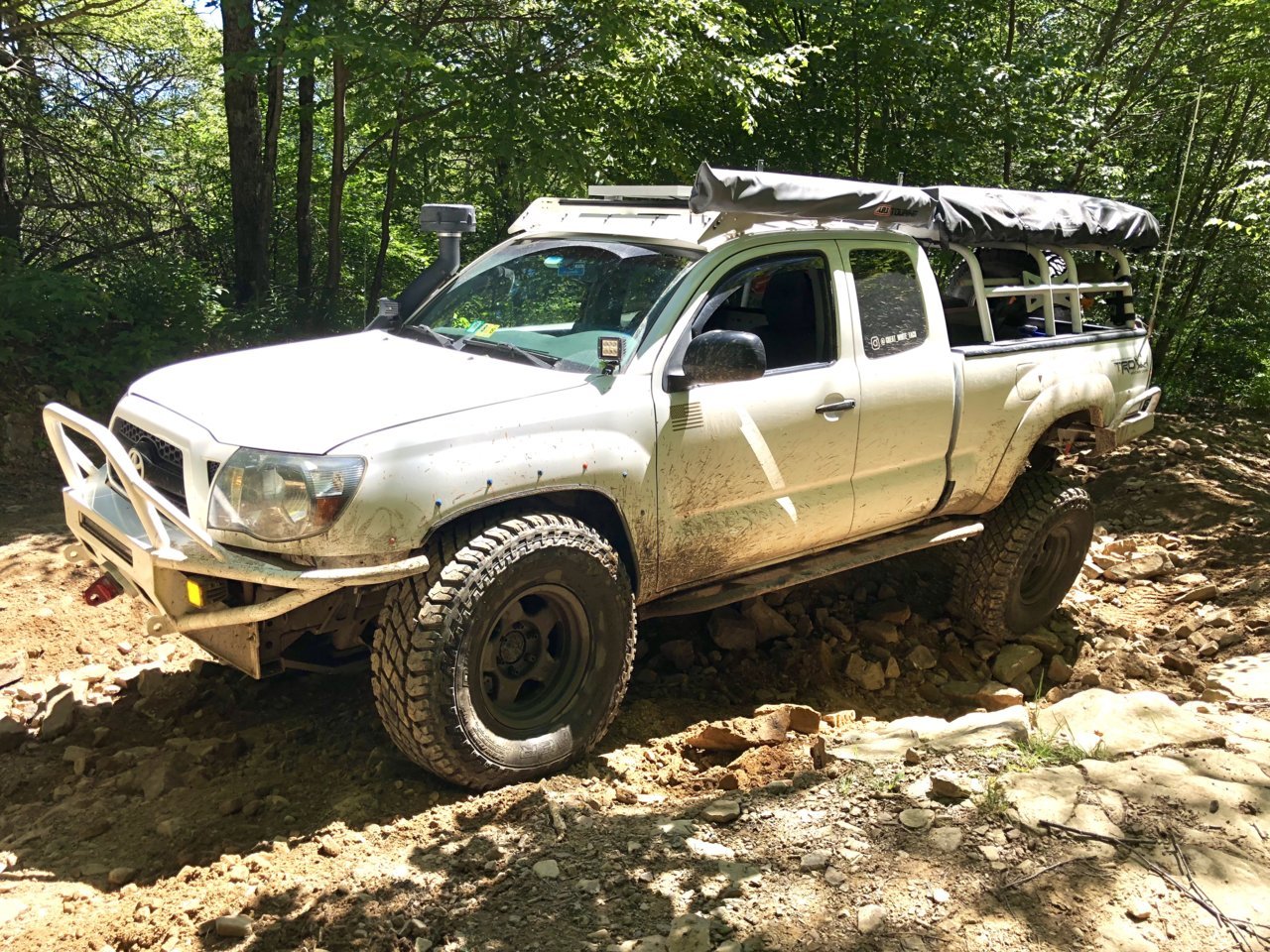

    Here’s mine at about half droop

    Coil spring problems always looks like you got a load

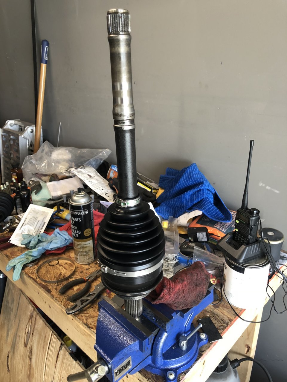

    Pelfreybilt Front Bumper,BAMF sliders, Airflow Snorkel,Mini D2S Retrofits, ADS Rear Shocks, Deaver U402 Leafsprings, 35s, AllPro +2LT

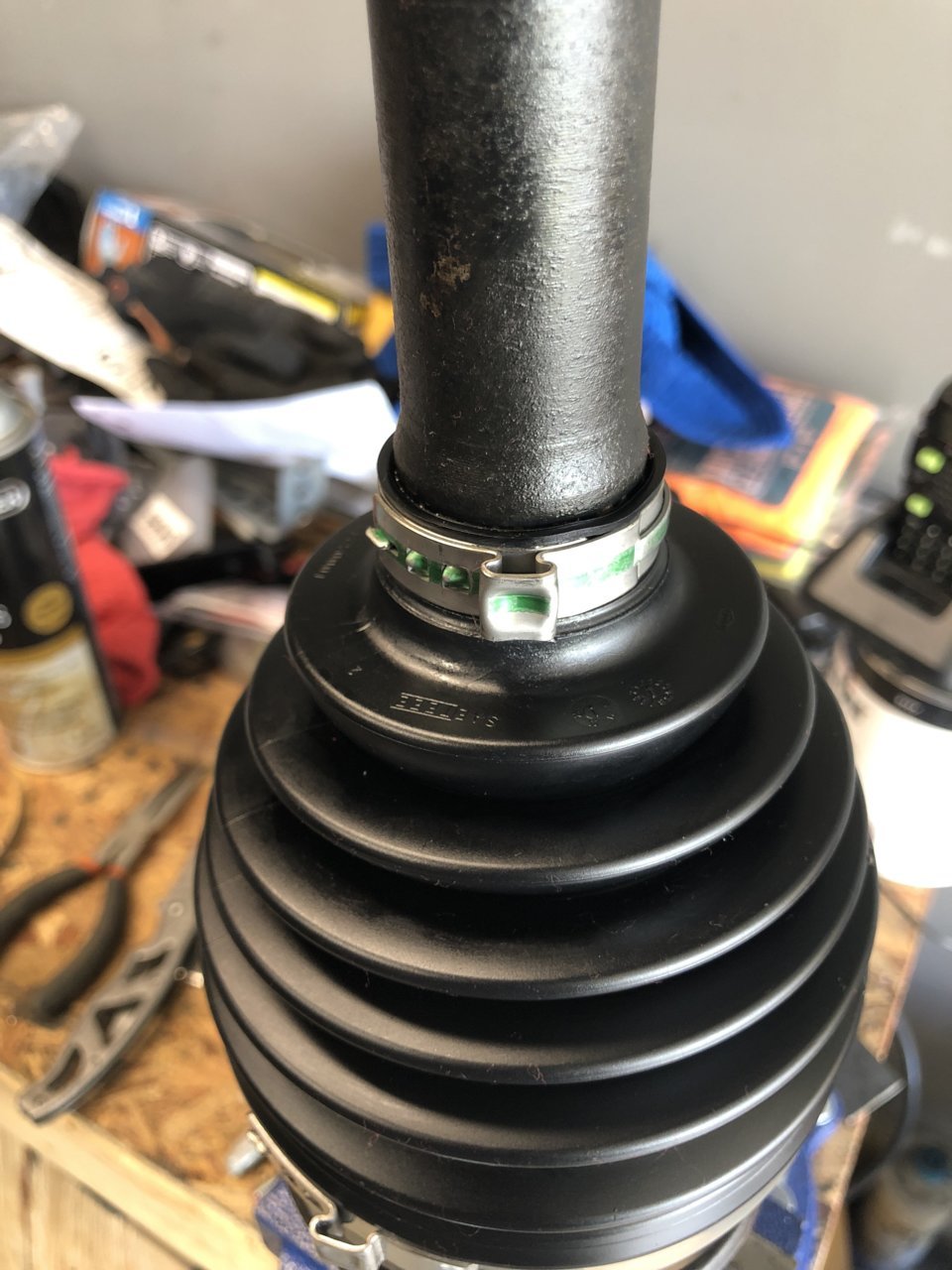

    so was it difficult to do the outer boot? just disassemble the inner and slide it on that way? i have a tear in my outer now...
    MarX likes this.
  4. Jul 8, 2018 at 10:32 AM
    #4324
    EatSleepTacos
    Mar 24, 2015
    #151688
    59,838
    Randy
    West Valley, AZ
    2017 4Runner
    Yup, that’s the easiest way to do it.

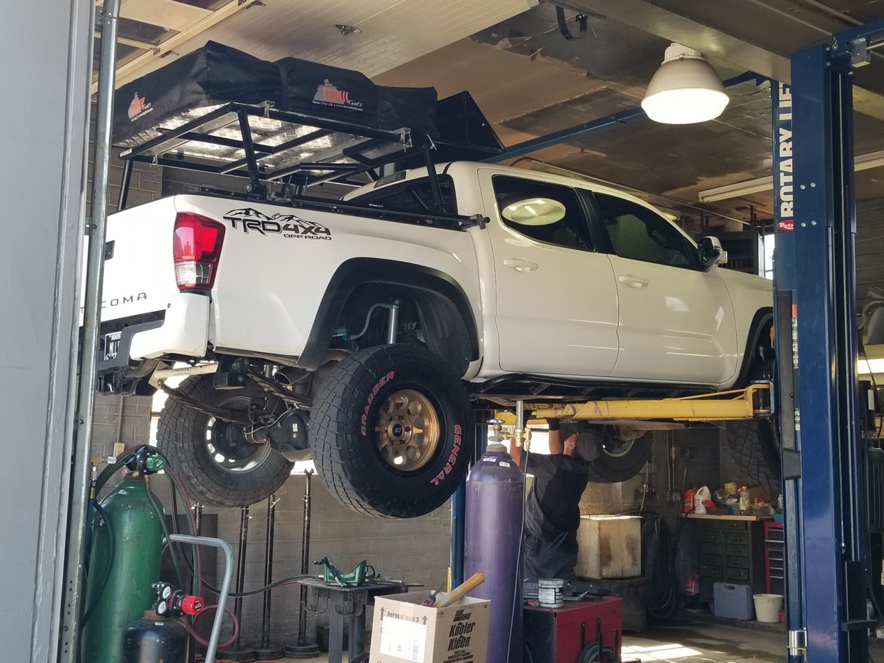

    Mostly stock

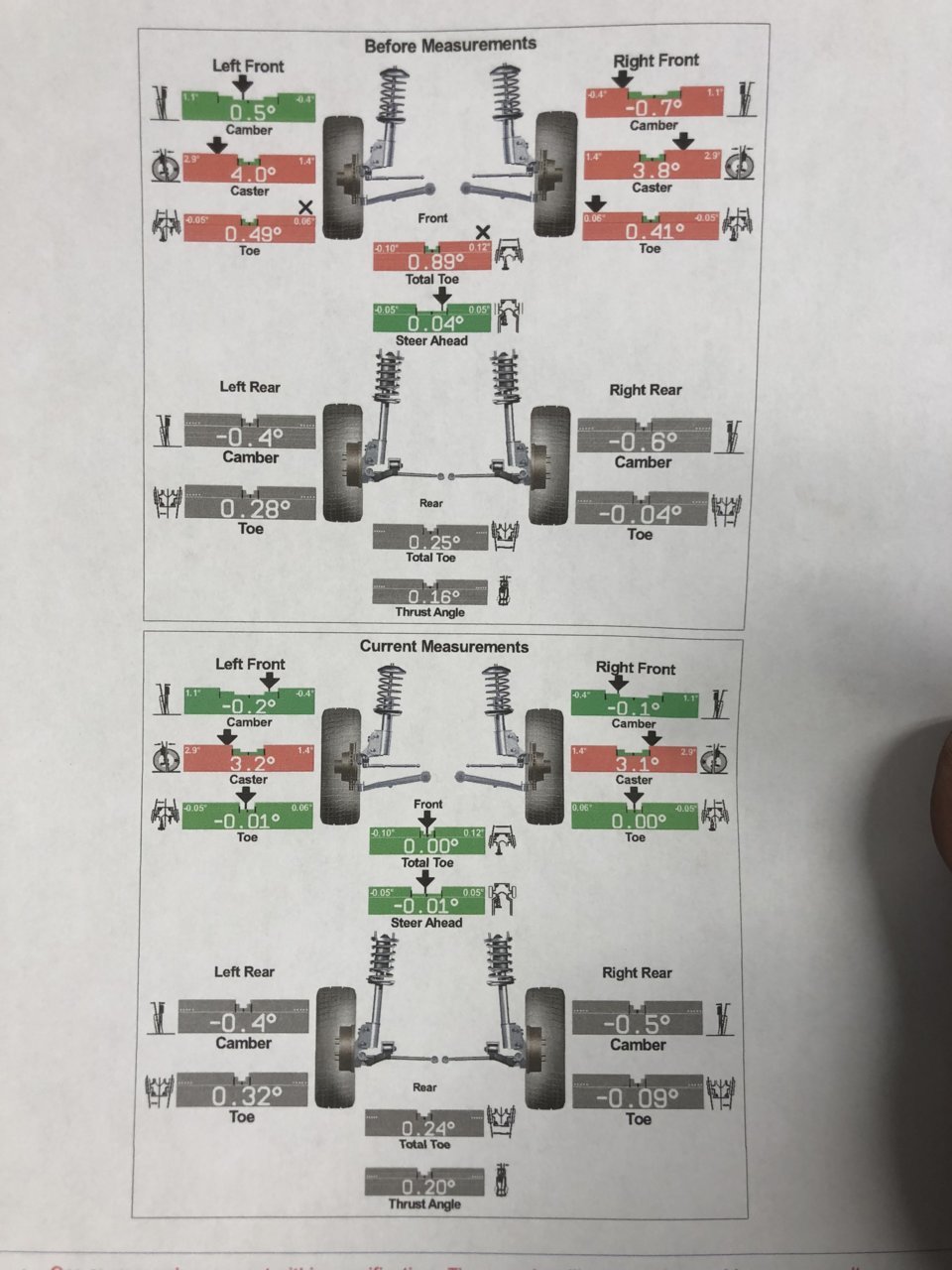

    I need to visit your alignment guy!

    He’s awesome. It’s a random tire shop near me that I decided to try and the guy let me hang out there with him while he did the work.
