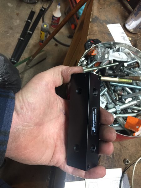

  4. Dec 6, 2016 at 6:43 PM

  5. Dec 6, 2016 at 6:44 PM
    #485
    stairgod
    stairgod NOOB
    Aug 16, 2015
    #161924
    7,965
    Jo n
    PA/NJ
    2011 MGM Trail Limo
    Locked Boosted 35s
    Or just use the 4 port and plug one hole for future use with a front locker.

  6. Dec 6, 2016 at 6:45 PM
    #486
    fatfurious2
    fatfurious2 [OP] IG: great_white_taco
    Jun 28, 2014
    #132884
    49,845
    David
    Ashburn, VA
    2010 TRD OR Access Cab
    one, in addition to the one that comes with the tire inflation kit. Which is why I had a 4 port. In this video, the guy uses all 3, on the included Tee. Around 4:05

  8. Dec 6, 2016 at 6:50 PM
    #488
    stairgod
    stairgod NOOB
    Aug 16, 2015
    #161924
    7,965
    Jo n
    PA/NJ
    2011 MGM Trail Limo
    Locked Boosted 35s
    Exactly. The twin has its own pressure switch. So you can eliminate the 4 port entirely.

  9. Dec 6, 2016 at 6:50 PM
    #489
    fatfurious2
    Jun 28, 2014
    #132884
    49,845
    David
    Ashburn, VA
    the pressure switch that comes with the compressor.
    So the one referenced in the video, is not included in the twin compressor? And therefore, I dont need a 4 port connector? A 3 port would do just fine?

  11. Dec 6, 2016 at 7:25 PM
    #491
    stairgod
    stairgod NOOB
    Aug 16, 2015
    #161924
    7,965
    Jo n
    PA/NJ
    2011 MGM Trail Limo
    Locked Boosted 35s
    ChadsPride likes this.
  12. Dec 6, 2016 at 7:28 PM
    #492
    HolyHandGrenade
    HolyHandGrenade NOOB
    Mar 25, 2013
    #100579
    11,801
    Tim
    Garage Most Likely
    DCFB (RIP)
    Some Stuff
    I believe that's what the guy at ARB said when I called the other day. They're not 1/4" that's for sure. Whatever size they are, that manifold is advertised to be correct for them.

  14. Dec 6, 2016 at 7:43 PM
    #494
    HolyHandGrenade
    Mar 25, 2013
    #100579
    11,801
    Tim
    Garage Most Likely
    DCFB (RIP)
    Some Stuff
    If you're planning to add lockers one day, I'd just buy this now. Plug the holes for now. Then you're ready to go when the time comes :thumbsup:
